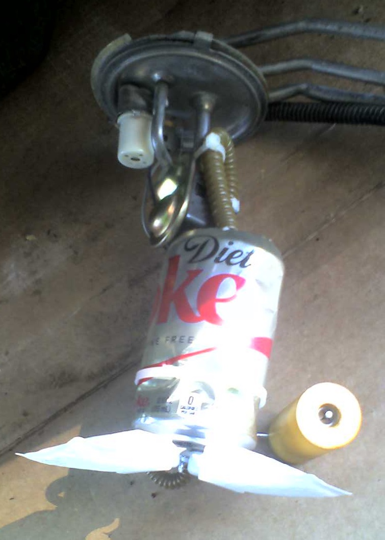

So, the car has been sitting (again) for a while. A few weeks ago, I pulled a pump from a newer Deville with the H.O. 4.6 Northstar. Higher operating pressure than the Berettas use (in the 50-60 range), and certainly able to power a bigger engine than mine, I don't think I will be over-taxing this thing. Oddly enough, this pump has two smaller inlet ports instead of the single big one. The '90 Berettas also do not use a bucket, so I had to make some modifications. I bought two small filters used for the Chrysler Sebring that fit beautifully, and cut-up a Coke can to make a bucket (of sorts) to keep the pump cool. I routed the return fuel line into the can to keep the supply of cool fuel fresh for the pump. It looks awful, but seems to work fine. The car runs good with it, 47 psi KOEO, 43 psi idle, 45 psi with some throttle put in. I still have to test drive it -the Indy project car is currently blocking it in- but the prognosis is good. And I am getting darn good at pulling that tank!
Diet, Caffeine Free Coke? Sure, for a more calming tire-burning turbo-boosting fuel-injecting experience!  Gasoline was the best thing ever put into this can! It may look bad, but it is actually pretty sturdy.
