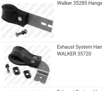

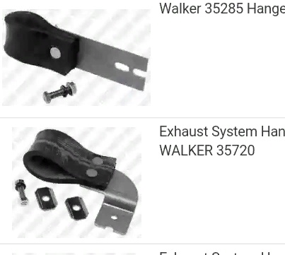

I see these hangers.. Do they just hook in rods that are supposed to be there??
Re: 93 Beretta missing stuff
No brackets are really used. It's a rubber ring attached to a steel hanger then the exhaust has a metal rod welded in place and bent to hook to the rubber.. Most places weld new steel hangers to better choice metal if the factory spot is deteriorated where it was affixed on the chassis.
