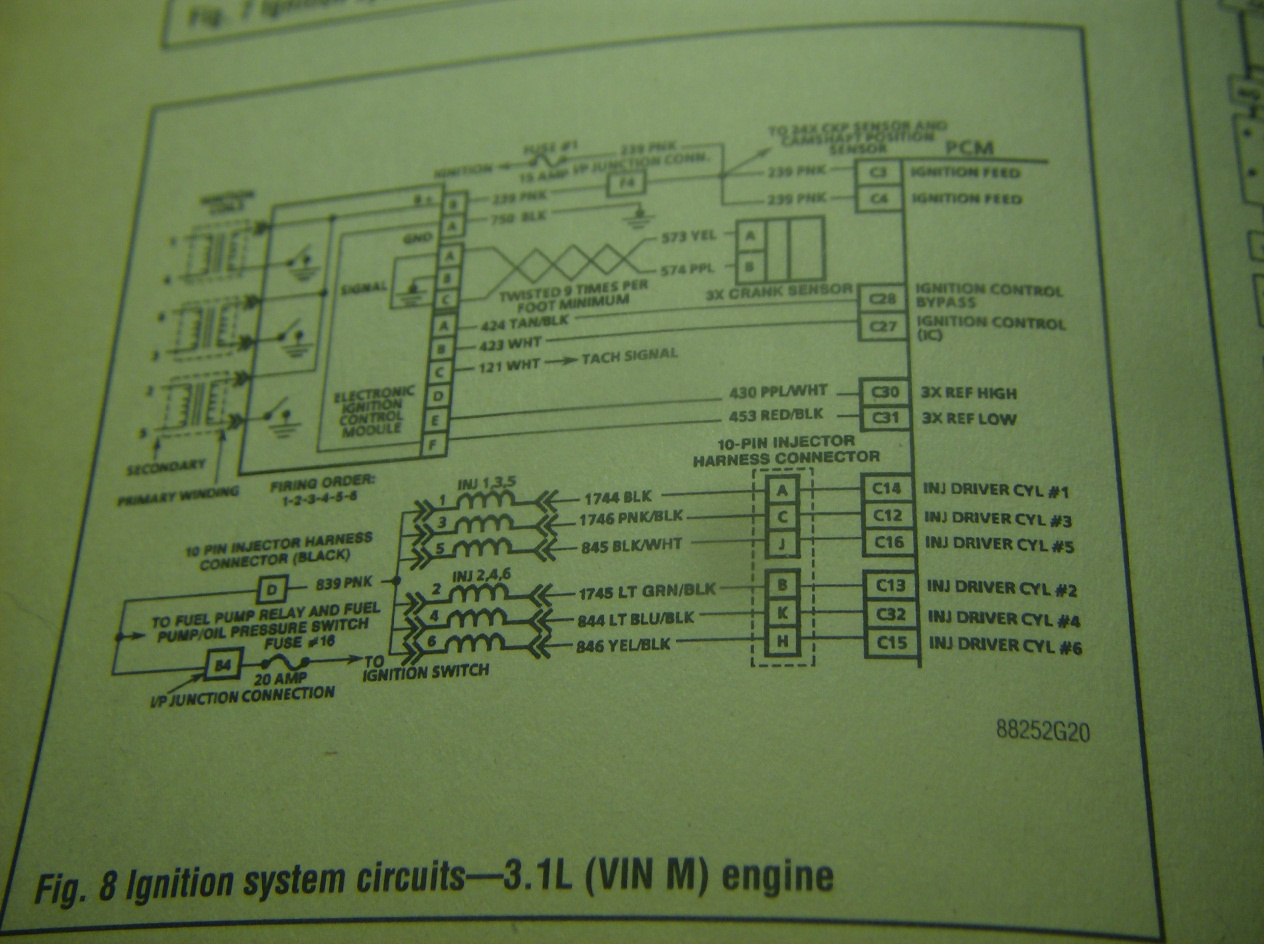

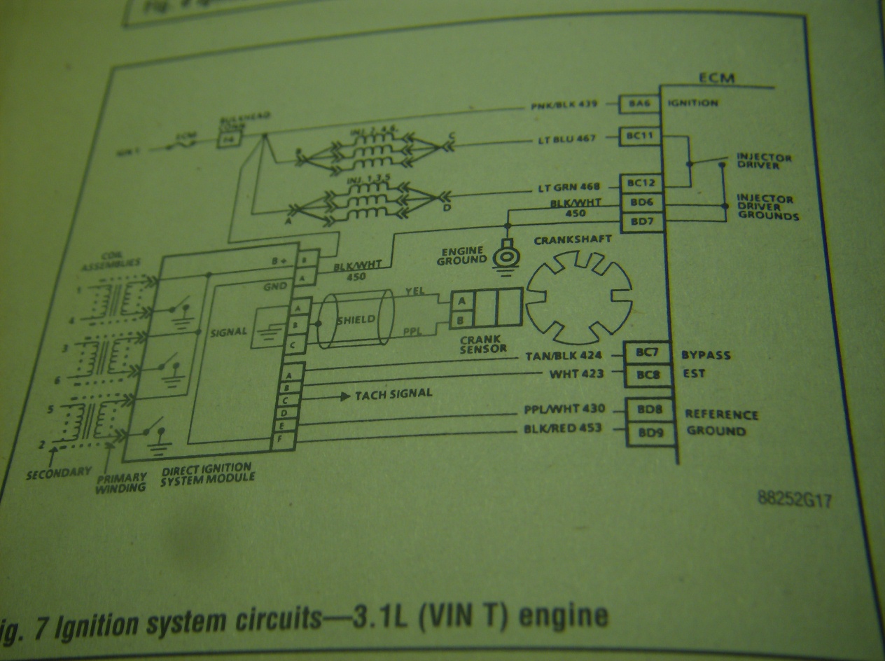

This are from the 88-96 Beretta Chilton manual. Maybe this will help.

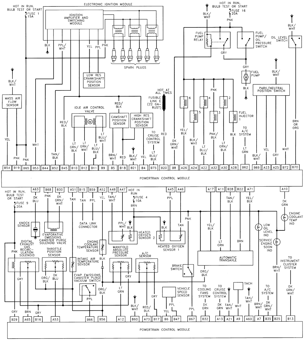

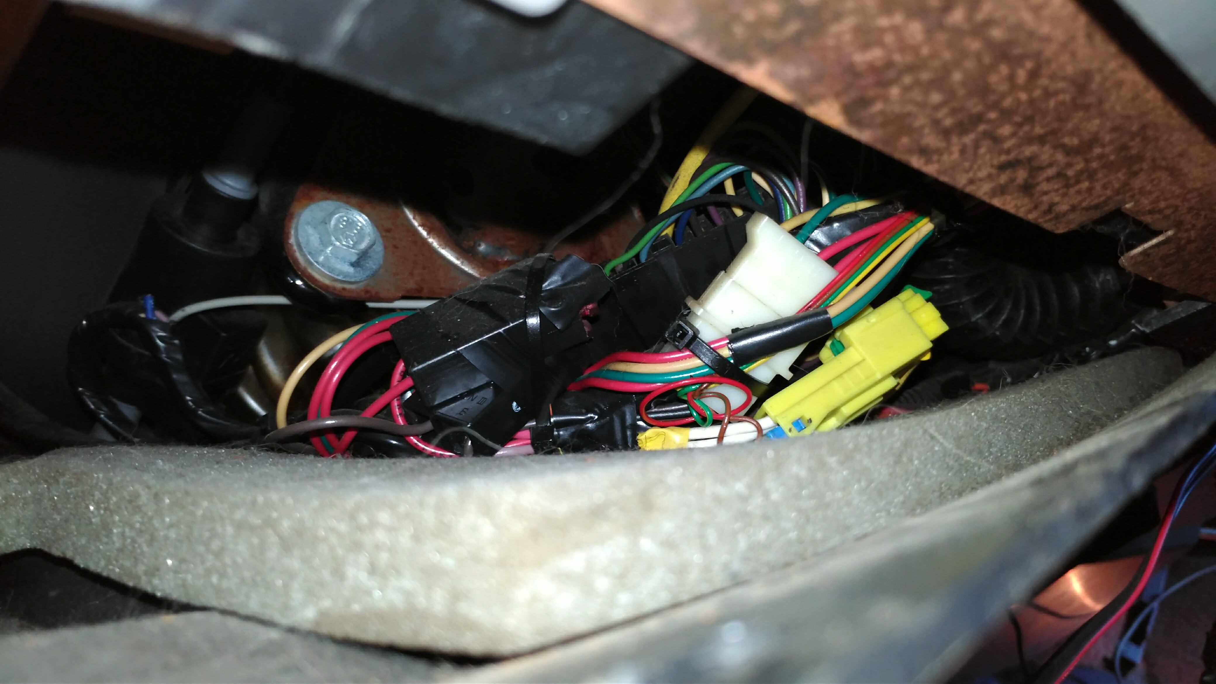

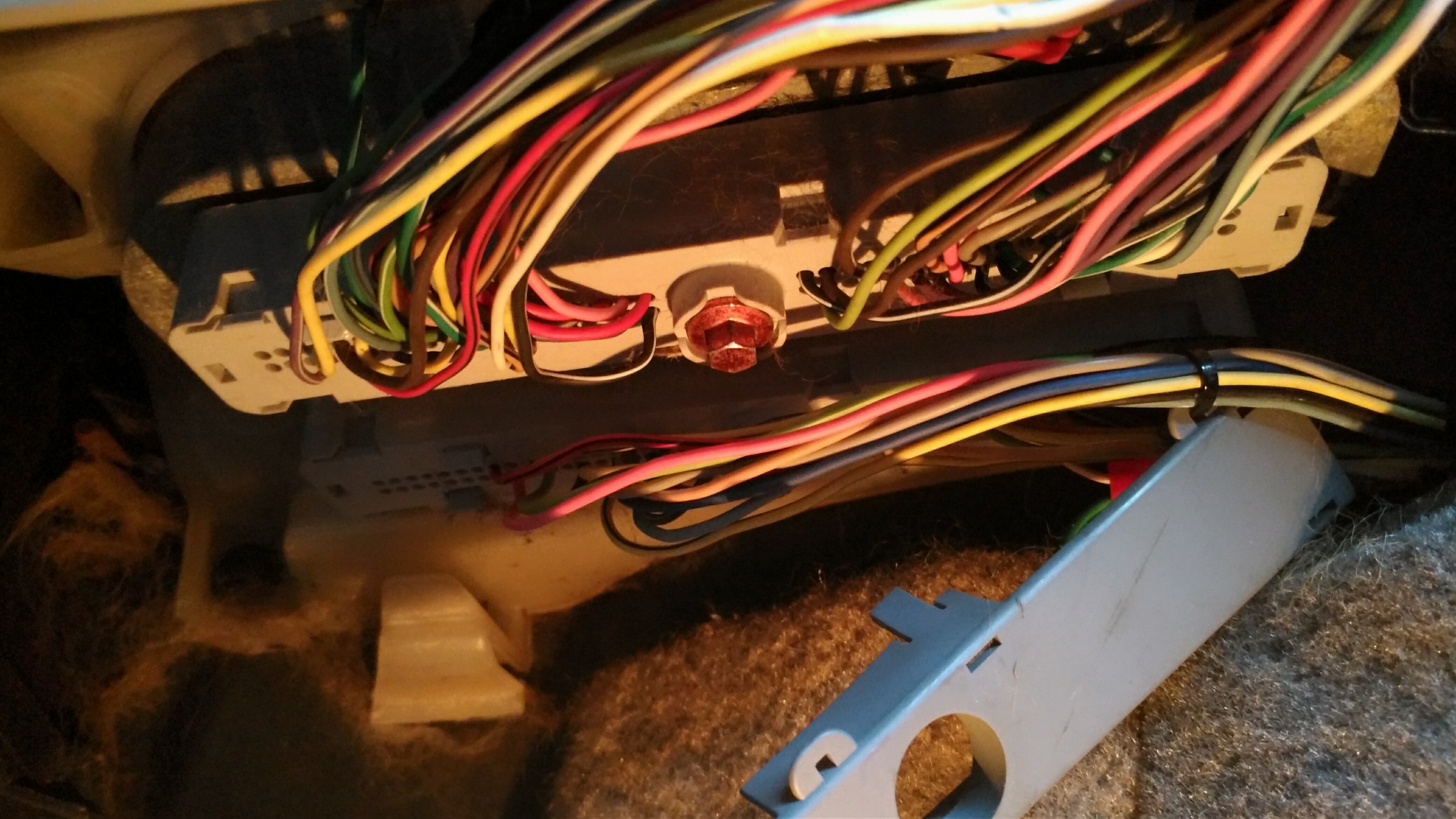

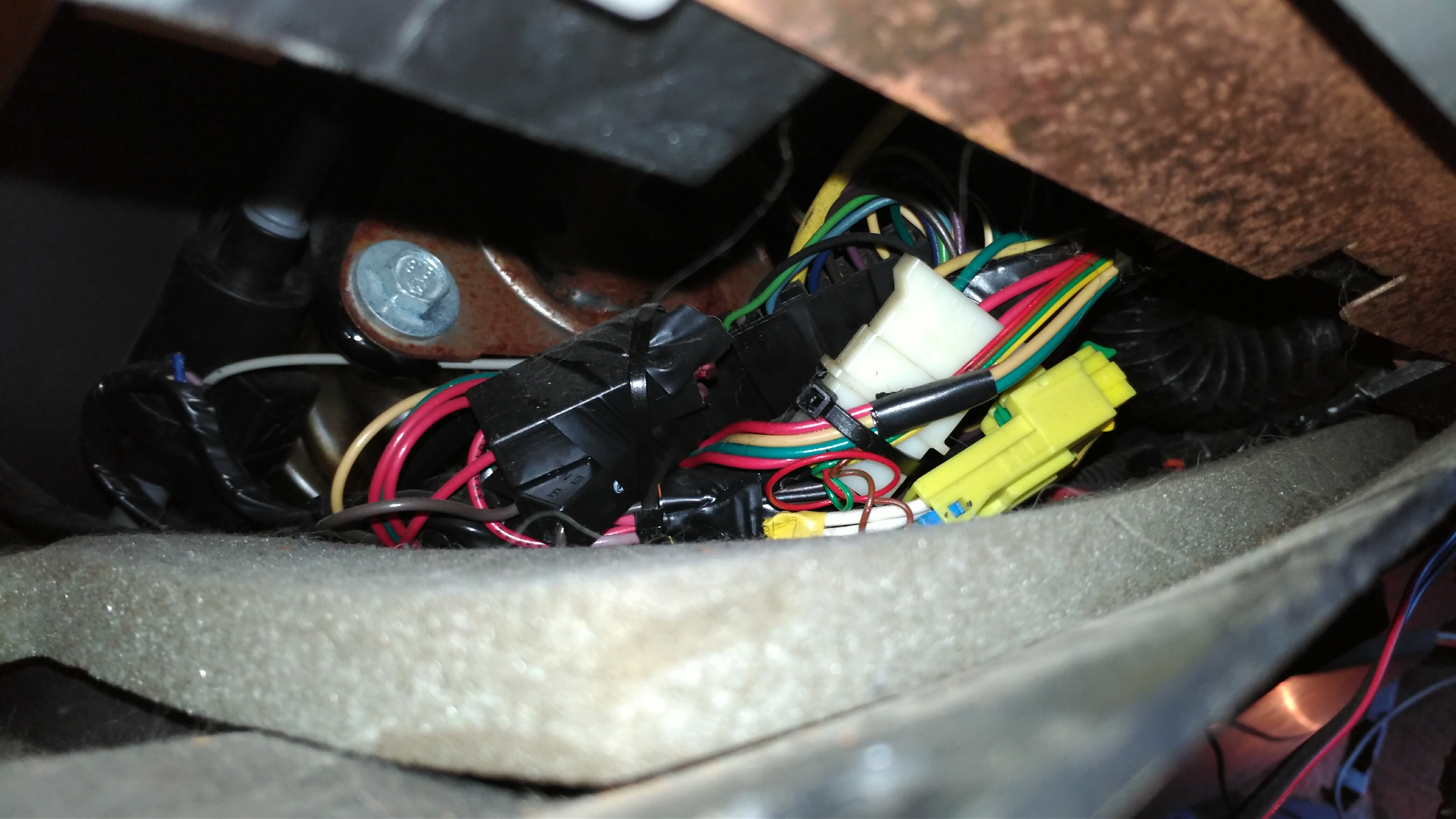

So I got my Haynes manual located the PCM and... There's 3 white wires connected to the pcm, I have no clue to which of the white wires is for the tach, now I have everything but the tach wire connected. It looks like there's 4 wire clusters connecting to the pcm and 3 of them have a complete white wire. The diagram shown in the manual does not completely specify what wire harness connects in the overall car. Now if there's a more direct connection under the steering column what harness should I be looking for? Thank you guys so much! I can't wait till I have this all hooked up.
Wire harness under steering column
Pcm
Pcm

Okay so i found the tach signal wire... On the PCM It's connecter A cable 9 WHITE. ONE ISSUE THO.... its a digital output... my aftermarket tach is analog... now how do i convert the tach signal from digital to the analog signal? I was looking online for a converter and I dont know what would work in this application tho. Does anyone know what type of converter would work from the pcm?
Sadly for Chilton... This only applies to the pre 96 cars where the Ignition control Module under the coils fed the tach, in 96 it changed to the PCM feeding that signal.
