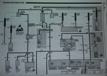

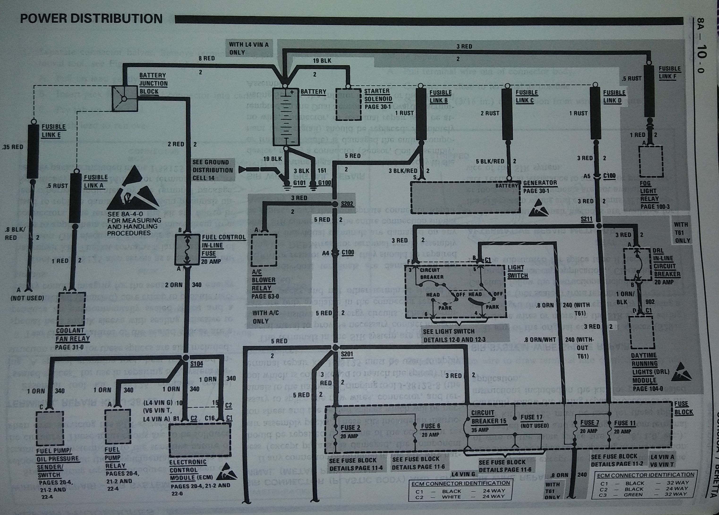

I got a hold of some schematics.
Headlights, interior lights, and radio look to be running off of fusible link D in the schematic below.
Get a multi-meter and set it to check DC voltage, minimum 20 volts setting.
Open the engine hood and look at the relays on the firewall, locate the 12 volt terminal on the firewall, this should have 12 volts.
Note that there are 2 fusible links on that terminal.
What the schematic shows is fusible link D, it looks like this link is located at the starter motor "+" terminal. If you can locate this link, see if it is blown, if it is blown it needs replaced with a new one at the proper amperage. If the replacement pops, check for to much current draw or shorts, sometimes something as simple as changing to an aftermarket radio can make these pop.

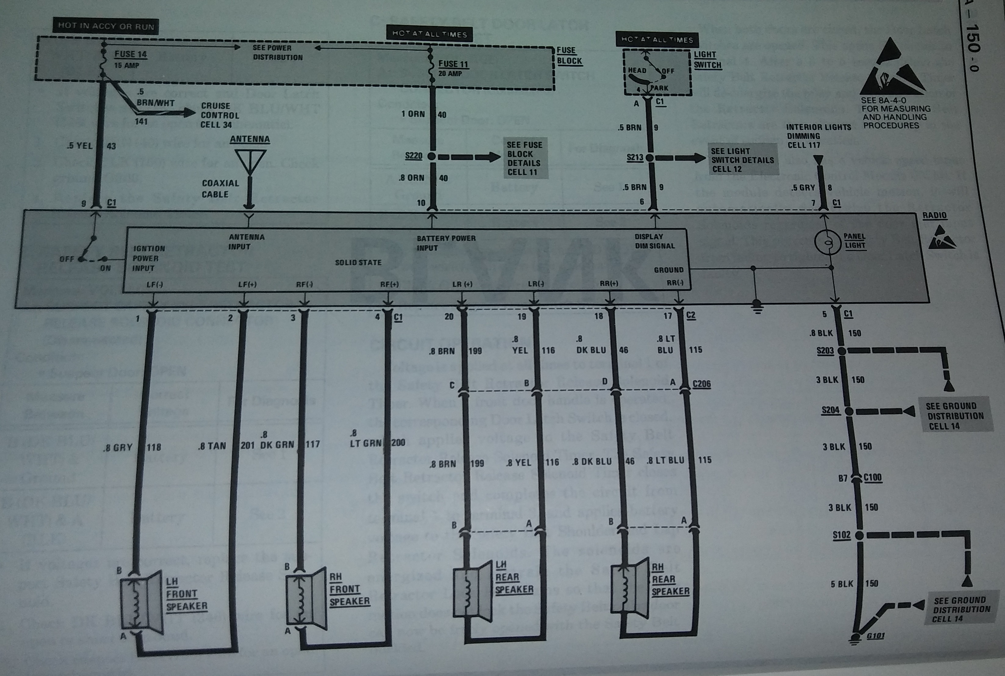

See the below image for radio wiring, check for power on the orange battery input wire according to the schematic.
Check fuses in the driver door jam for 12 volts, look at fuse 11 and fuse 7 and see if they have 12 volts, if not then its a good chance that the fusable link D is broken and needs replaced.
If you have a 1990 Beretta Indy service manual reference the electrical section in pages 8A-10 for power distribution, and 8A-150-0 for Battery, and the headlights are in there as well.
Check power wires to known grounds like a bare metal spot on the body, use a working 12 volt source to verify grounds with the multi-meter.
I had this same issue on my older Cadillac, except the fusible link didn't pop, the wire going into it corroded inside the insulation right next to the link as they separated enough from age. If Link D is at the starter solenoid, its possible that its more prone to premature age.
