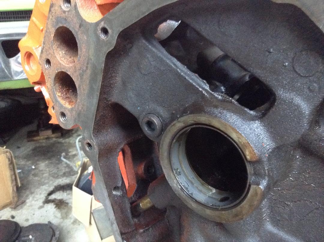

I took a break this afternoon from the DOHC-Z project. I found this on my old Plymouth's engine: :o
This is not the original 383 Big Block from my car, which is sitting on a stand too. This is a replacement Big Block I bought a couple of years ago to drop into the car while the 383 was being rebuilt (and yes, 'BUILT'). But, it turned out to be a fairly fresh rebuild already, and I liked this engine after I picked it up and found how clean it was (as you can see in the pics, the inside is spotless except for some minor surface-rust in the water passages), so I decided to build it a little first. It is the same block as my 383, but with heavier castings and the biggest slugs Mopar used back then, 90-thousands more than the 383 and even bigger than the famed 440. I bought a new Lunati VooDoo cam for it over the winter, and a gear-drive set to go with it (Mopars are notorious for stretching their chains -they still run fine, but not necessarily ideally). I thought the cam bearings would be new with the rebuild, and was ready to slide in my new cam and lifters. Nope. Looks like water damage to me, I am afraid of what the crank bearings look like. I scoped the cylinders when I bought the engine, and they are great.

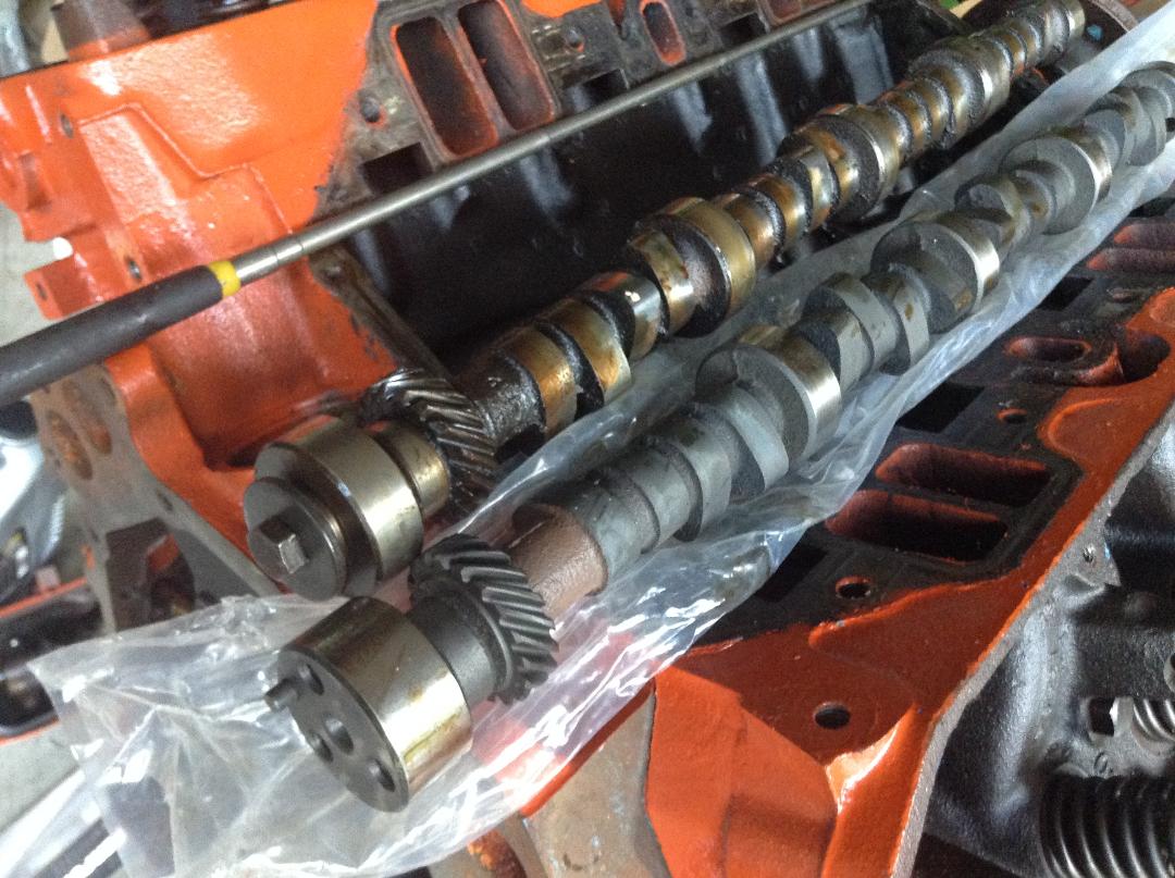

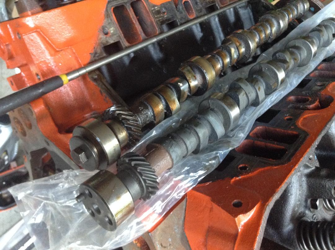

Yep, that definitely crimped my plans for the evening... Every time I move forward on this thing, I get set back half a pace. BACK TO THE BERETTA!

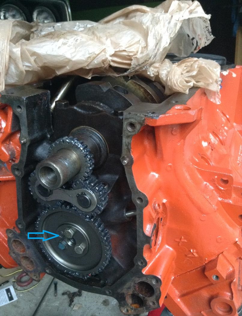

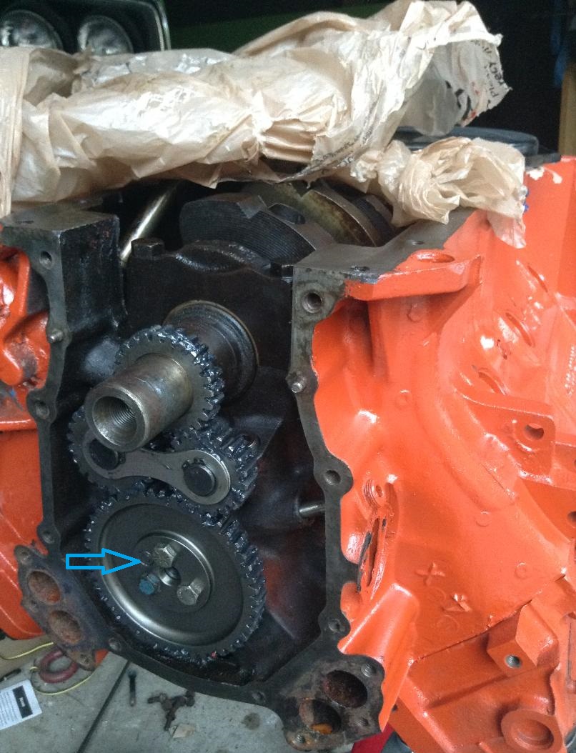

I finally snuck off the other day to replace the camshaft bearings in the old Mopar. I had searched a little and gotten the multi-layer babbit bearings I wanted. The gear-drive set I bought is adjustable, the alignment dowel (arrow) has multiple off-center inserts to micro-adjust the cam timing. The Lunati cam I bought has the performance-style three-bolt mount, vs the stock-type single-bolt. Interestingly though, Lunati uses 3/8" bolts, the timing gears were supplied with 5/16" bolts although the holes were big enough for 3/8s. I will have to get a couple more Grade-8 bolts -I could only find one of the right length in my stash... It is getting closer!

GT_Indy wrote:Looks good to me. lol.
I wonder if straight gears like that is better or more reliable than using a timing chain, or a double roller chain.
Do you think grade 8 is strong enough for that?
Thanks. Especially with Mopar engines, chains tend to stretch over time, significantly altering actual cam-timing. Vibrations are not good either. The Big Block "B" engines (as opposed to the Big Block "RB" or Raised Block, like the 426 and 440 engines wich have taller decks and longer rods) are rev-happy powerplants, and sloppy chains are just counter-productive. This cam is fairly radical, about the limit for good streetability. With the upgraded valve-springs and the RPMs this engine will see, I don't want 'variable valve timing' or vibrations interfering with reliability or performance. A double-roller chain would be a vast improvement too, but I also like the sound of a noisy gear-set. :wink:
Is Grade 8 strong enough? Well...
On a 3/8" bolt (and this has three of them), Grade 8 is good for over 10,000 pounds of shear force. ARP can do about 400 pounds more -oooo 4%. :roll: Grade 5, which the set was designed for and equipped with, is over 8,000 pounds, but they sent 5/16" bolts which drops the strength to 5750 pounds per bolt. Normally, the stock cam has only one dowel-pin, plus the friction from the center-bolt torquing the timing gear to the face of the cam. This set is nearly press-fit too -it is going nowhere without its' cam... :good:

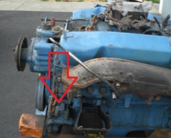

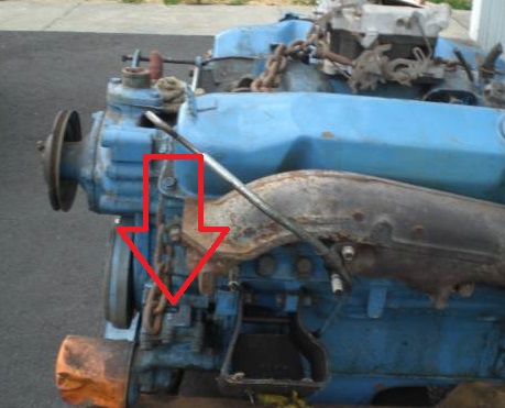

Quad oil-pumps are, well, interesting. I've only had one fail, and yes, it caused the death of the crankshaft within about five seconds of pressure-loss, thanks Oldsmobile! Phenolic driven-gear on the pump, presumably used so that if the pump seizes (like mine did) it doesn't destroy the drive-gear on the crank (of course my crank was ruined anyway), and it is also quieter and to a degree self-lubricating. Interesting concept -some old engines actually use a similar phenolic gear for the cam, just to go full-circle. Honestly, my Quad (a L.L.L.L.O. SOHC variant) had something like 180K on it, I doubt the pump had ever been changed, and I know the bearings hadn't been. I had looked them over at about 164k, and they were still serviceable, but showing wear. If that engine had brand-new bearings when the oil-pump failed, maybe they would have survived? Or maybe it would have just ruined new bearings...
Oil pump on a Mopar Big Block? RIGHT ON THE OUTSIDE OF THE ENGINE! In fact, the oil filter screws directly onto it on the front. Piece of cake to swap, could probably do it in five minutes with some practice. :good:

But the question is how you did to adapt them because sometimes it does not fit.

cathpeta02 wrote:But the question is how you did to adapt them because sometimes it does not fit.
Didn't have to modify anything to 'adapt' it. When I was first looking at the Lunati cams, I saw immediately that to use one of them would require a different timing set, unless my 400 somehow had already been upgraded to the three-bolt type, which of course it had not. That was when I bought the gear-drive. Aside from the oddity that they supplied the wrong size bolts, this dropped right in for me, as pictured. Currently, I am tinkering with a twin Supercharger setup for this, using dual 67CI Eaton units, running a draw-through and debating on whether to use the 1000-something CFM Thermoquad that came with the engine (preferred, as the tiny little primaries should keep this from sucking down all 20 gallons in the tank before I can make it around the block) or the Square-Bore 750 CFM 'Demon' I have sitting on a shelf. The Demon LOOKS a whole lot prettier -this is NOT one of their Holley look-a-likes- but this car is as much about go as it is show, and the Thermoquad is just featured more how I want it -mechanical linkage to the HUGE Secondaries, etc.
