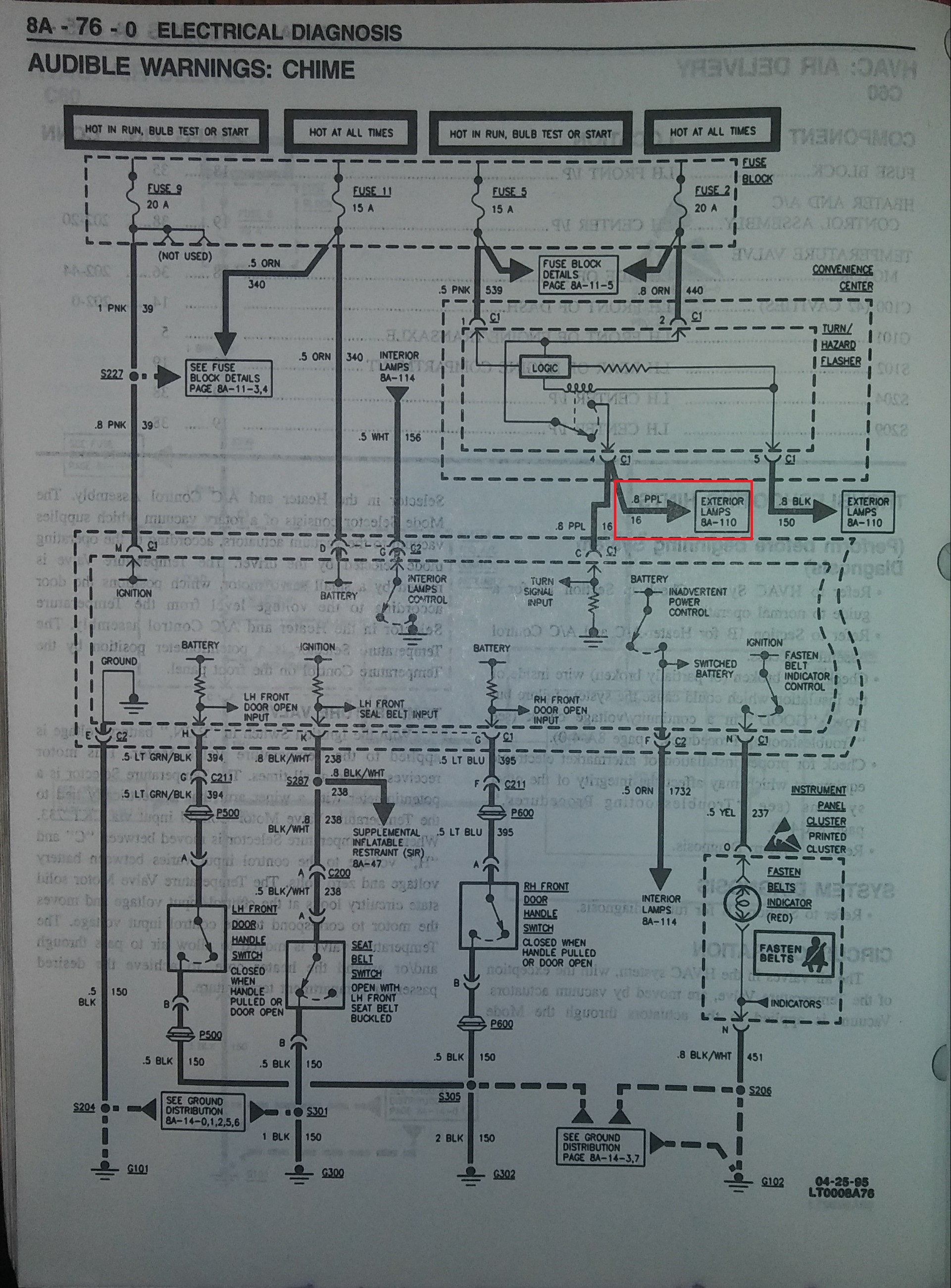

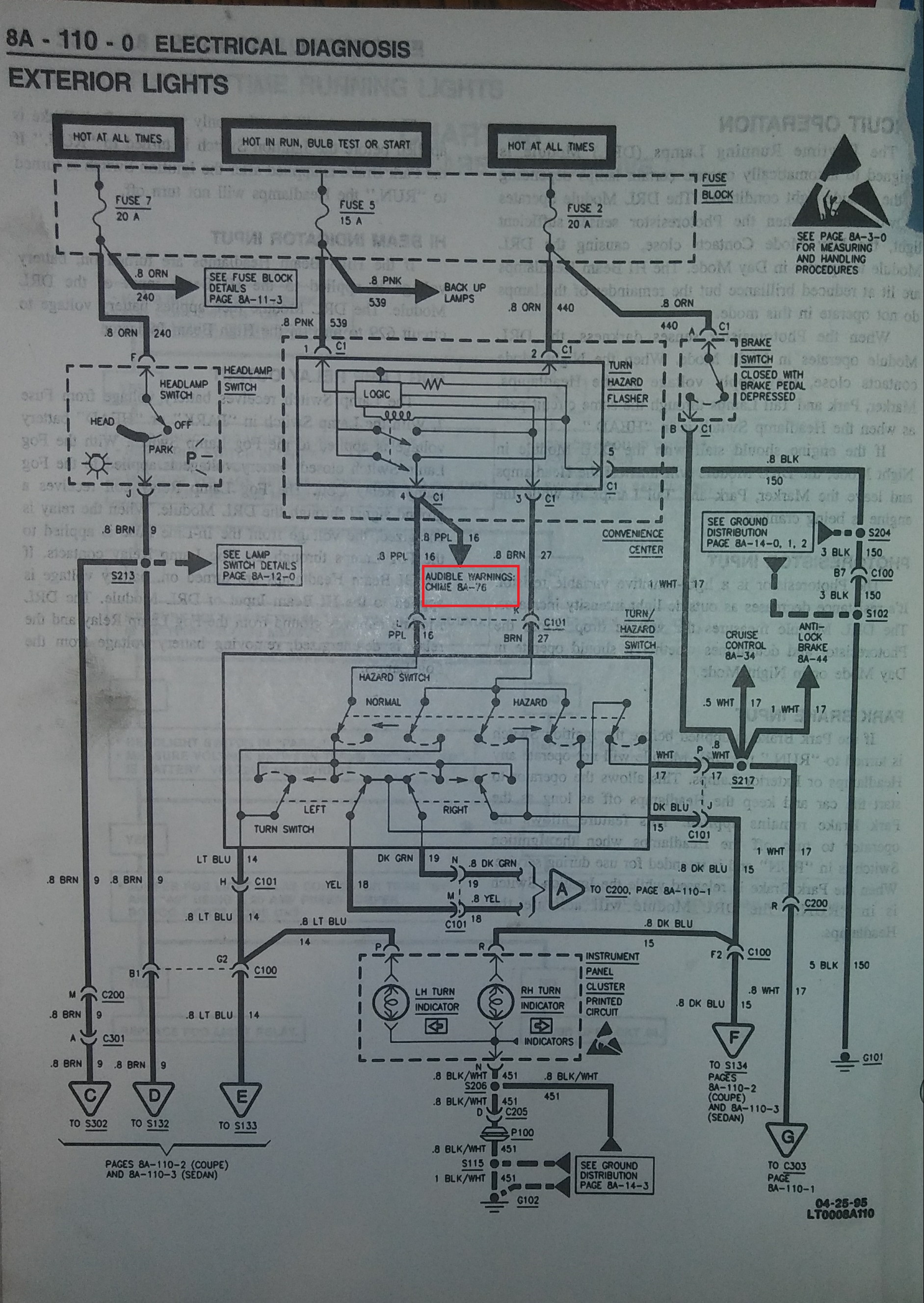

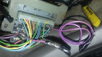

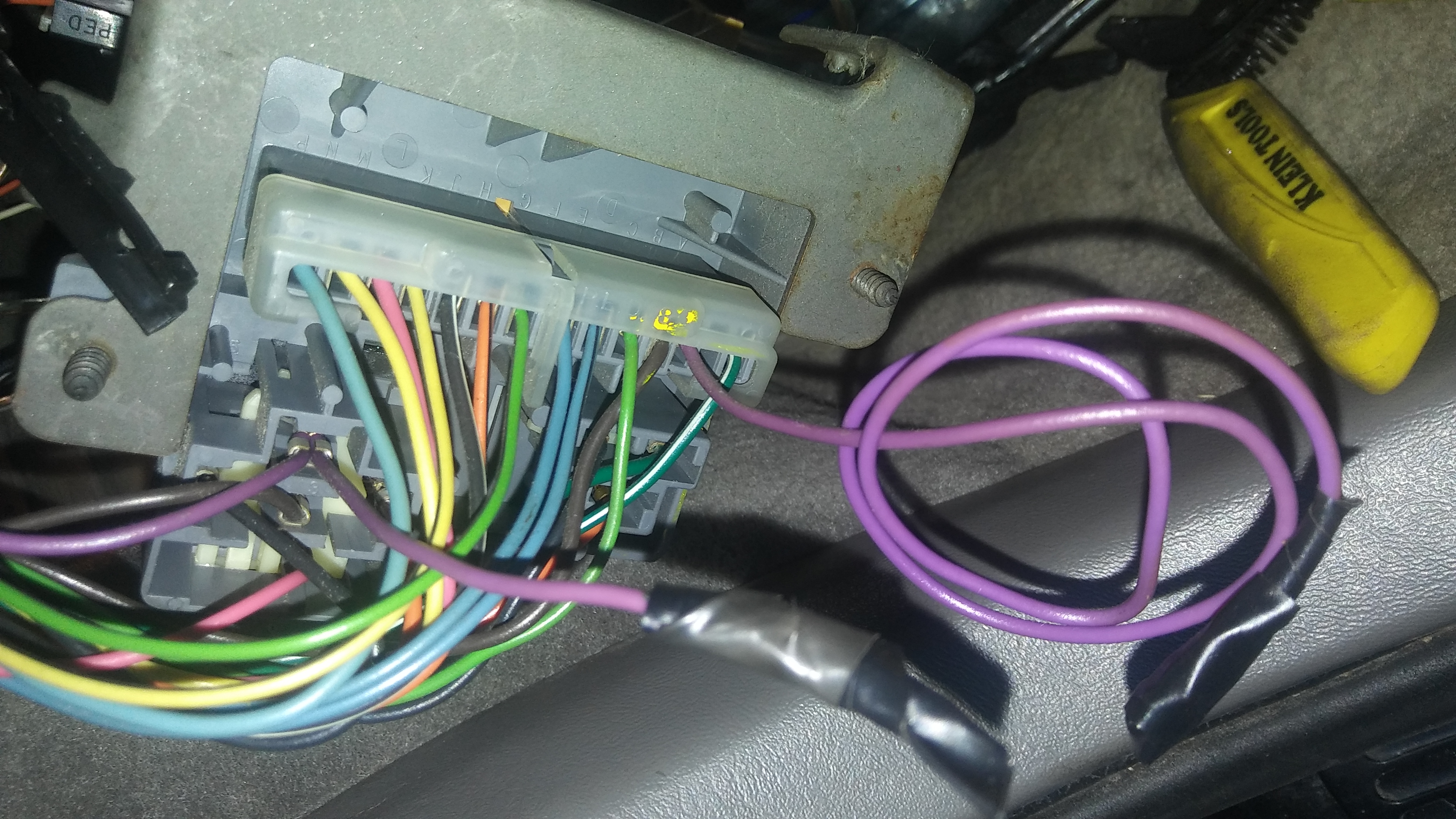

I found the solution for using the EP27 Flasher.
(This is on my 96 Beretta, I don't know which previous years this will work with).
If anyone is doing a euro tail light swap and uses this flasher relay, or if you need to replace your flasher relay because you bought LED bulbs or another reason. You need to cut 1 more wire.
Its a chime wire and its purple.
But its not the light left on or key left in ignition chime.
Its some other chime which never seems to sound off. I never heard it, car still makes the same noises without it. lol.
Easy to find and cut. Unravel the tape up the bundle of wires and follow both purple wires, the purple wire that goes to the big brown box on the assembly is the wire that needs cut.
Photo below shows which wire it is.
I hope this is helpful for anyone who plans to use the EP27 Flasher which can be found at almost any auto store from what I can find.
It plugs right in, no mods necessary other than cutting this 1 wire, same connector layout as factory. That is for the 96 Beretta.
I believe it also works for the 91-95 as well, whenever they started using the newer flasher design.
The older design like my 1990 GTZ, I will have to cut and add in the plug for this flasher.
Photo added below.
