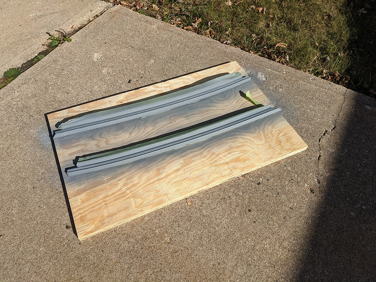

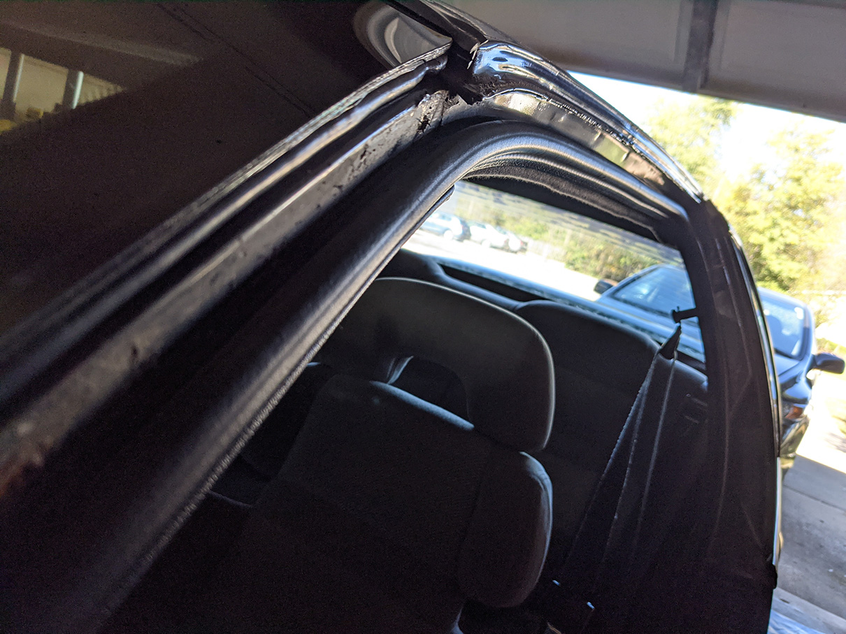

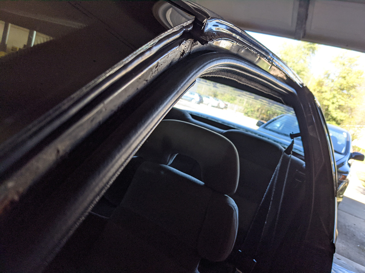

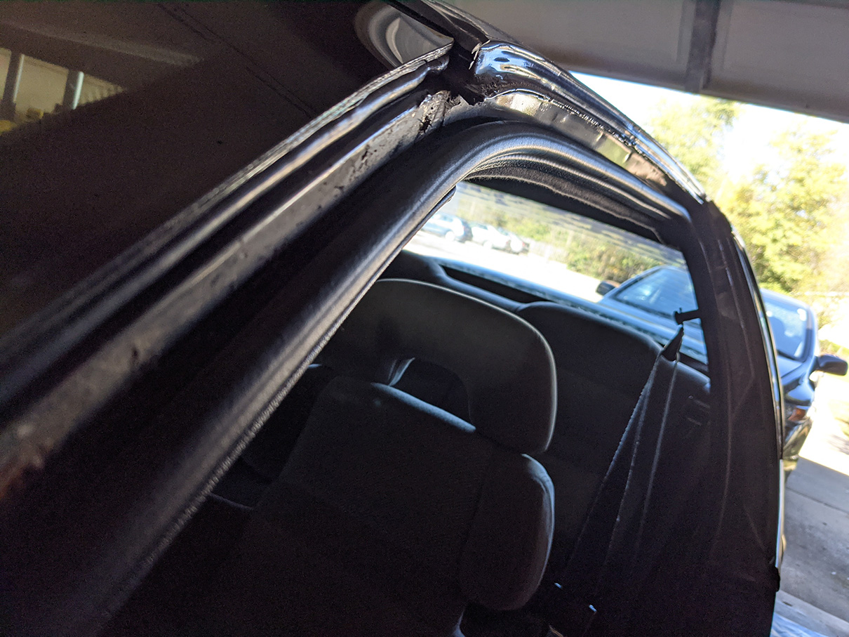

There's a few 7mm screws that hold the trim in that are hidden behind the door seal. It pulls right off after you remove them. I didn't grab a great photo at the time, unfortunately, but this is what I have:

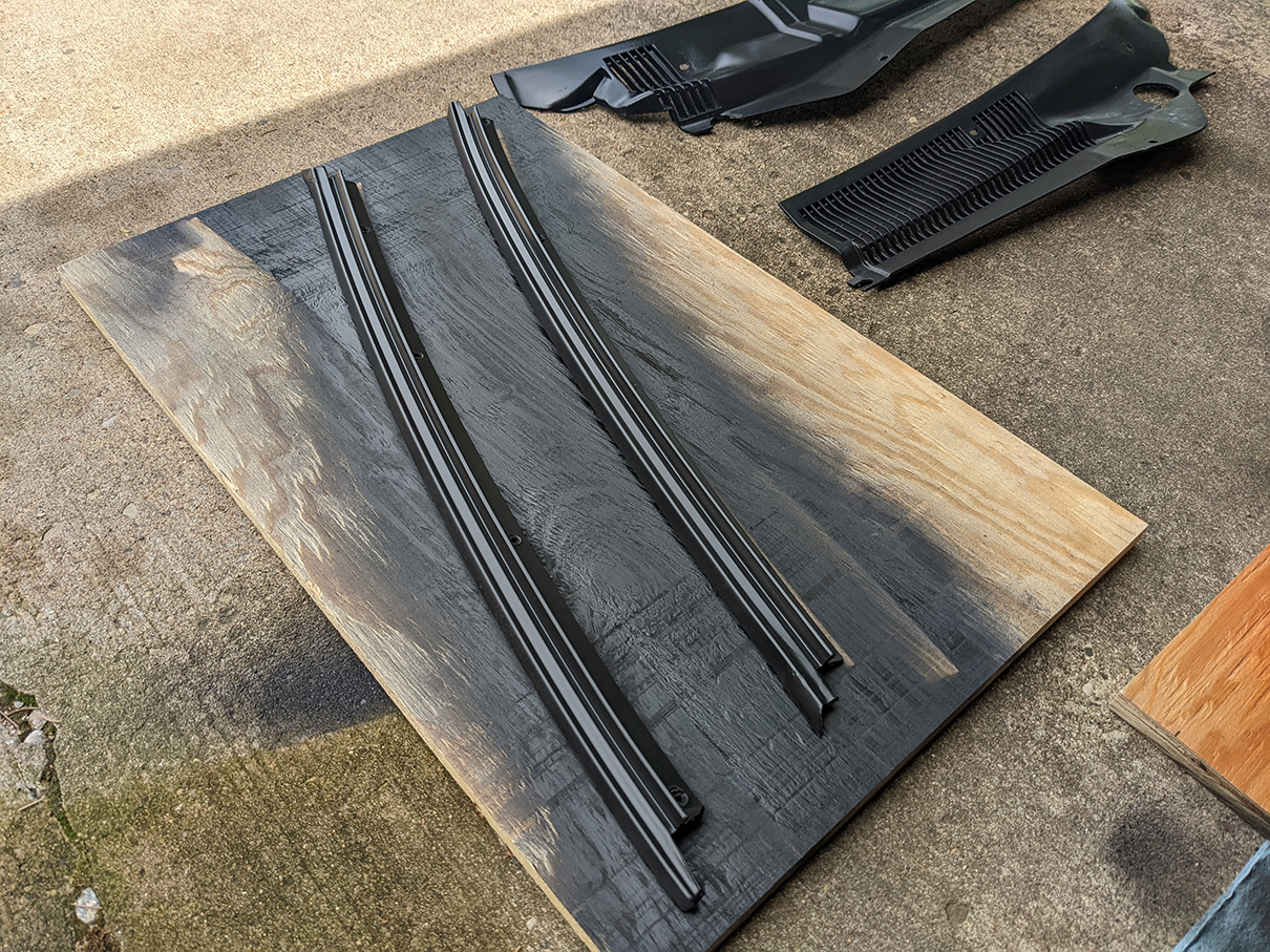

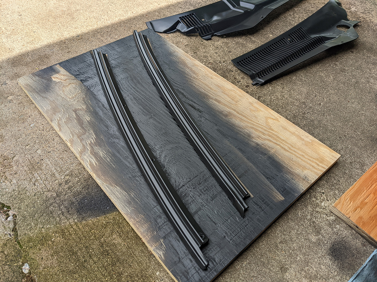

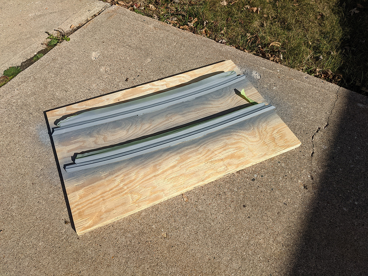

I cleaned mine up (tried to make the surface even since half the rubberized coating was missing), sprayed over them with a primer and then hit them with SEM Trim Black:

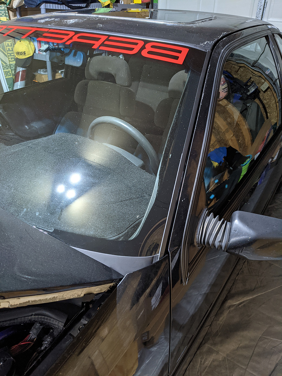

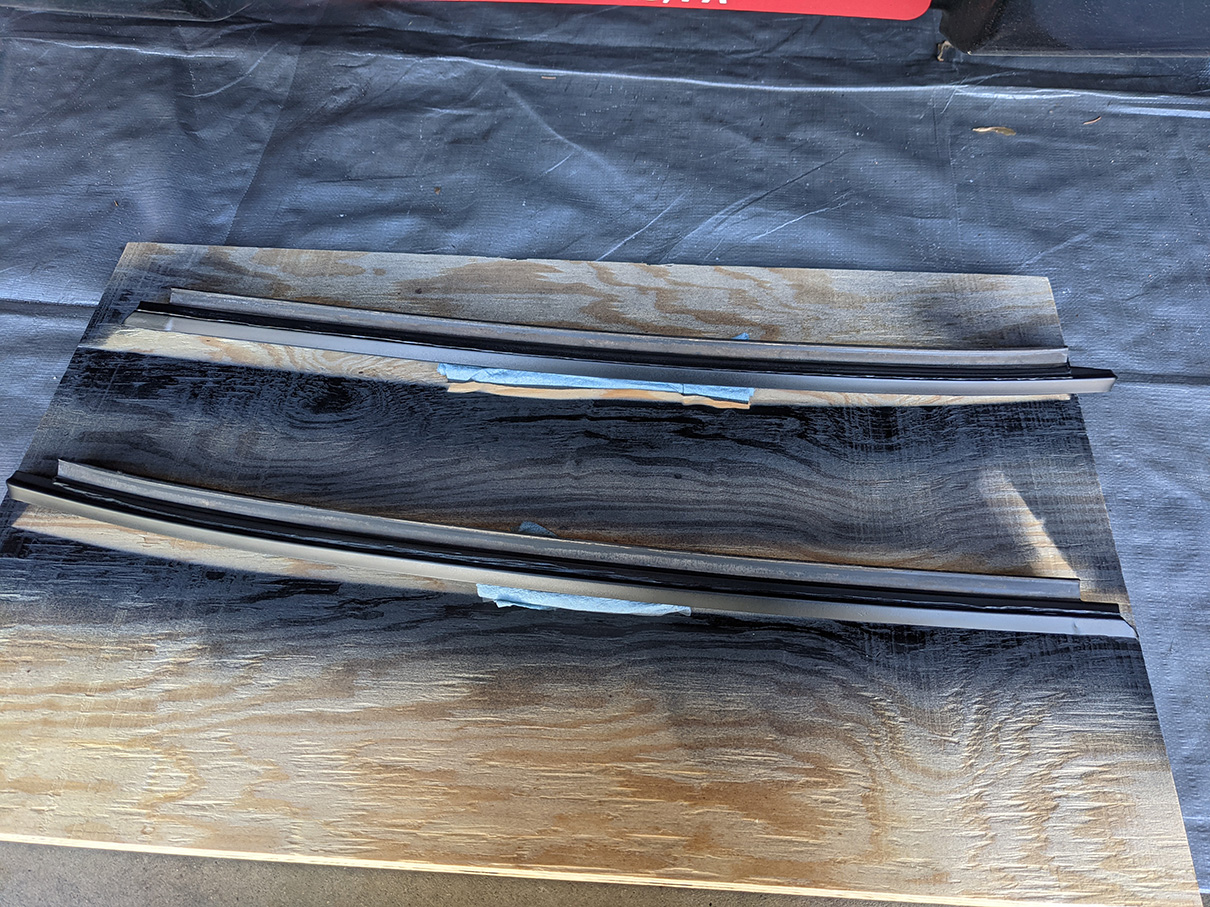

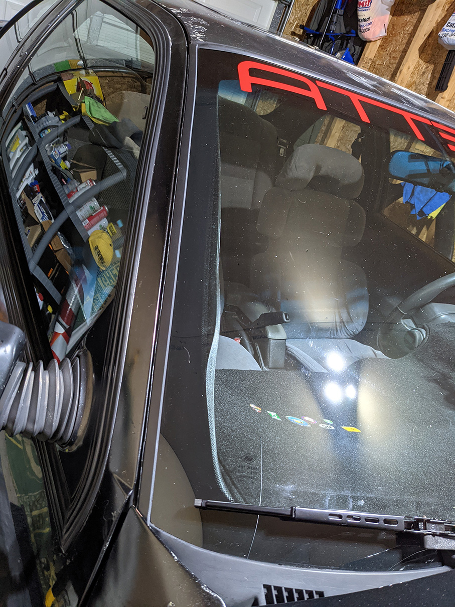

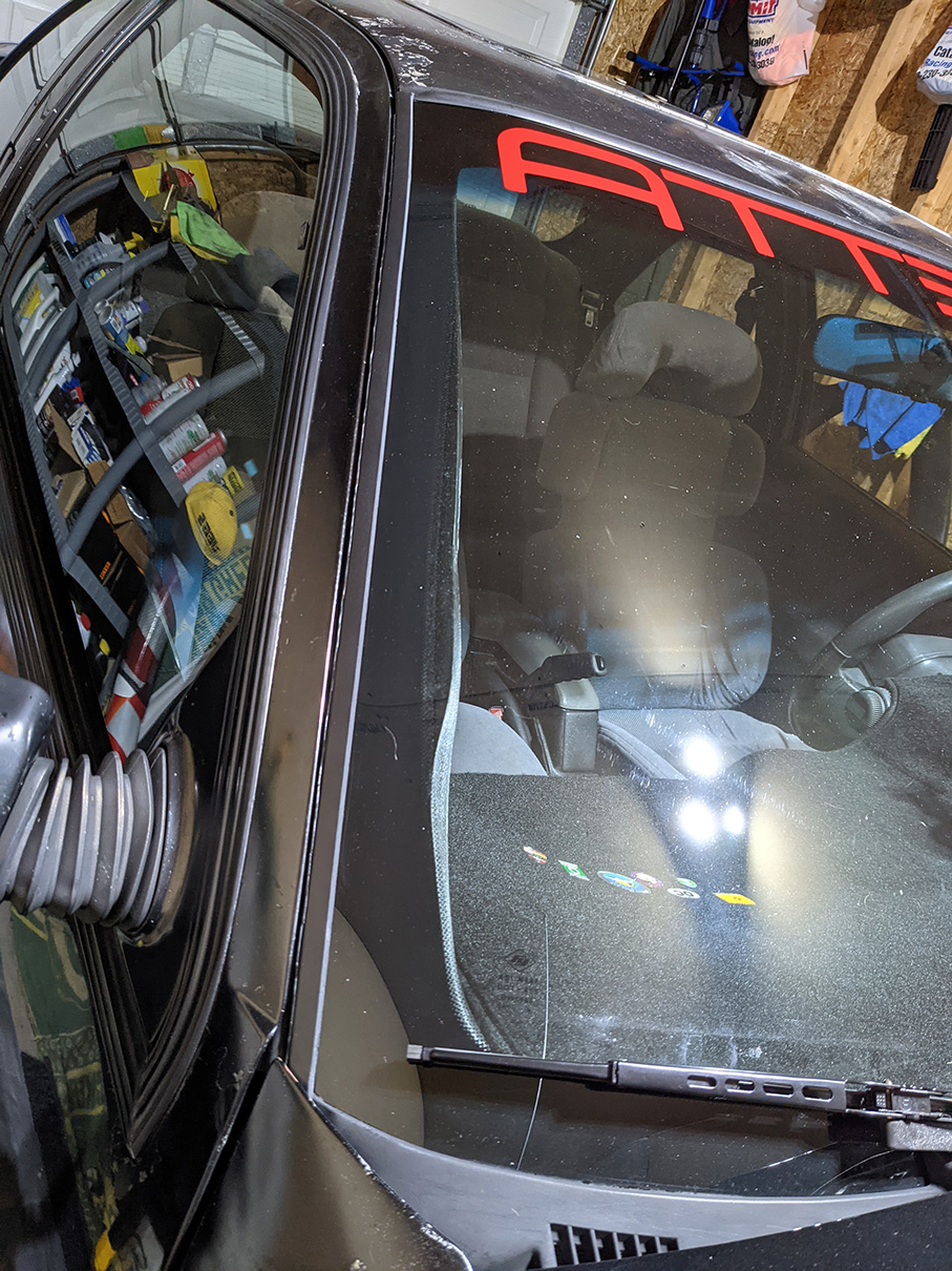

I later got a second set that were in much better shape apart from looking a bit tired, and gave them the same treatment. They turned out a bit nicer:
