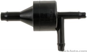

Finally making headway on my 1989 2.8 Corsica. https://www.beretta.net/forum/viewtopic.php?f=8&t=24943 replaced all six injectors. No leaks from the fuel rail. The car Idles much better and doesn't die anymore. It still Idles rough though, and the SES light turns on (Code 12 only). I accidently broke off a part of the AC Vaccum conrol valve (bottom stem in attached picture.) Do you think this could be causing a big enough vaccum leak to throw off the idle? I can hear air hissing out of the check valve pretty good. I already ordered a new one from rock auto. Just have to wait a week for the three dollar part to know for sure.

Even small Vaccum leaks can throw off idle. Try plugging the line to see if that causes any improvement.

I did notice an improvement when placing my finger over the broken valve piece. It was hissing pretty loud. Yesterday I got the replacement part from rock auto. Put it on and plugged the hoses in, now the car doesn't want to start... I just about drained the battery trying to get it to start, at times it seemed like it was beginning to cycle. I swapped the hoses around on the three-way check valve I just replaced thinking I hooked it up wrong, no effect. So im hoping unplugging the battery to charge will help. Maybe the computer got used to running with a vaccum leak. I will try fresh gas as well. Under a 1/4 tank now with gas that is at least six months old.Cam2363 wrote:Even small Vaccum leaks can throw off idle. Try plugging the line to see if that causes any improvement.
