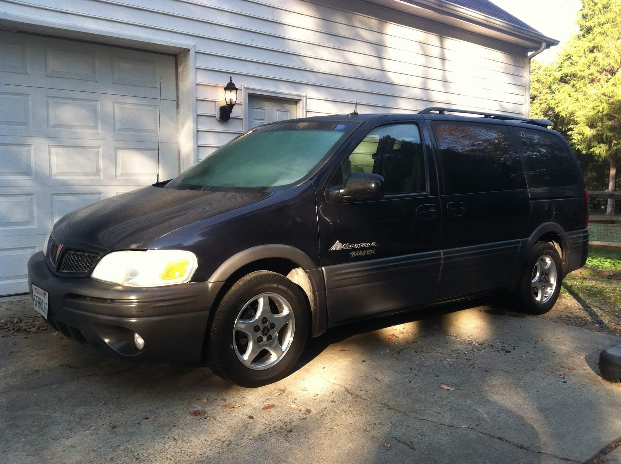

So here is my spin on a "Man Van".
A few years ago, I decided to get a minivan after a road trip to MI in my 2014 Honda Accord Sport - we needed more space as a family, and I'm ok with a minivan, as long as it's my "style". Searched for a U-van, my requirements were that it was blue, had leather, and added bonus if it had the RSE (rear seat entertainment) option.
I had this rust-free van shipped over from California. Mr. Chad "Lemon Jello" Loniello checked it out for me since it was only an hour away from him, and helped me get it shipped over to NC.
It's a 2003 Pontiac Montana, fully optioned with the "Thunder" package (two-tone leather interior, captains chairs, back up alert sensors, leather-wrapped steering wheel, 16" 5 spoke wheels, load leveling rear suspension, touring suspension package, heated front seats... I think that's about it. Shockingly, the van came with it's original window sticker - almost $33,000!!!
It is Blue-Black metallic, with the lower trim being a darker grey/graphite color. Super clean vehicle, no accidents, no rust, 146K on it when I got ahold of it.
A year later after taking delivery of it, the transmission decided to crap out - a 4T65E-HD. Common issues around the 150-160K mark. Now onto the build...

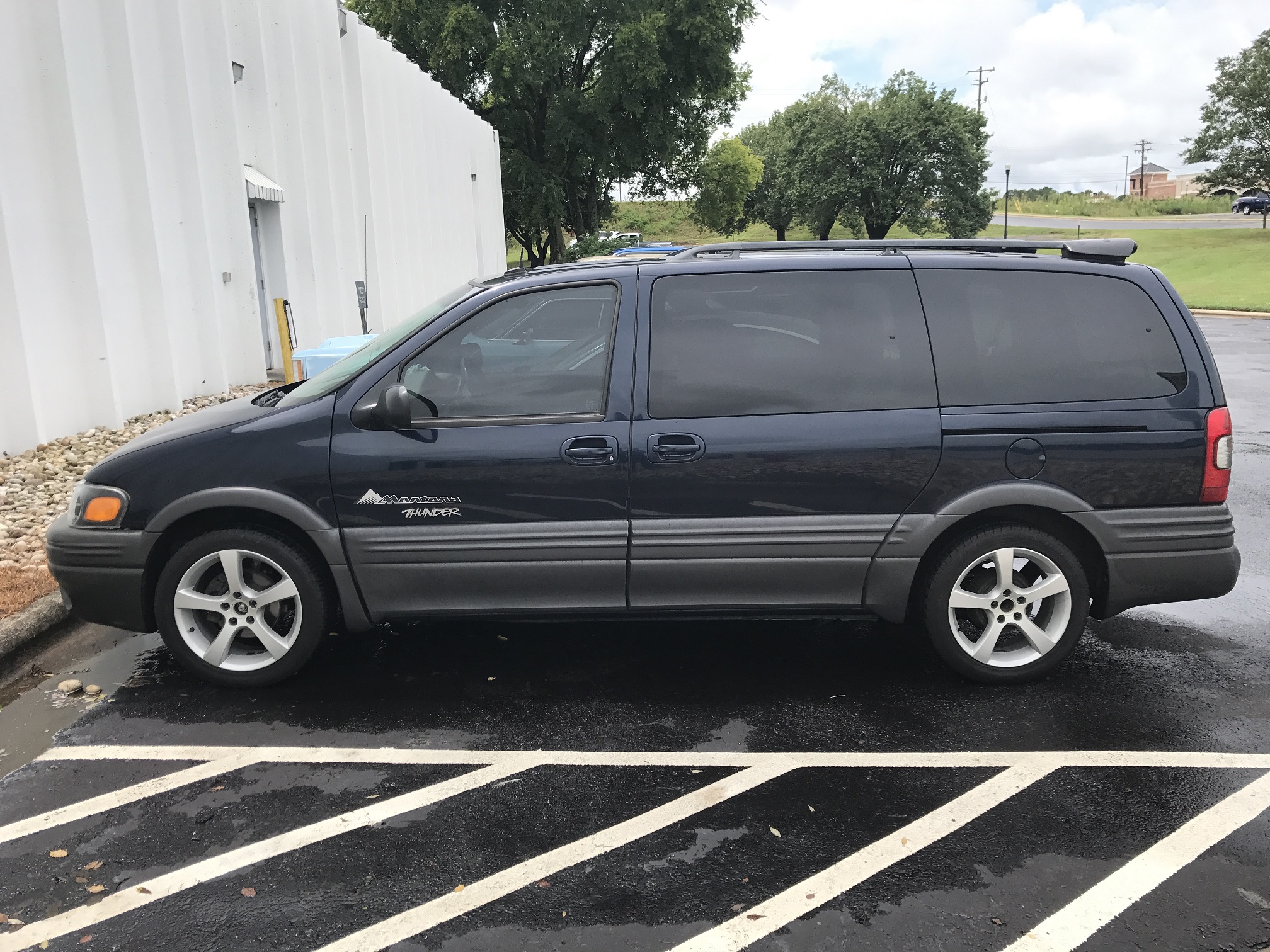

Here it is with the new black headlights housings/turn signals from eBay, the Bonneville GXP wheels, and tint on the front doors. I got the wheels from the junkyard, repaired the curb-rash on all the wheels, and repainted them.

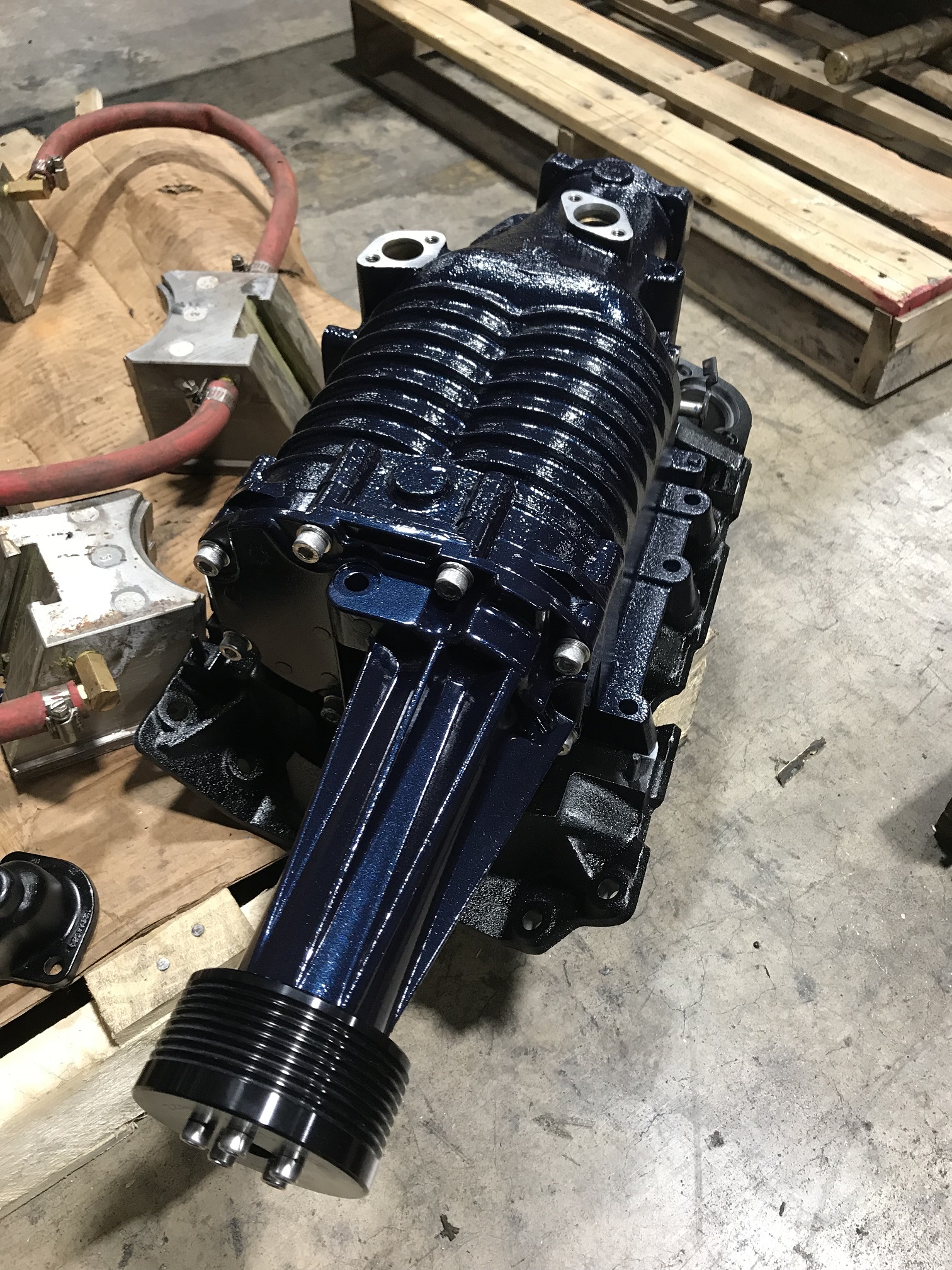

Here's the Gen5 blower - fully rebuilt with new bearings in the rotated assembly and snout. Installed a MPS hub from ZZP and a 3.4" pulley for now.
The only thing I'm debating on with this blower is if I should weld the silencer holes shut - that'll give me more whine at idle.

This is exciting.
Please go 2.8 pulley and E85
