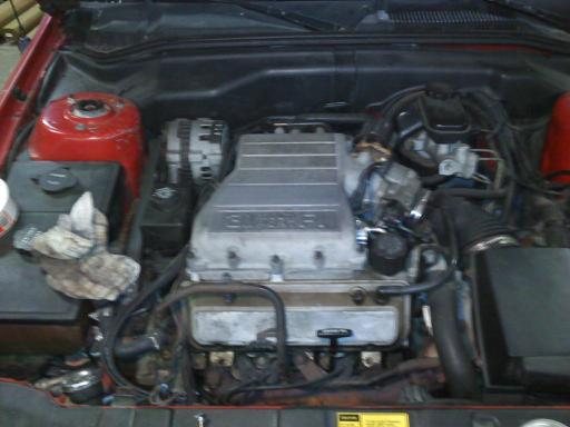

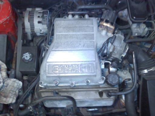

Any tips or tricks on cleaning the oxidation off of plenum? I have tried many different cleaning solutions/fine sandpapers/ fine wire brushes, but nothing is really giving me the results I want. Is there any other products that I could use or am I just going to have to stick with time and the good old elbow grease?
Also, what would be the best to polish it with?

It looks good right now. I think I used a green 3M pad to clean of my 3400 intake, but it was not as old(it's a 2000). As for polish it's better to leave the ruff coating. If your talking about the smooth spots a good mag wheel polish will work.

Cool man. I still have hope that I can make it to one someday. Post some pics of the intake after you get it done. Or some close ups if the 3M pad doesn't help. I can tell you I did have to work hard to get that stuff off.

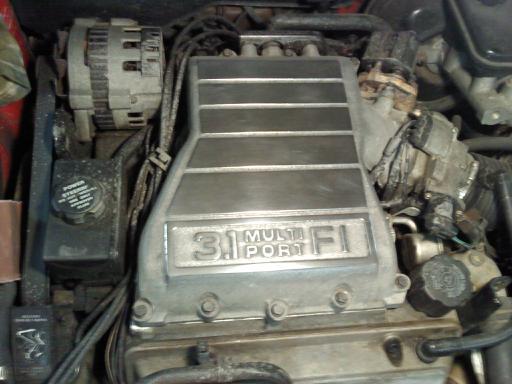

Yup yup he did. I worked on my today for about an hour, scrubbed most of the stuff off with one of those 3M pads and some super clean. Just started wet sanding, probably gonna work on it some more tomorrow and start to buff and polish. I'm probably gonna just remove it and set it on a table so its easier to work. I didn't want to remove it because its been off alot and idk if the gasket will hold up much longer. But I'm hopefully gonna pull the motor this weekend to put a bigger cam in it (I don't really want to cut a hole in the side of the fender wall). I got like 5 different things that I want to do to it and I don't know what to prioritize.

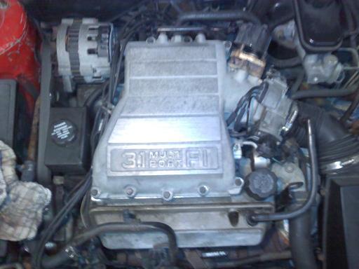

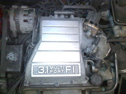

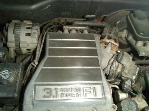

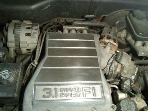

I got the intake all cleaned up now... I can actually see myself in the reflection. 3M pads worked pretty good for removing most of the build up. After I got most of the oxidation off, I started to wet sand with 320 grit sand paper. When I finished sanding, I hand polished it with some Mothers Mag & Aluminum polish (or something along those lines). It turned out really nice, I'll post some pics and check into those parts, thanks for site.

Sorry about that. The site was down or something. But here they are, still doing some more polishing, idk why, I think it looks pretty good but I don't have anything better to do(lol). Was thinking about doing the same thing to the alternator, but I stopped because it would be just my luck that as soon as I get it finished, it would seize up or something along those lines.
Oh, and the lighting is not that great, I have a flash on my phone and I had an light hanging from my hood. It looks alot better in person.
