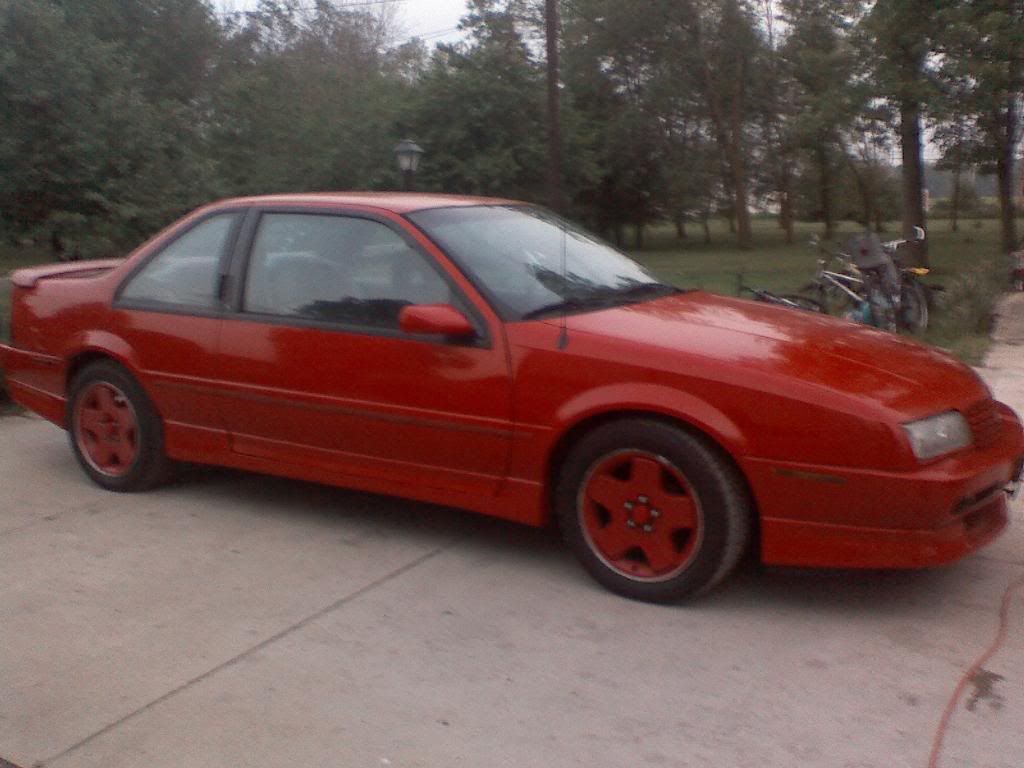

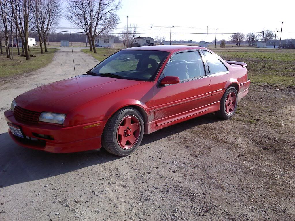

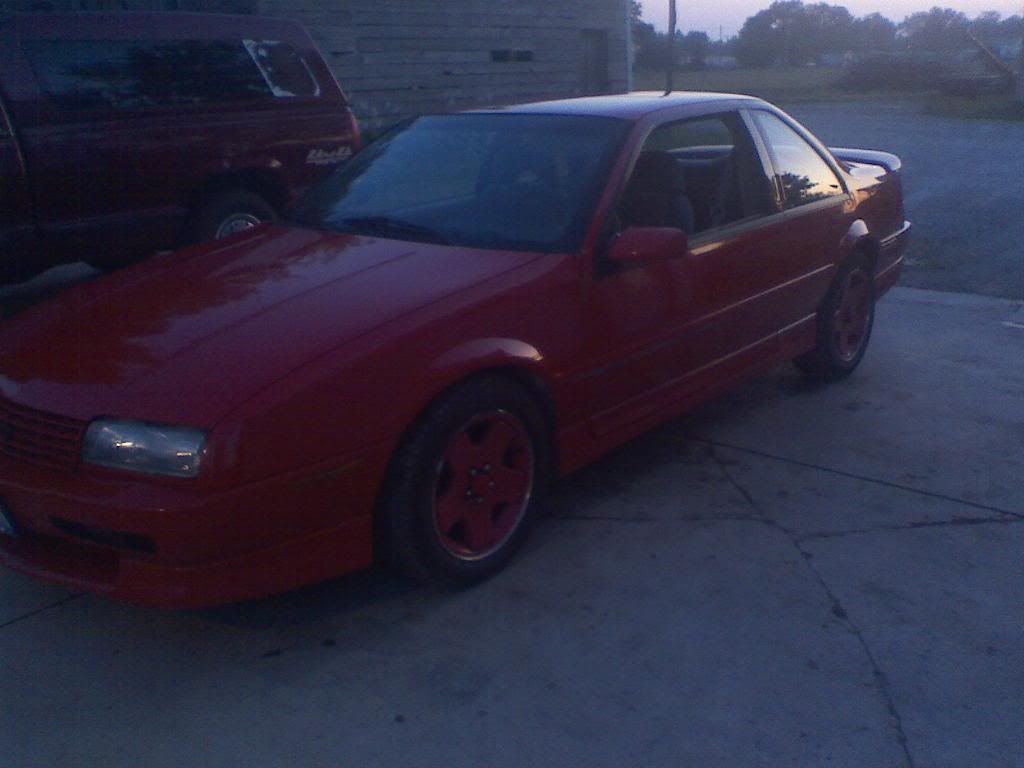

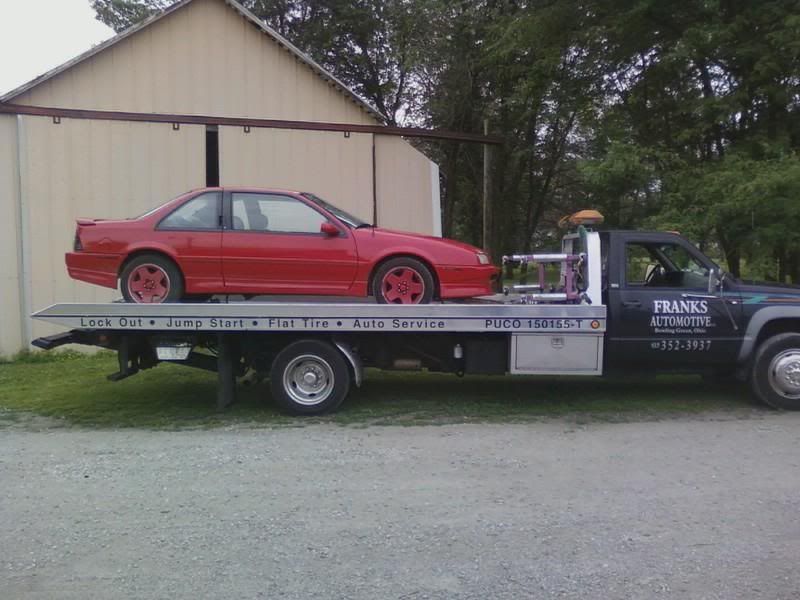

This is my 1991 GTZ. It has a 3.1 V6 with a 3-Speed AT and has 176,XXX miles on it and still kicking. I bought it back in May '09. Almost no rust at all and no serious dents. Has a couple of stone chips on the hood, but not for long (Planning on a new paint job soon, will also fix the rust). Pretty nice interior, clean for the most part. One of the previous owners was a smoker :( so there are a couple of cigarette burns on the seats :evil: . I had to replace the windshield and headliner. Working on a list of mods I want to do to it. If you want to know anything else just ask.

I really do like it. I had dreams that my 90GT could look as good as your car. It would have been nice to have the GTZ kit on that car. And some paint(lol). How much did you pay for it?

NICE! Just some suggestions to set it off, get some vent shades, and try and find a solid grill. I know its not supposed to be on there but I think a Z without 1 just looks weird. And you'd be suprised how much a suddle mod like vent shades make these cars look so much better.

I don't really like the solid grill lol... Im more used to the open one, but Ill check out the vent shades. I paid 1000$ for it and it had 4 brand new tires.

All good, after all it is your car, when getting the vent shades make sure you don't get the ones that stick on the outside of the door. Weathertechs are really nice, but I have autoventshade ones on mine and they look good too. Really cheap too! Good luck with it all.

Man that is a great price for such a nice car. This is the place to put all your planned mods.
