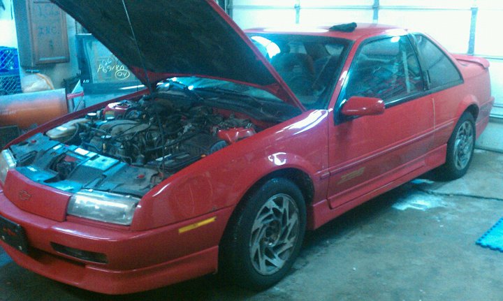

my new 96 z26

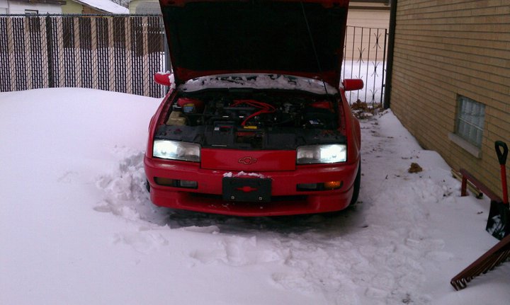

after i did a dumb move by trading my 96 black rose metallic beretta with a brand new 12k mile 3400 from jasper along with a under 30k mile transmission for a 90 eclipse gsx that blew up on me, while driving it home. yea i got the sh** end of the stick well. I sold the blown transmission gsx for 1300 and bought a 96 z26. Clean as can be it does have a dent in the front fender and a very little rocker rust, that will all be fix shortly. But the car has 171k miles on it everything looks new. minus the motor i was told it has a new motor in it with 100k on it but it has a lot of top end noise. currently awaiting a 3500 swap will most likely be in by early april due to a current set back. heres a few pictures of it, also with a new fitting for the heater tube and some other minor repairs and upgrades.

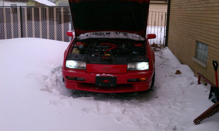

some more pics.....
im looking for some parts, 3500 swap parts is a big deal, maybe some z26 centers caps, maybe some kick panels in grey or black, also i need some door plastic moldings (they hold in the kick panels held on by 4 screws grey in color)
Ill post more pictures as i make progress with my car, next gonna get the seats upolstered with a red stripe, and a custom headliner nothing like barry's but im thinking a black microsuede, also gonna dye the carpeting, paint the center console black, also around the cd player paint that black also. Ill make sure to keep you guys posted as the build comes along, itll be a slow process since im saving for the 3500 swap, and a 3.69 fdr trans. automatic trans of course.

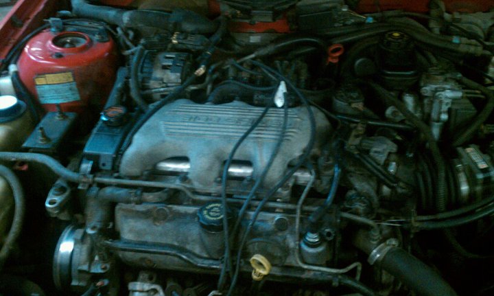

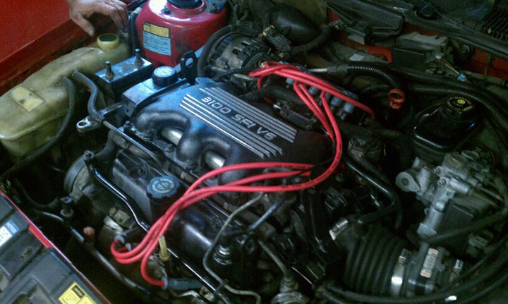

well i got a few updates for you guys...

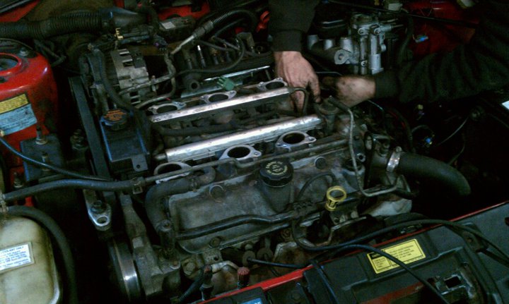

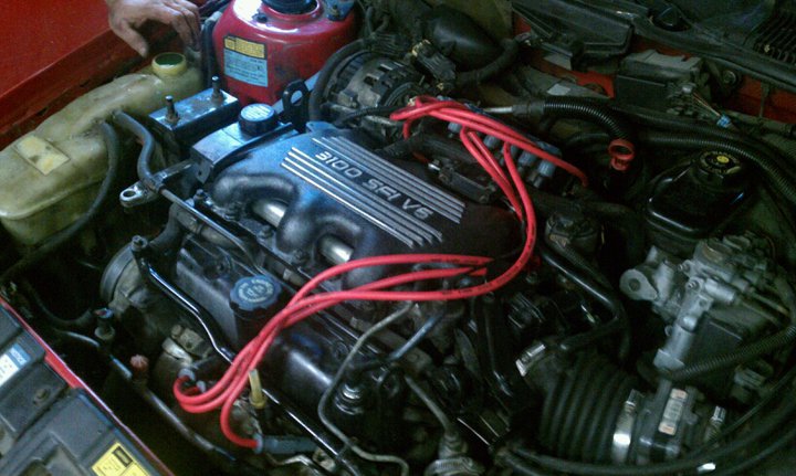

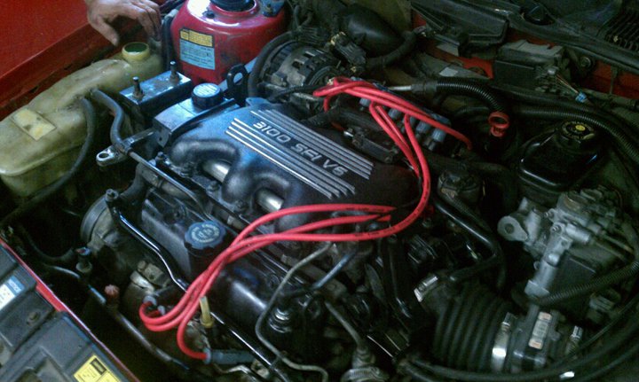

i dont have pics of my multec 2 connectors just yet, thats not really a big deal...but once the motor comes out got some cleaning up in the engine bay and than soldering the multec clips on, extending my ect sensor, and than painting my motor and trans, and than welding up my exhaust, and ill hopefully have my 3500 swap done before bfest. im hoping for a mid 14 with this setup, i just hope that fuel wont be my problem. i dont know if i should go to larger injectors or not.

You should run no smaller than the 2000+ 3400 injectors. Those are 22lb ones and should be ok. They can be increased by bumping up your fuel pressure too if that is 100% necessary and you see IDC's of over 90%

Well ill be using a 55psi regulator that ill be putting im ordering from a member soon. I think theyll be ok, just tell me what I need to do jon lol ill try my hardest to do all the parts.

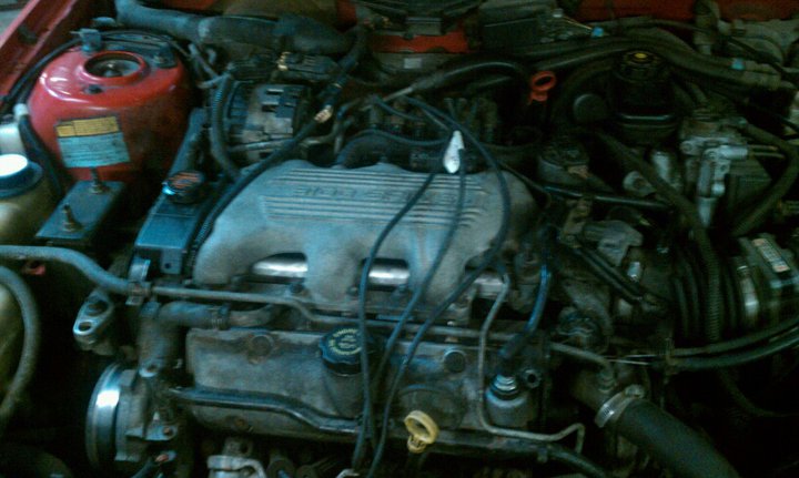

Heres an update for everyone, I bought the car with no radio or speakers didnt know untill I started taking things apart. Well I also found out that the previous owner cut the radio harness so I had to run wires to each speaker did that today. That was a fun job, good thing though even after 171,000 miles no bolts were rusted when I took everything minus the wheel, dash and cluster out. Tomorrow gonna clean the carpet really good, hoping it comes out good, or ill be dying the carpet black.

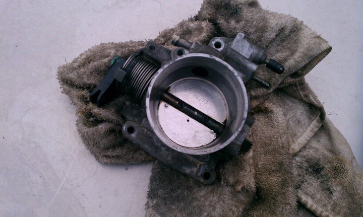

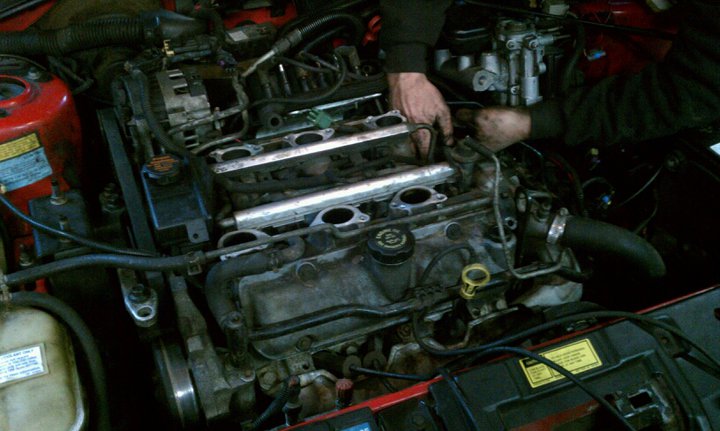

update, even though no one cares lol. next monday im ordering my lx5 adaptor. and than next monday probably my 3100 uim ported to match the lx5. so stoked.

Yes, we have an LX5 TB on it. Your going to put that TB on your 3100? I thought it was for the 3500.

nahh, im getting a street ported one from wot-tech a large port 3100 uim. so yea in a way its going on the 3500 but itll just be a 3100 uim. but it will be ported to match. 65mm to 65mm

That's my adapter that I donated to her engine swap lol =). I miss that thing. I need to order a new one so I can finally use my LX5 tb. Thanks for reminding me.13's or bust wrote:I sent you a pm wicked. Does kelly whitman run a lx5 tb? I have picture of hercar woth the hood open it looks like shesrunning an adaptor of some sort.
