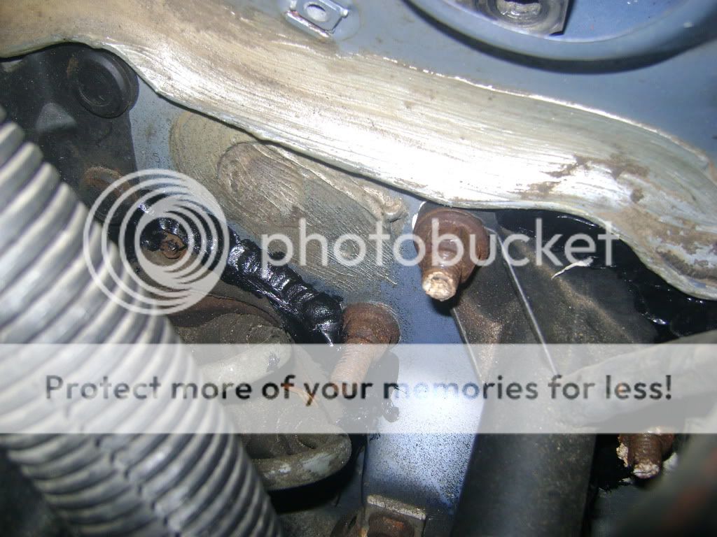

I used seam sealer in that area(shown in pics). And you can paint it. It was from Eastwood.
