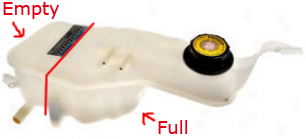

Re: My ongoing coolant woes
there are small passages in that tank and they are obviously quite plugged... you need to pressure flush that side off the car, or just replace it.
I've tried cleaning these out before (swapped to a different tank with one bleeder nipple instead of 2), and you have to be careful with it to an extent... if you shake the crap out of it too much (to clean the buildup inside of it), you can dislodge the magnet that sits inside the tank. The magnet is used to activate the low coolant sensor.
Ask me how I know... lol
These tanks are a PITA. Mine had oil in it from a blown motor and it was pretty hard to get it clean. Just use some soap and a garden hose and flush it like 50 times.
I didn't get violent with the shaking lol. I just kept filling & sloshing the water around until it was consistently coming out clear without debris. There were a couple pieces of nearly dime sized rust that came out, along with several little ones.
Oh, and I made a nice mess since I thought the "out" from the tank was empty. Even holding a flashlight up to it, it didn't look like it normally does when there's coolant there. But sure enough, pull off the hose & it looked like about 2qt emptied out. Caught most of it with a pan before too much ran out. Next time I'll do the smart thing & just drain the radiator first, just in case. So now not only do I have to clean up the garage floor after, but I have to clean up whatever I can of the engine bay.
I think I may skip the full flush for now. It seems like a pain. The kit wants to be tied into one of the coolant lines from the firewall, and it requires a hose to push the water through. In these temps and with alot of snow still on the ground, that's not going to happen lol. I'd have to hook the tank back up, fill it again, and then drive my car like a snowplow across the lawn in 2ft of snow to get to the faucet (which is obviously hoseless in the winter). And all that prior to replacing the pump.
I'm just going to drain what I can the easy way so we can get the pump replaced & get the car back in working order again. I almost think replacing the belt is going to be the worst of it... between trying to get a jack (and 2x4) lined up under the oil pan, and my car being low to the point where you can barely even get a jack under it in most spots. >.<
He knows his own strength. He was just really excited... like a kid vioently shaking those fragile xmas gifts to find out what's in the box.
We drained about 7qt worth. Coolant that came out looked fine, so it should be fine. I let it run till it burped, and then a little bit after, before coming inside to thaw. Still needs an oil change. This oil has... oh... about 10k mi and 8mo on it. Normally I do it every 3k mi.
Couldn't even get the jack under the car without going over by the wheel to slide it under. Even then the jack couldn't get under the oil pan, let alone jack+board lol. I really wish I had just bought an engine hoist a couple years back like I had been tempted to do. It would have come in so handy for things like changing the belt. >.<
