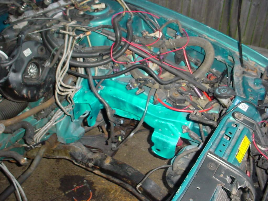

One issue that I am concerned about is the location or the rear mount. It sits 4 inches back from mount I currently use(if my thinking is correct, based on a third gen J). I dont have much room left of frame rail before I hit firewall. Maybe the my motor sits in a difference place than it does in a J.
http://www.j-body.org/forums/read.php?f ... 16&t=36216
^ Pics of the swap from izuzu mounts (same as mine) to getrag mounts.
Heres my mounts. Notice the lack of room behind the last mount. I will have to re route those brake lines.
I guess we will find out. Bolt it to the motor, line it up, and see where the mounts fall
