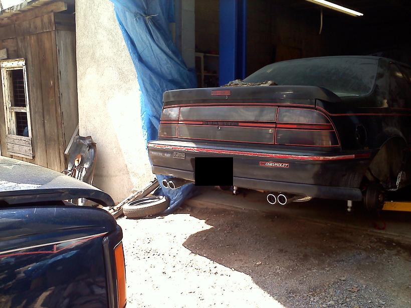

New true dual exhaust with a custom y-pipe and a magnaflow hi-flow cat.. and chrome exhaust tips... car has been totally rebuilt basically from the ground up...any thought or ideas would be great.. thanks!!

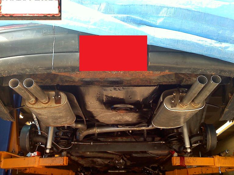

Nice! Any underside shots? I would like to see how you ran the tubing

Yes..I will get a few in the morning...I had to modify the spare tire space by cutting out about 6inches to make a tunnel for the elbow coming out of the 2nd muffler going into the y.pipe and made a few heat shields to cover the fuel tank pipes and the sending unit lines...it took a while as far as planning and fitting...sounds very good...its a complete walker exhaust system except the magnaflow cat...

looks very clean almost stock like a Grand am.

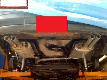

Here is an underbody shot of the exhaust...

What kind of walker mufflers? Do you have the model number? I like how they're dual outlets.
Posts: 1775
Location: Long Grove, IL
Re: New Dual exhaust
Post by Cliff8928 »
They look like stock replacements. In effect you could get a system for a 92-95 grand am and it would bolt right on and look the same.

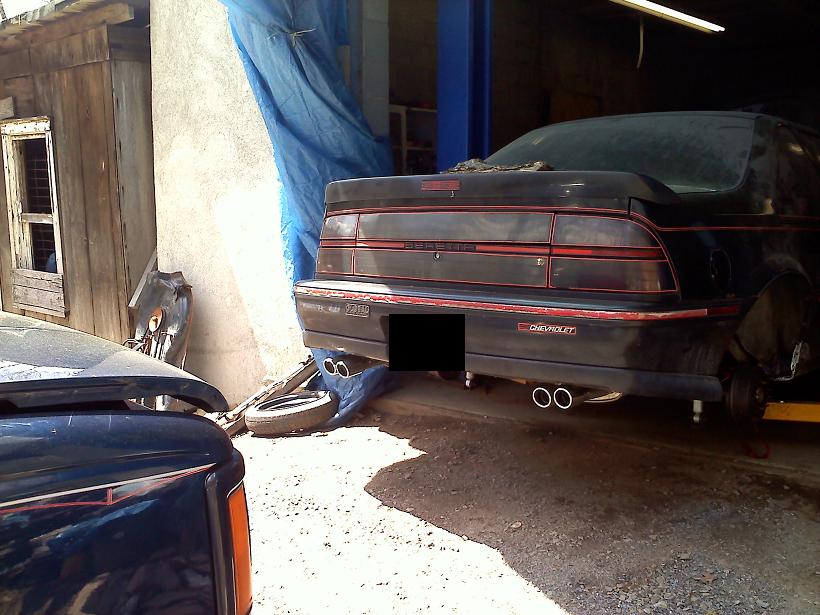

This is what I did.
Gave a guy I know who run a shop the muffler and said make it fit dual exit, but don't cut the car, and don't hang the sucker below the spare tire well as some had.
I used the square tips which blocked the visual of the muffler on the left hand side a decent amount so you wouldnt notice only one side had the case. Also I should have painted it black like the system I have now, but oh well.

Jack the muffler part # is 18203.. walker soundFX muffler...
