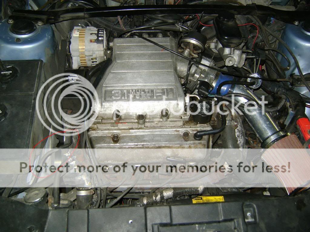

Post by beretta »
circled in red is the line going to the canister... it can easily pull apart there, especially if your engine mounts are not great.
If you look below the throttle body at the 1st line that runs down it T's into the fuel pressure thingy the other line is the canister, and one comes out the back to the firewall to the map sensor then runs inside the wire harness and in under the glove box to the heater control, not many lines to trace....
