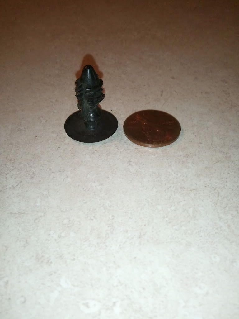

Okay everyone my thread got completely attacked with posts so im here to update on my cowl situation
I went out and bought 3m windshield sealant and man that stuffs sticky lol. I took off the cowl and vacumned it out and apploed the sealant everywhere i could even near the windshield hoses etc anywhere i could think that had cracked sealant. I also put some where the windshield was at the bottom where the cowl piece is. ( it.doesnt smear)
All went well applied what i could it should be better i did break the plastic cover things that hold the cowl in place , what size is it lol?
I broke 2 of em
Also please no arguging i just want to get a little more info and give an update
Also those arms were not fun to take off lol!!!

The head on the plastic push pins are about the size of a penny, they stand just about an inch tall, and should work for a 3/16-1/4 inch hole.

Napa sells those new. Cheap too.
