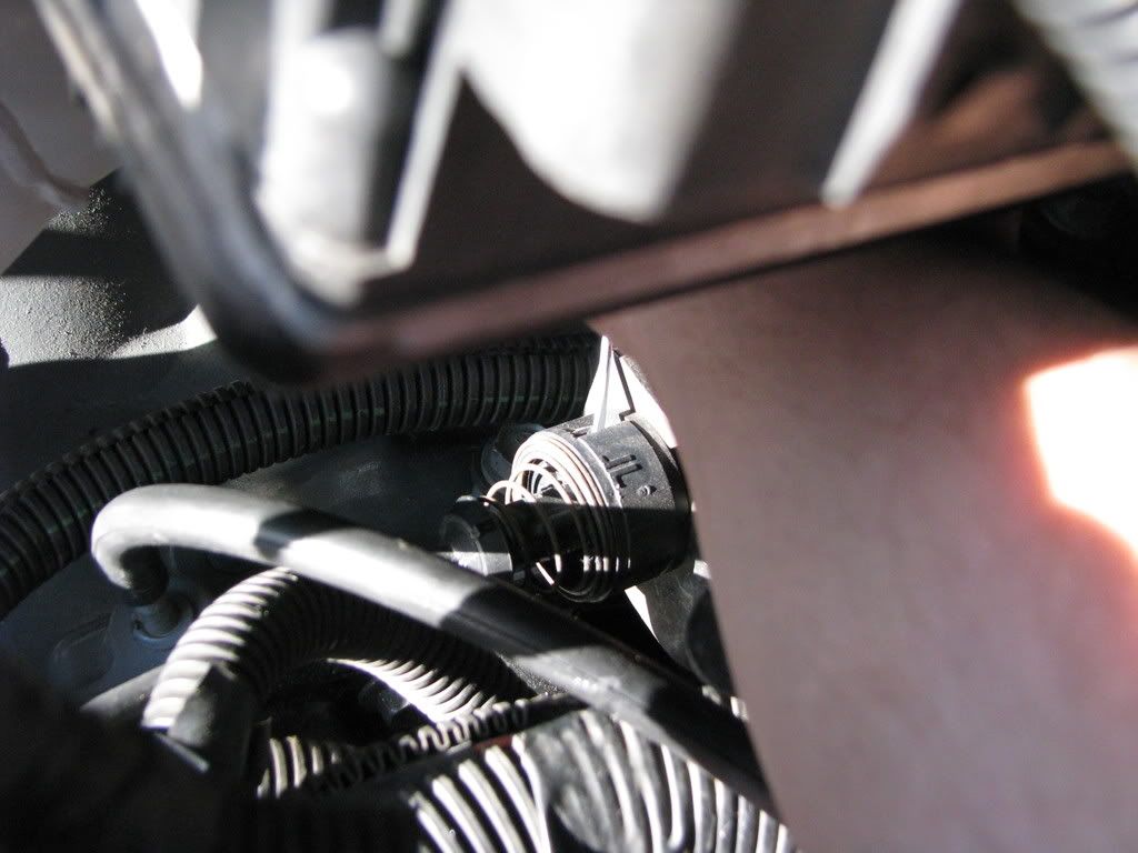

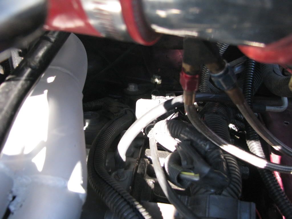

- Posts: 10919
Re: 4t60-E O/D issue.
here is the cable adjuster part.
wedge in a small scredriver and get it to lift,
Pull it all the way up like this.
Make sure the cable is pushed in as far as it can go, Park is the lever facing toward the firewall, so make sure thats positioned in the right spot too.

- scd88ga
- Posts: 1828
I guess I get no thanks!
Jon, thanks for elaborating on my reply with all the details and pics! I could have gave a description of what to do with the cable, but without pics included, it would have been rather useless. I tend to be much better at hands-on when it comes to showing somebody how to do something as opposed to putting it down on paper anyway (it runs in the family). I figured you would chime in, so I purposely stayed vague with my reply.
Good luck SGR! I hope it's a simple fix!!!!!!
I actually ended up removing the upper plenum to get to the adapter gasket as it was DEFinitely the easier route to get there. New gasket is in and I studied how to get to that cable from above on this car and with that monster motor and all it's parts crammed in there, yeah.....
Simply put? No fucking way.
I'll have to see if I can get at it from the bottom or something.
I appreciate EVERYONE'S help. Thanks. Still not finished with this problem until it's fixed, it just may be a day or so.
