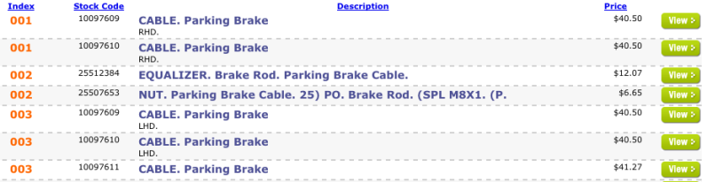

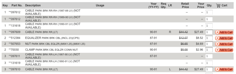

Can I get an expert to steer me to the correct two rear parking brake cables for my GTZ because it appears that there are four different part numbers? I ordered the the two listed from Rock Auto and either both are wrong or just one of them is wrong. I am leaning towards the RR (#1 on the illustration) being incorrect because the cable I have doesn't include the piece that snaps into the equalizer.

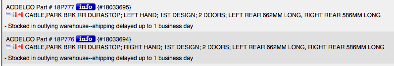

These are the Rock Auto #'s

There is no piece on the RR that snaps into the equalizer, the main cable threads through the equalizer and then connects to the RR cable, part #23 pictured up there is simply a cable connector that holds the barrel from the RR cable and the barrel from the main cable coming back.

As you can see here, the two cables I got from RA are obviously too short then
Anyone have correct part numbers?

No, both of those pictured are look to be 100% right, where is your main cable in that photo, and the equilzer?
The last photo I posted RIGHT above the sway bar bushing is the coupler that connects the short left to the main cable running up to the handle, that cable is snet through the equalizer and then the other side of the equalizer is threaded with the nut to the RR Cable.
1st Design numbers are
LR Cable - ACDELCO Part # 18P777
RR Cable - ACDELCO Part # 18P776
Equalizer - DORMAN Part # 21121
Main/Front Cable - ACDELCO Part # 18P1657
For some reason RA has the LR and RR mixed up for ACDelco's numbers for the second design... at least thats what I make of it...
From looking at yours, the threaded version is on the RR, which is the same as me, yet RA calls the LR for a 96 the one with the threads. Seems odd, but I know the difference between the two is inside the drum on the old style was just a barrel end, the newer ones had a hook that hooked on to the park lever part of the brakes. I don't know if there were any other differences... But the image you posted at the start showed the main front cable going to the LR of the car before exiting, where mine it exits on the RR... I can assume if the cable came from the left you would have to reverse the two rear cables to get them to work properly.
