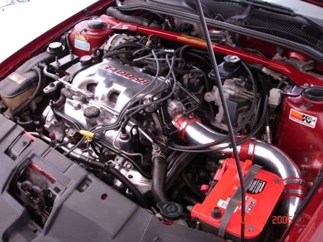

Re: tranzgenic CAI routing?
Yes, a bit of battery relocation is necessary in most cases. As Jon said, especially for square ended batteries like mine. Man, I need to rework that intake. Think I'm gonna start by getting rid of those horrible blue couplers lol. Then a new battery.
COOL.
Nice engine bay snowblind. Should have put some paint on the TB linkage, looks out of place.
I'm putting a 65mm TB on this spring, so I didn't think it was necessary at this time lol.
1991 Beretta GTZ
I see your point, but wait....you are still going to have to swap the linkage right?
