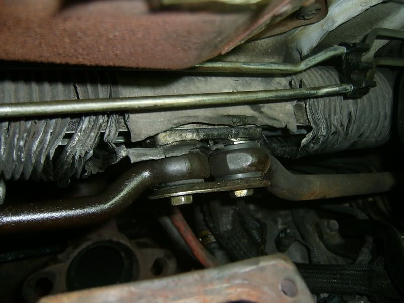

Then I would go to the PS pump if it did not change. The PS pump was the source of my sqeel a couple of years ago and my rack was still Fd looking but worked like a champ. They are very durable.
It has been replaced since this photo.

Check the rack itself. Mine was busted up, and leaking. Replaced it, and it's all good.
If it's a PS issue, your hearing like, groaning right? Or is it just squeaking as you driving straight, or with the wheel slightly turned to either side? PS groaning, and squeaking are completely different things. Could be a rack, or pump, could be the bushings, but if you replace the rack, replace the pump also, and flush all that crap out! When and if the rack is shot, the rotted crap, from the rack can cycle itself through the pump, and make it hell to turn, and cause all kinds of noises and odd feelings while turning. I'm going off of my experience with my Z26. Maybe your problem isn't this serious, but inspect you rack first.
