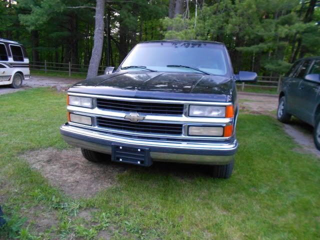

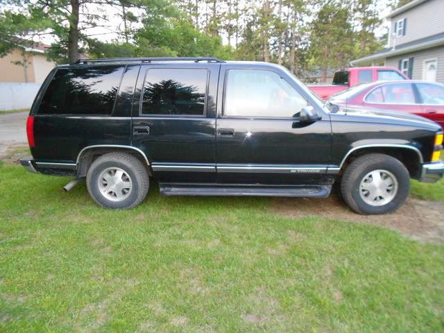

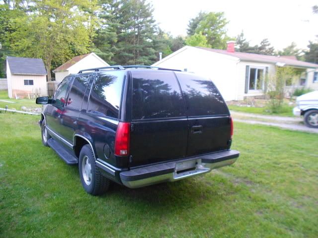

A little overview about this. I've always loved the 88-00 trucks as long as I can remember. My mother, father, uncles, grandparents, cousins, and myself have owned quite a few of the trucks over the years and I really don't think their value can be beat. They have sufficient power, look great, are comfortable, and the parts for them are cheap. My goal for this truck is to have a good looking vehicle that I can take on trips, but also use as a daily driver. Plans are:
2/3 drop
LED taillights & new headlight/parking lights
New wheels/tires
Debadge
New black paint
Magnaflow exhaust

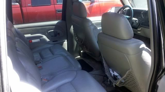

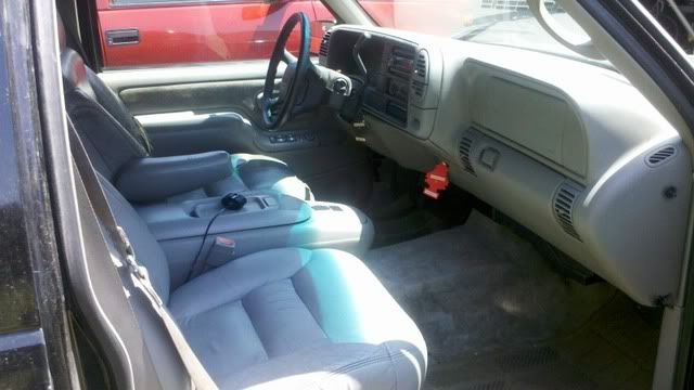

Its a Texas truck so there is no rust anywhere, thank god. The exterior of the truck looks good from 10 feet away, but as you get closer you see the imperfections. Whoever painted this taped off the windows and sprayed paint everywhere else. The original pewter paint wasn't even scuffed before being painted over. There are a few dents, but its a 13 year old truck. The interior is a bit dirty, but I have high hopes for it. The front seats may be getting reupholstered whereas the back seat just needs a good cleaning. The audio in it right now is too loud. The P/O installed 4 12" subwoofers, 2 MTX Audio amps, JVD headunit and a capacitor. I just want to go with the stock headunit and decent speakers.
I ordered 2" DJM drop spindles today as well as a new impact strip for the front bumper from LMC meaning the project is started. Its going to be a slow process.
I have a few questions right off the bat. Will the stock headunit with the CD Player incorporated into it from a '99-02 fit into my '99? I mean are the plugs in the back the same?
I can't find 4" drop shackles anywhere for this. I also can't find 1" drop springs for the front. Can anyone help me out?
Here are the photos I have for now.

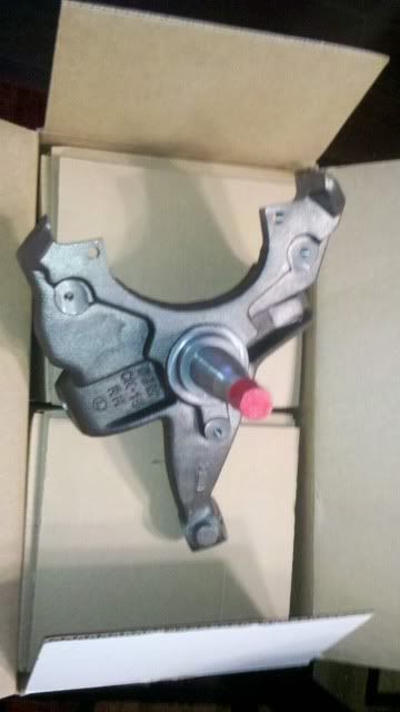

DJM Spindles came in yesterday as well as the front impact strip from LMC and the Belltech drop springs.

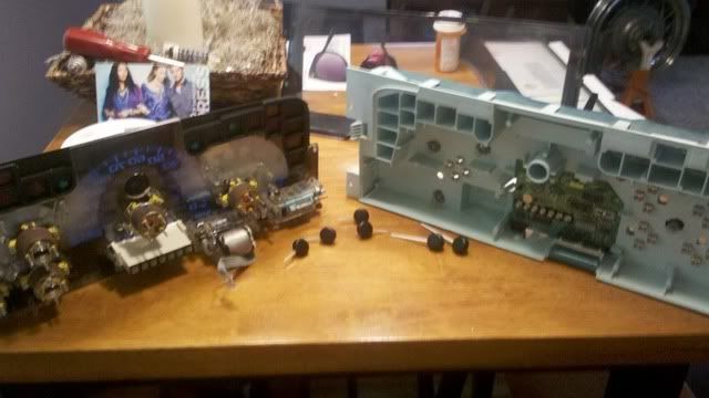

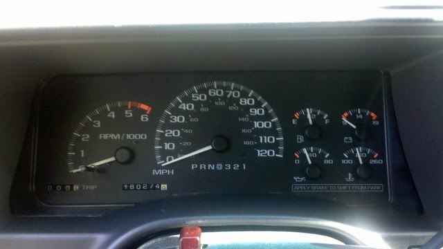

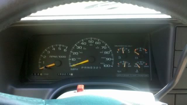

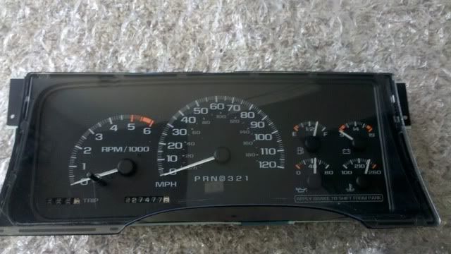

Well part one of the Denali/Tahoe Limited interior started today. I bought an Escalade cluster off of eBay for $70 shipped and installed it today. Also bought the chrome door handles for $8.95 each for the interior.

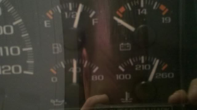

A photo of the old cluster. The needles were faded and the gas gauge shook like crazy.

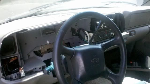

After I removed the trim bezel around the cluster.

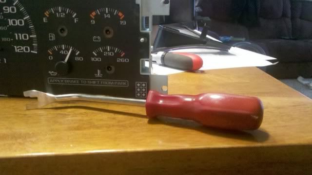

Be sure to take a photo of these four gauges before you remove it in order to install the needles in the correct position when you're done.
This tool works great for removing the needles without risk of breaking them.

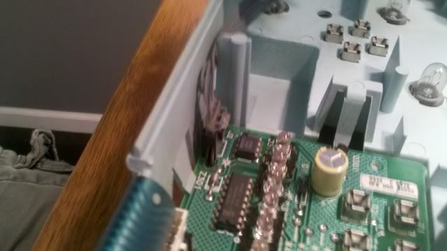

This has to be unplugged before the face of the cluster can be completely removed.
Here is what it looks like when seperated.
This is the odometer roll. The two gold colored screws are all that have to be removed and the odometer roll can be changed over to reflect your current mileage.
Here it is finished with the correct mileage.
