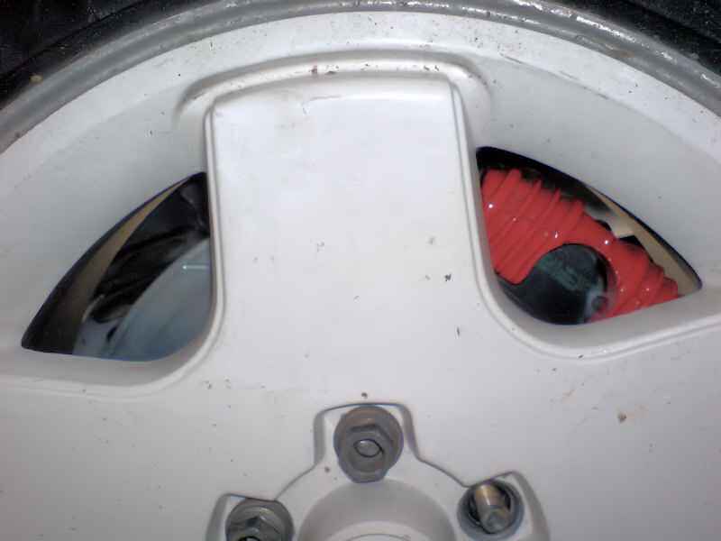

Here's a pic of 12" disc and Vette caliper inside of GTZ rim:

Yeah, i thought about the same for the rotors... should be pretty easy to get some decent ones. From what corvette is that caliper? its the one you have on the rear right? Should i see if i can get a wilwood caliper or something from other GM cars? Too bad car shops dont have performance parts but i can test a cheap VAG rotor if it will fit the 15" rim.
