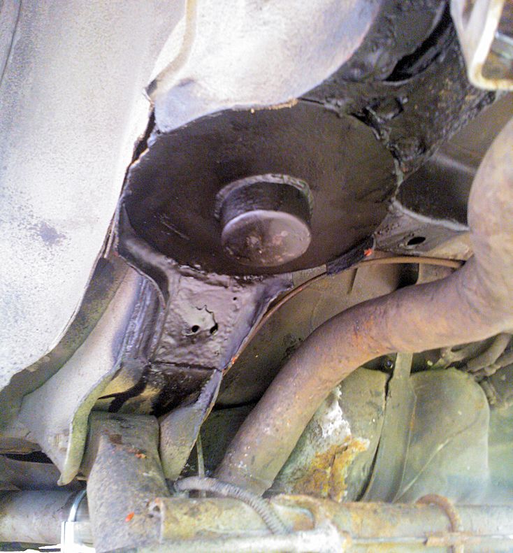

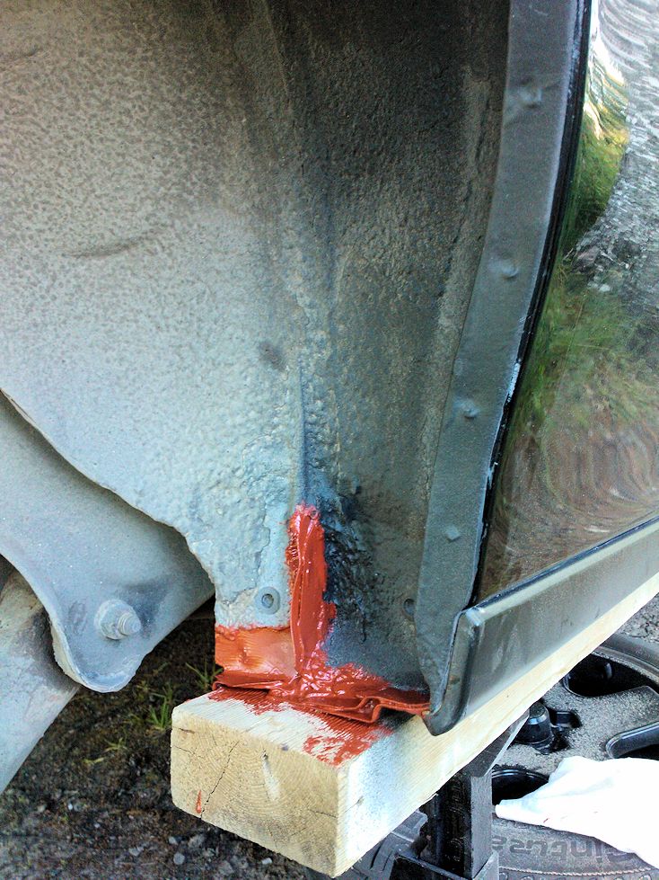

Here's what's left of the drivers side upper rear spring support, after using power tool to removed everything that's not solid...
This thing was like paper, much worse than passenger side.
Work in progress.
Before this picture, I sandblasted everything, this is with first layer of primer, then there will be base coat, stone-hit protector, cavity wax and underbody coating.

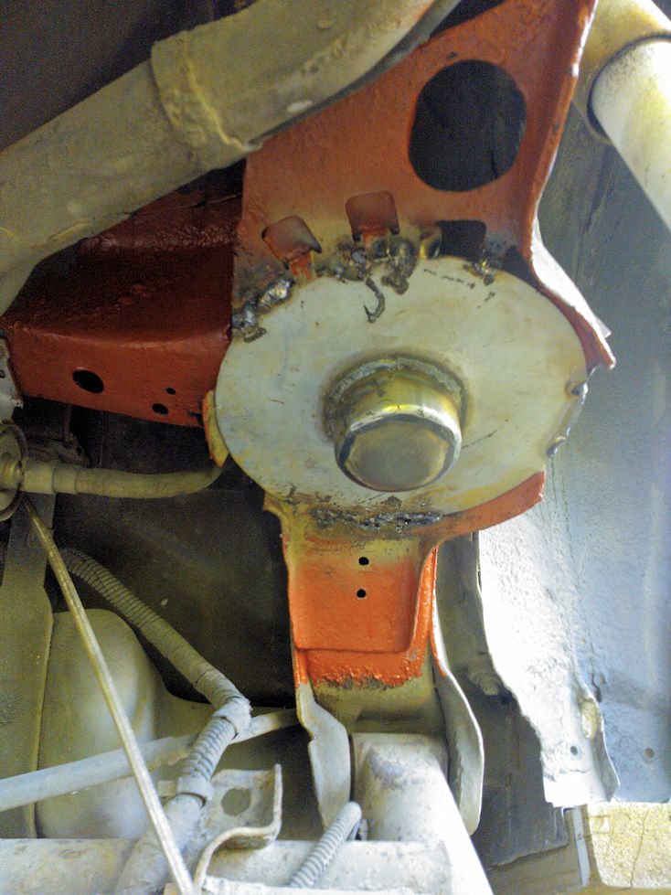

The 100% correct way to fix this, would be removing the whole factory piece and hand crafting replacement to match it.
This will do for what's left of the car's life tho.
I had to cut away the rotten parts, they were not salvageable. The rest was sandblasted.
This area of the car was also done back in 2007 when I bough the car, now it was time to re-do It.. no stopping cancer, just slowing it down.

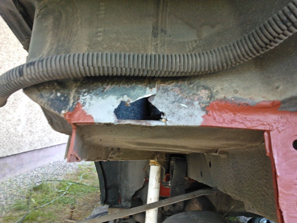

Power tool found this hole from the trunk

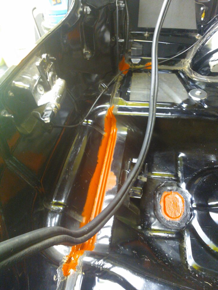

There were rust spots there, fixed them too.

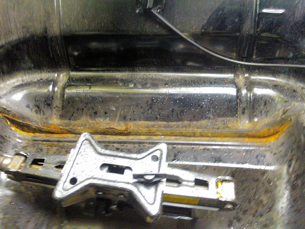

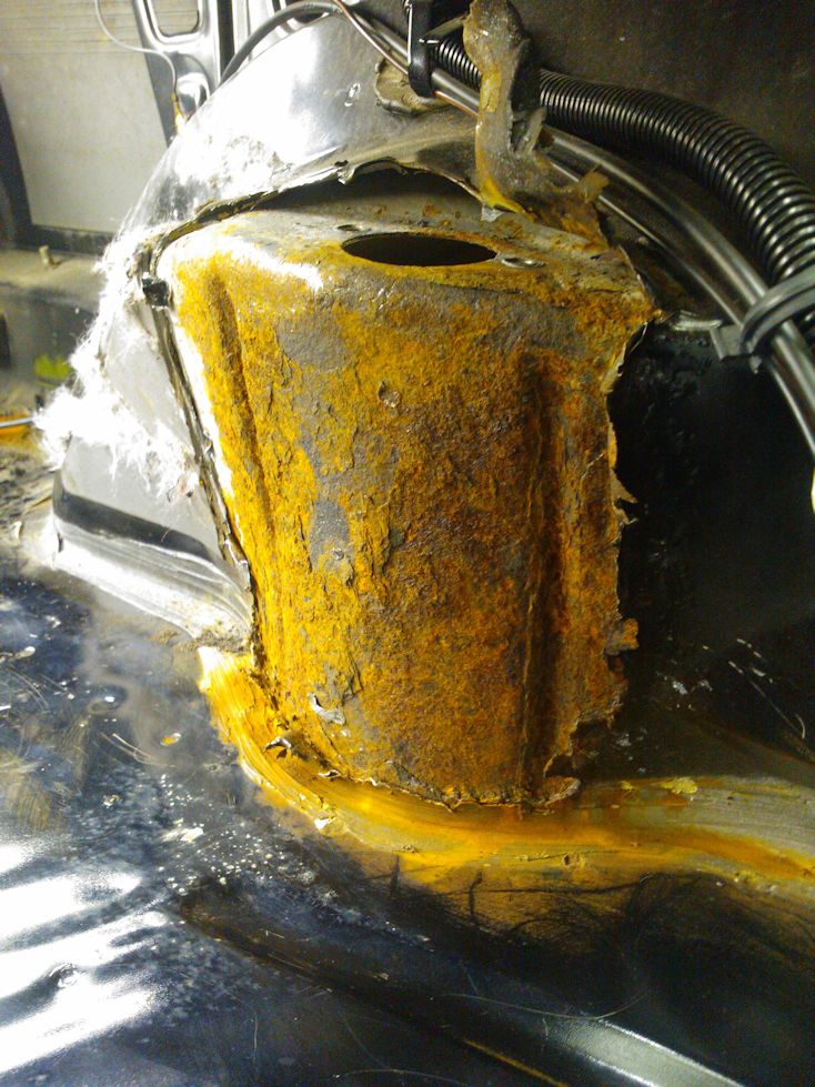

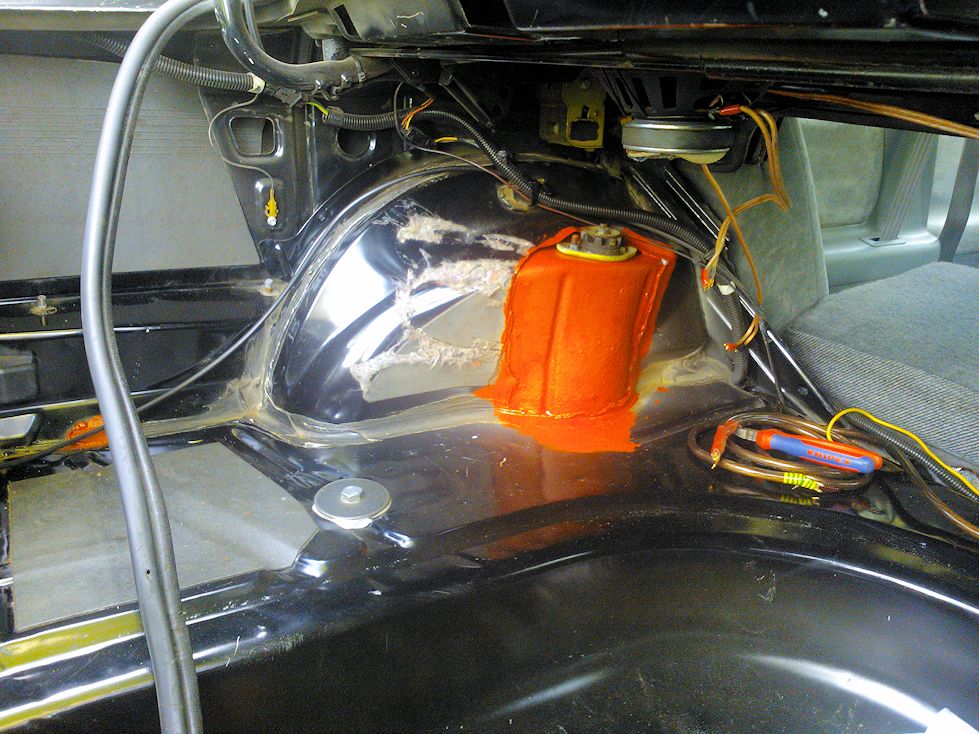

Slight rust issue with driver side shock tower. I actually noticed this several years ago... it was just a few spots back then. This is after all non-solid is removed...
Also rot here, sorry for the crappy picture.
Work in progress.

Next time you are in the states, if you come back to the Midwest Im going to teach you how to weld. lol.
My Motortopia
Re: Life extend for daily driver...
Had to Arc weld those, since that's the only alternate I have to TIG. Not pretty, but functional.

Looking good. The most important part is the frame rail above the spring perch. As long as that's still solid just weld a new perch on and keep driving, as I see you have done.

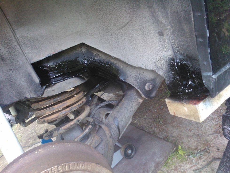

Totally forgot that I had this topic, sorry for much delayed update.

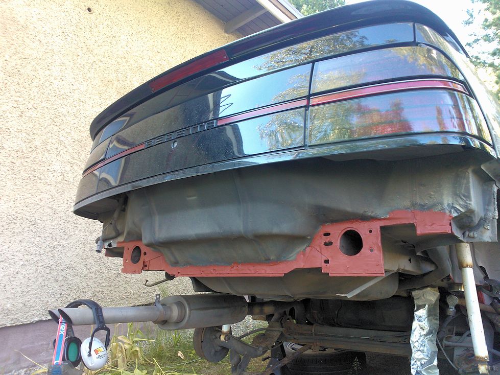

Deezil, Yes I sandblast my self. I'm using rust-preventing primer that's not ment for cars, but to my experience works extremely well. Applied with brush so I get thick coating. After the primer I use paint that is ment for metal roofing.
After primer and first apply of black paint.
After all the layers of coatings, when it gets dirty, it will look just like stock.
I'm still wondering should I build additional reinforcements to shock towers, so this one is still primer only.

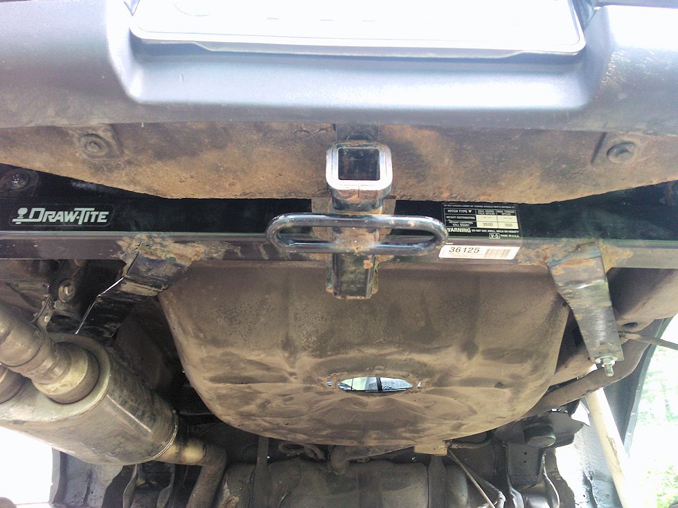

I installed another one of the spare towing hooks I had laying around, still need to find wiring set in acceptable quality. Btw the european trailer wiring is about four times as complex than US wiring, lot of work...
I do have upcoming non-car project that will require plenty of hauling big and heavy stuff with trailer so this will be much needed then.
