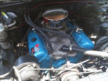

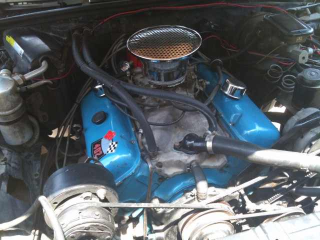

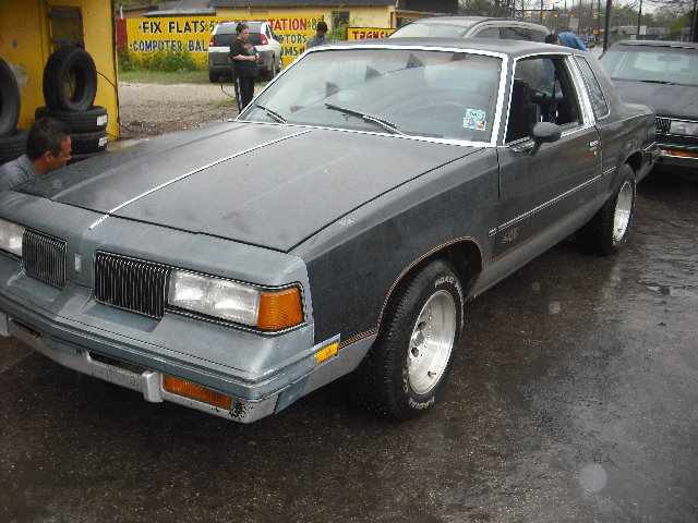

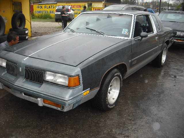

forgot to add my bros project finally gonna get around to install this beast of a engine
its 86 cutlass 442 all bells and whistles that came wiith it that year dark metallic blue with euro front kit installed
had a 350 rocket traded to upgrade to this 396/402 and 400 trans
that thing is a beast best run keep in mind that it was column shift auto was 14.36 @forgot mph
but damn sick engine
i got a cutlass too but selling it cuz dont have the money to put into it and 84 salon 350 rocket

Re: z24/z26
Tell him to get rid of that junk air cleaner. The only thing that does is filter out rocks.
I'm sure he could find a good drop base and put a K&N on.

Re: z24/z26
well thats how the engine came with filter the previous owner had a piece of foam sitting in there he bought a holly filter kit for it im just installing the engine and trans for that car
its a pita cuz it has solid mounts that the base has to be welded to the frame have to get it right the first time

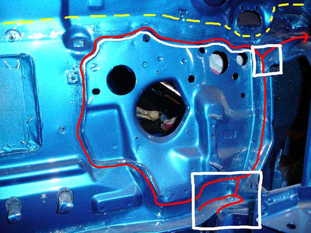

just drove the 96 z26 and left turns flash faster than the right side i dont know its first time its ever done that
also has the dreaded interior leak already got info to fix on this site
and wanted to ask about window sweeps and rubber around the the door are there any oem replacement or is sort of hope to god u find a good set

Re: z24/z26
ill check the bulb and then the flasher
the leak is on the driverside but i actually found yesterday by mistake i was installing wipers happened to look down and saw the urethane all cracked around the rack found it cuz i saw this pic originally was always looking at the cowl for some reason never saw this pic till i got to this site
and i tried looking them up gave up a bunch of times i guess i take some real search to get to find them thansk
b4 i forget on the leak whats the best way to fix it i heard it was urethane not shure though

- Posts: 885
Re: z24/z26
if you mean on the firewall around the rack then i had the same problem. i coated that area with plastidip, problem solved. popped the hood and used a large turkey baster to squirt some along that area starting as far down as possible and working up. that space was too cramped to use any spray or a brush so the baster worked well. i also put some around the drain flap under the cowl. it appeared to be in bad shape so i figured why not do it while i was there. it was clogged with the leaves. after that i pulled the carpet back on the driver side floor to let everything dry, cleaned with carpet cleaner, and called it a day. a seven dollar fix. check that whole cowl area for holes and bad areas.

Re: z24/z26
k so i ve heard of this plastic dip but never used it b4 any info of where i can get it
if aint broken upgrade it
- Posts: 885
Re: z24/z26
any hardware should have it. it comes in a spray can and a dipping can. get the dipping can if you plan on doing it without removing any parts. theres no way to spray anything down there without taking off a few odds and ends to make room. most places sell black and maybe yellow but it comes in red and white as well.
