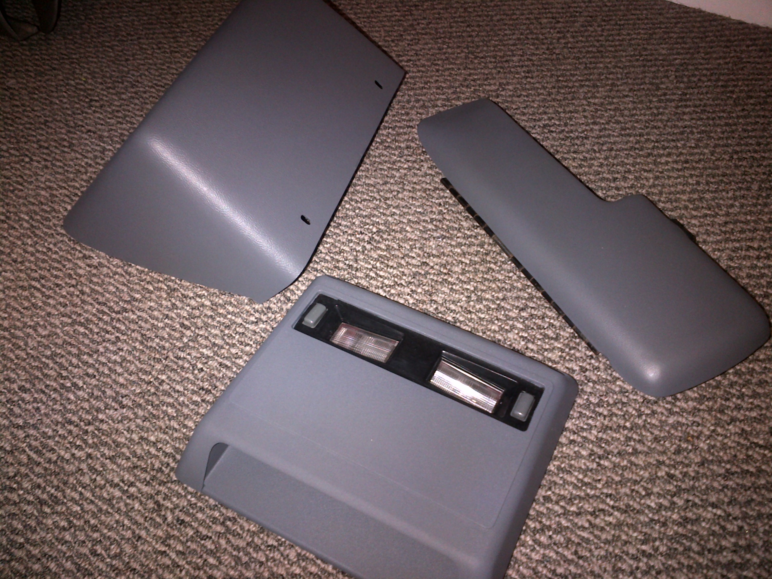

I used dye on some of the interior plastics and to repair some door panels had excellent success with the product and after a couple weeks to try is very hard to remove. Its all about prep and cleaning first, i used 99% rubbing alcohol dish soap lots of water and dried very carefully before applying very very thin coats. Most of the parts I started with for a test were red but will be installed into my 89GT when doing the GTZ interior swap, as they turned out quite nice.
