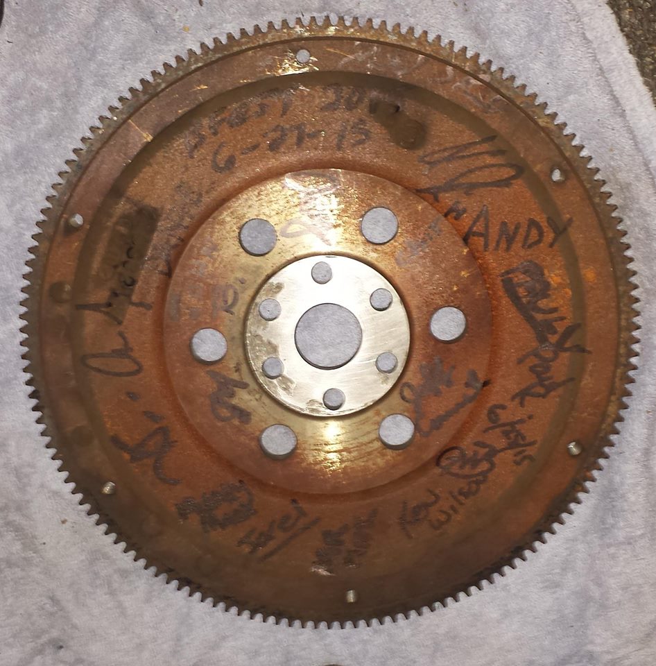

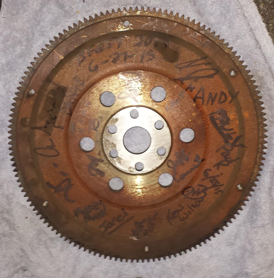

After the group photo at Bfest I left the parking lot pretty quick - After letting off of the gas the car developed a horrible knocking/bearing noise. In summation, the flywheel bolts came loose. On Saturday night myself, yellow3800, themixer, and 3X00-modified (and like 15 others!) pulled the transmission to get to the flywheel bolts and re torqued things down. After the fix, everything was fine and I was able to drive the car home without incident.

I was very lucky to have a group present - I was so frazzled from troubleshooting the car during the weeks prior that I don't think I could have handled the added stress without the help. Oh yeah, and most everyone who was around when we got the flywheel out signed the back of it -- pretty cool moment. Found out later some missed out on the signing... :(

That is so kewl that all the folks signed the flywheel!
THAT is a photo that will be a B'Net keeper forever!

Wow, now you have to get another flywheel! Names to the inside I hope.

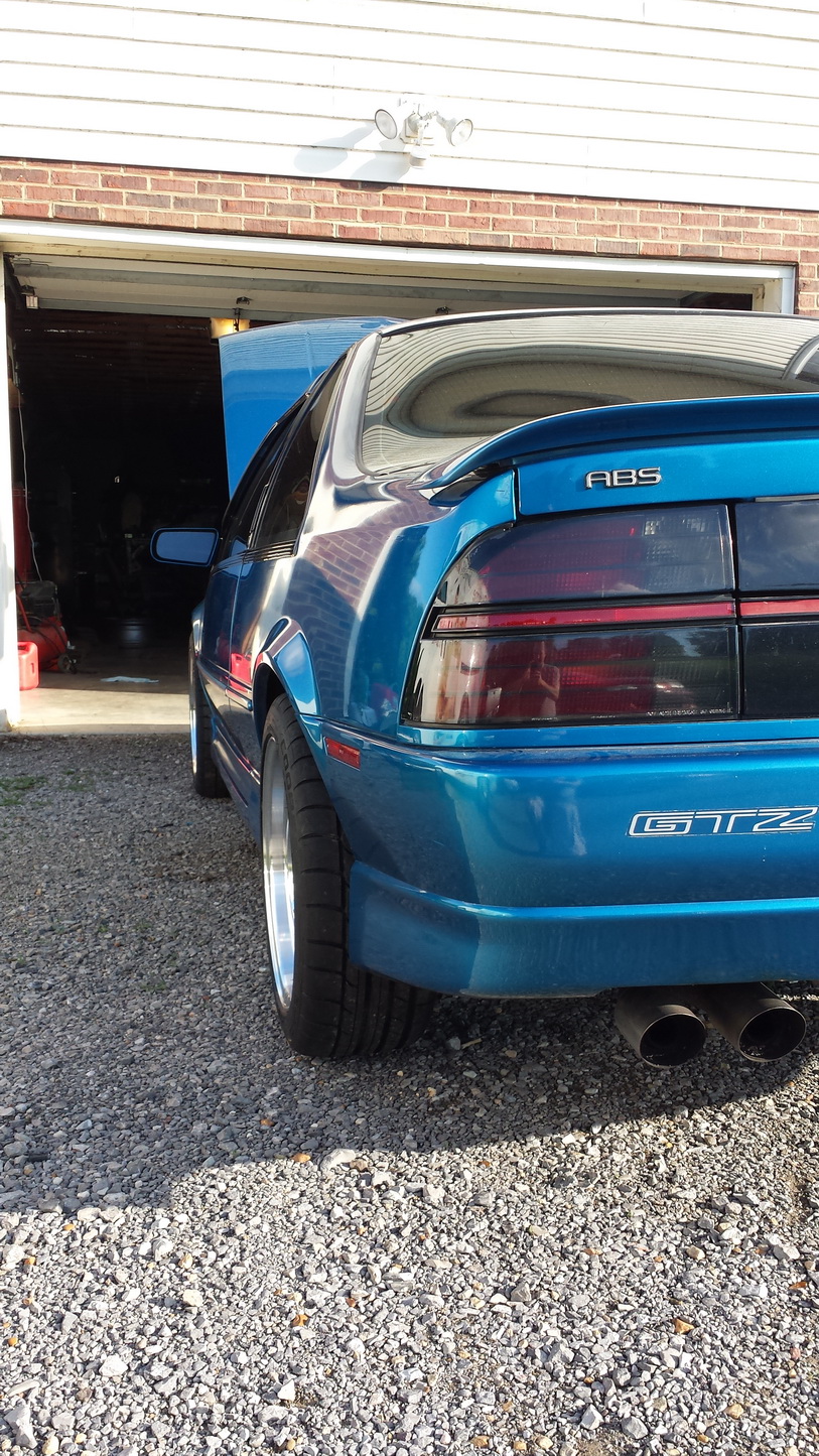

Spent a bit of time tonight to install the MRZ lower dogbone mount. Not sure it's going to do much at the moment, but it was a shiny part that has been sitting on the shelf for months... :) Don't mind my decaying brake hoses... those will be replaced when the Wilwood kit goes on.
Also thought I'd include a teaser shot of the new rotating thingees... Not ready to do a reveal yet, but stay tuned...
