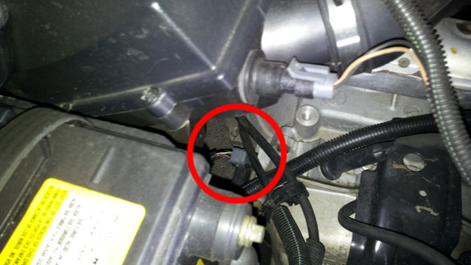

Re: Trustworthy Mechanic
look, here is the plug
**edit**
just below the air filter box
it's maybe a PITA to unplug it, so it was in my case
**edit**
