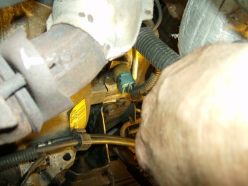

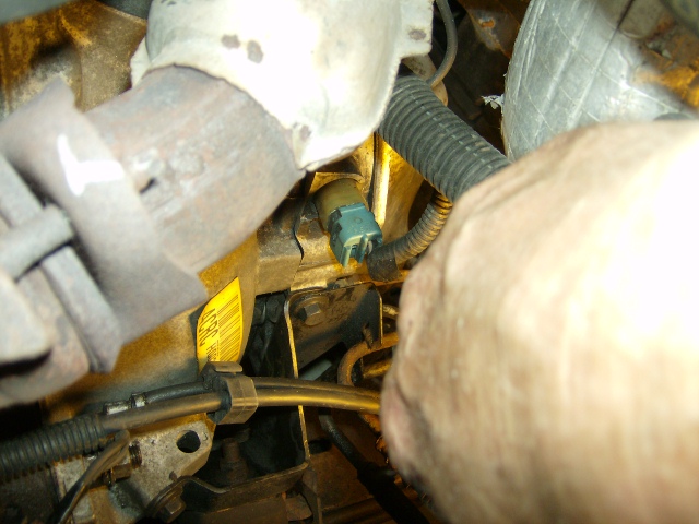

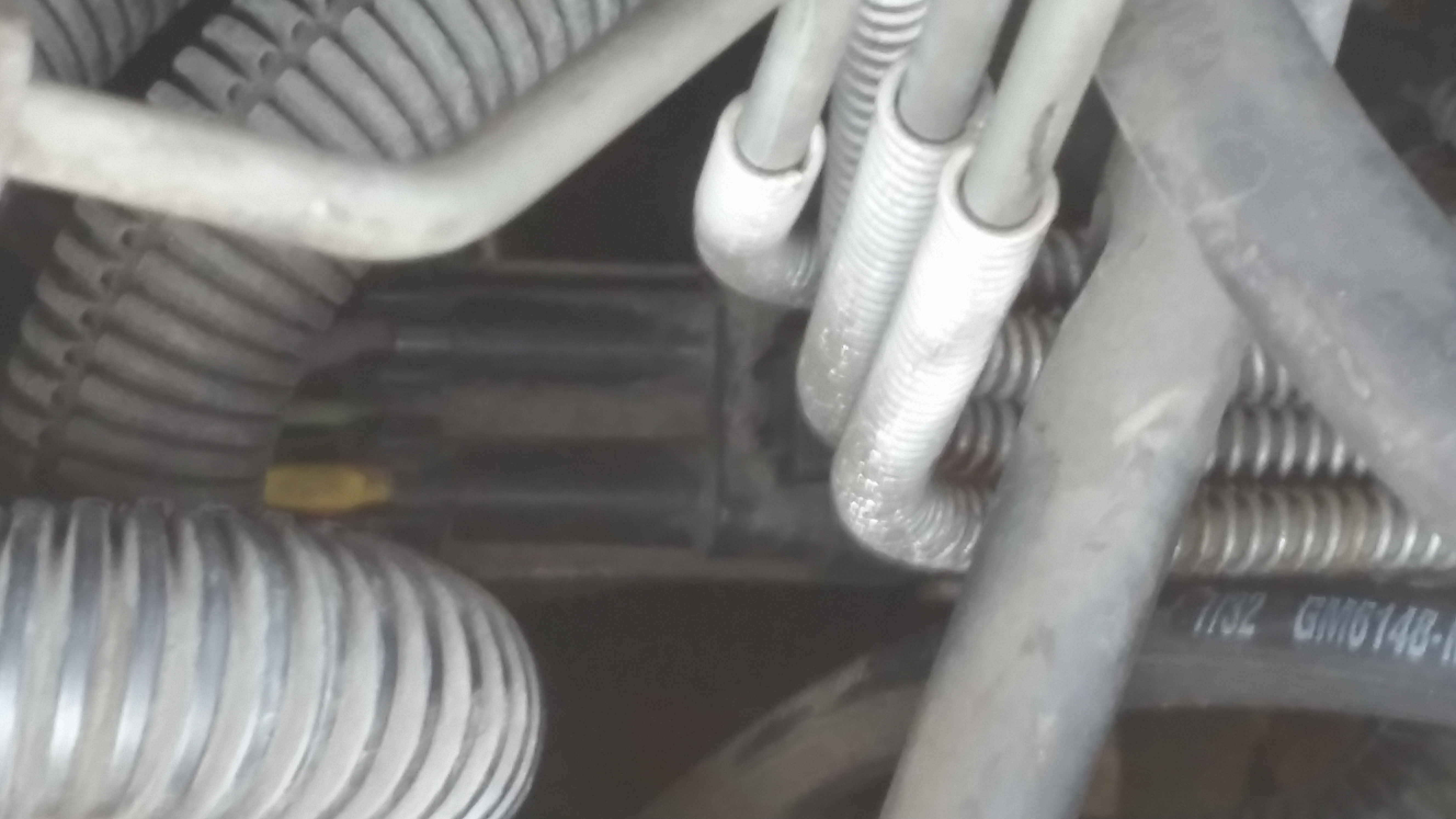

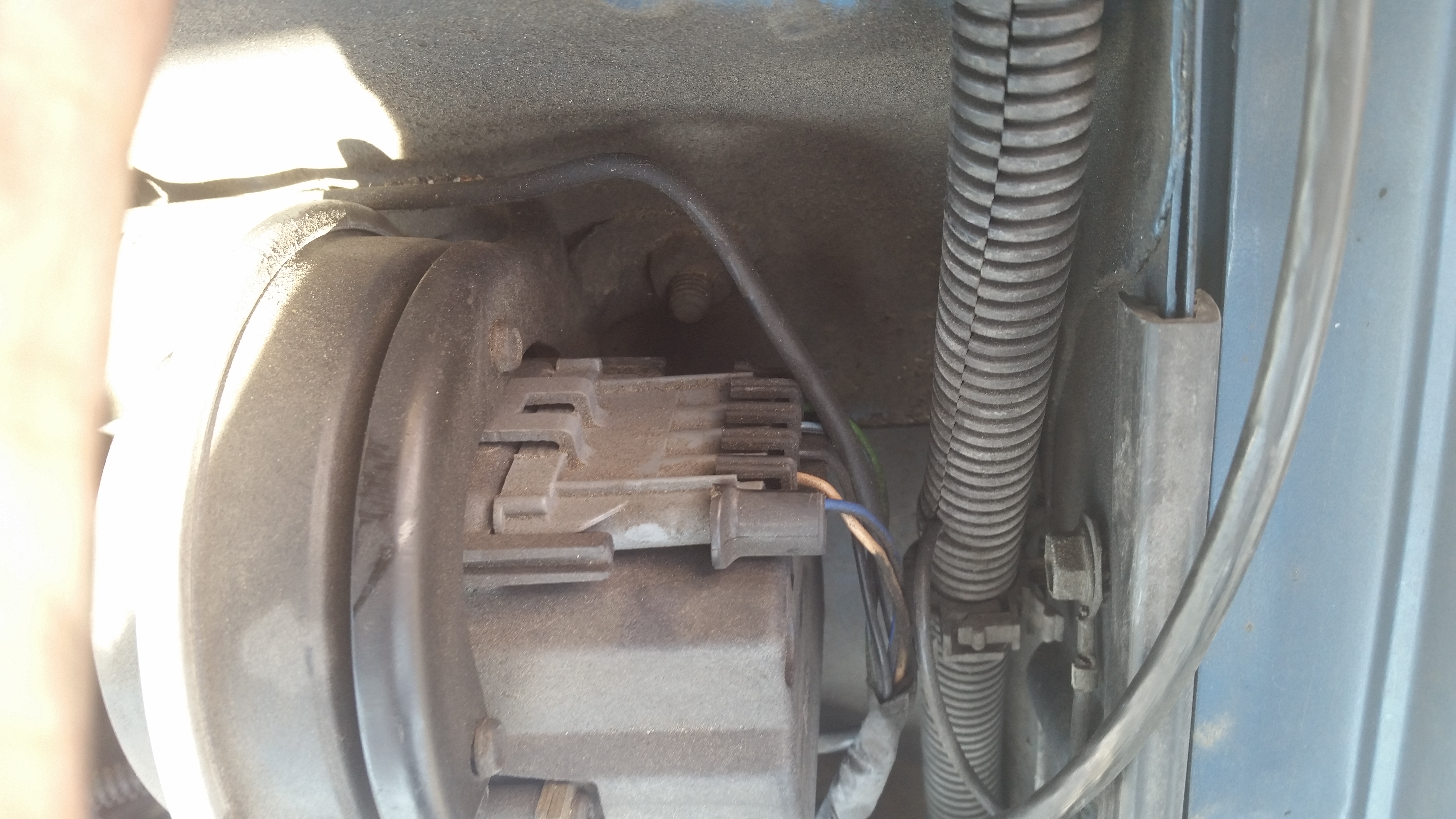

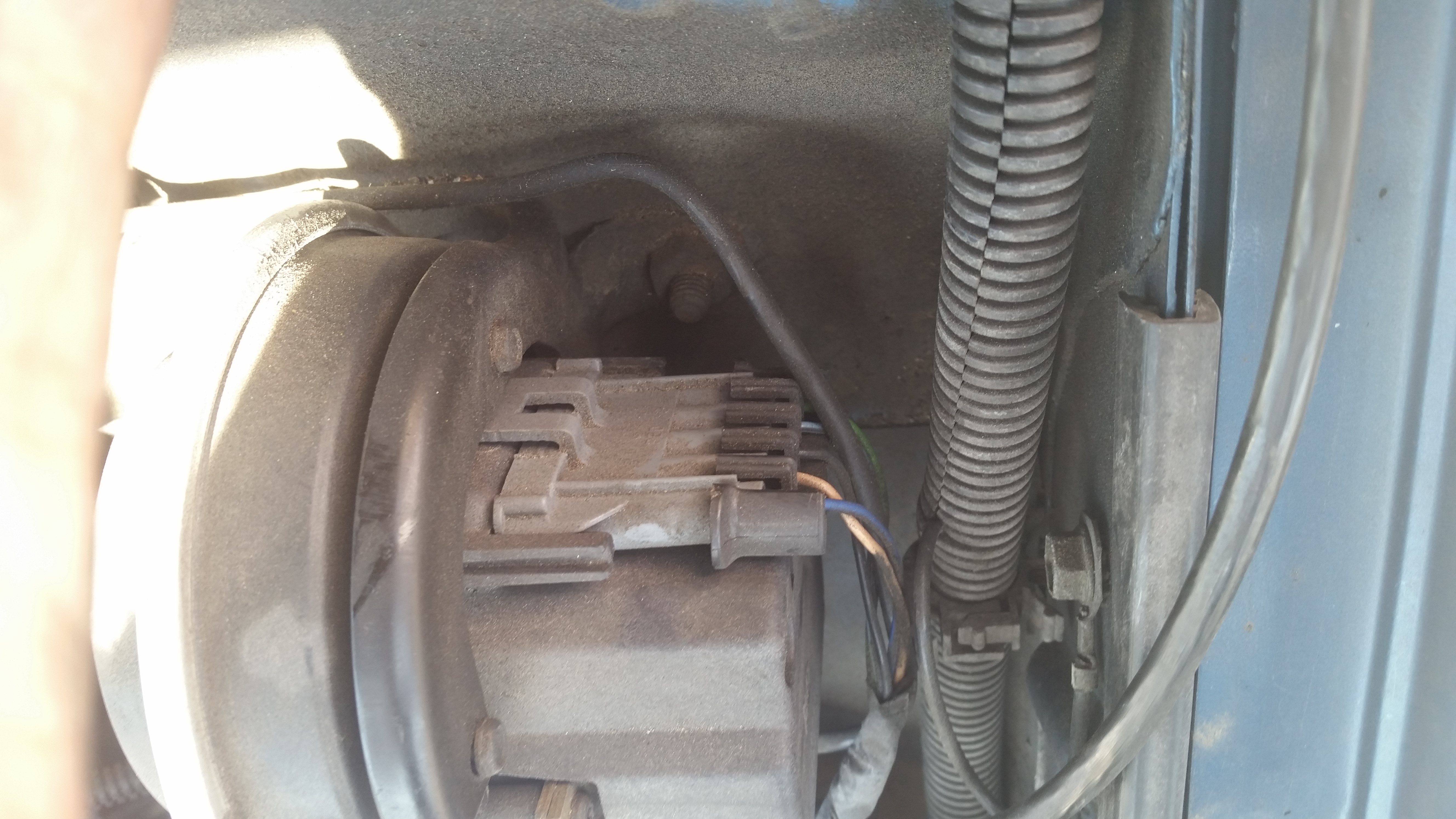

Re: Trustworthy Mechanic
Ok so I went to go and disconnect the Square plug and I want to make sure I am unplugging the right one. Is is #1 #2 or #3?
As you can see each picture is numbered. Sorry to keep bugging you guys and I want to make sure before I unplug anything it's the right one.
Thank you!
Thank you!
None of those pics have the plug in them.
I have the same trans in my mini van.
Here is a pic of the plug on mine. It's the blue one.
It's down on the bottom on the transmission
you may see it better from underneath.

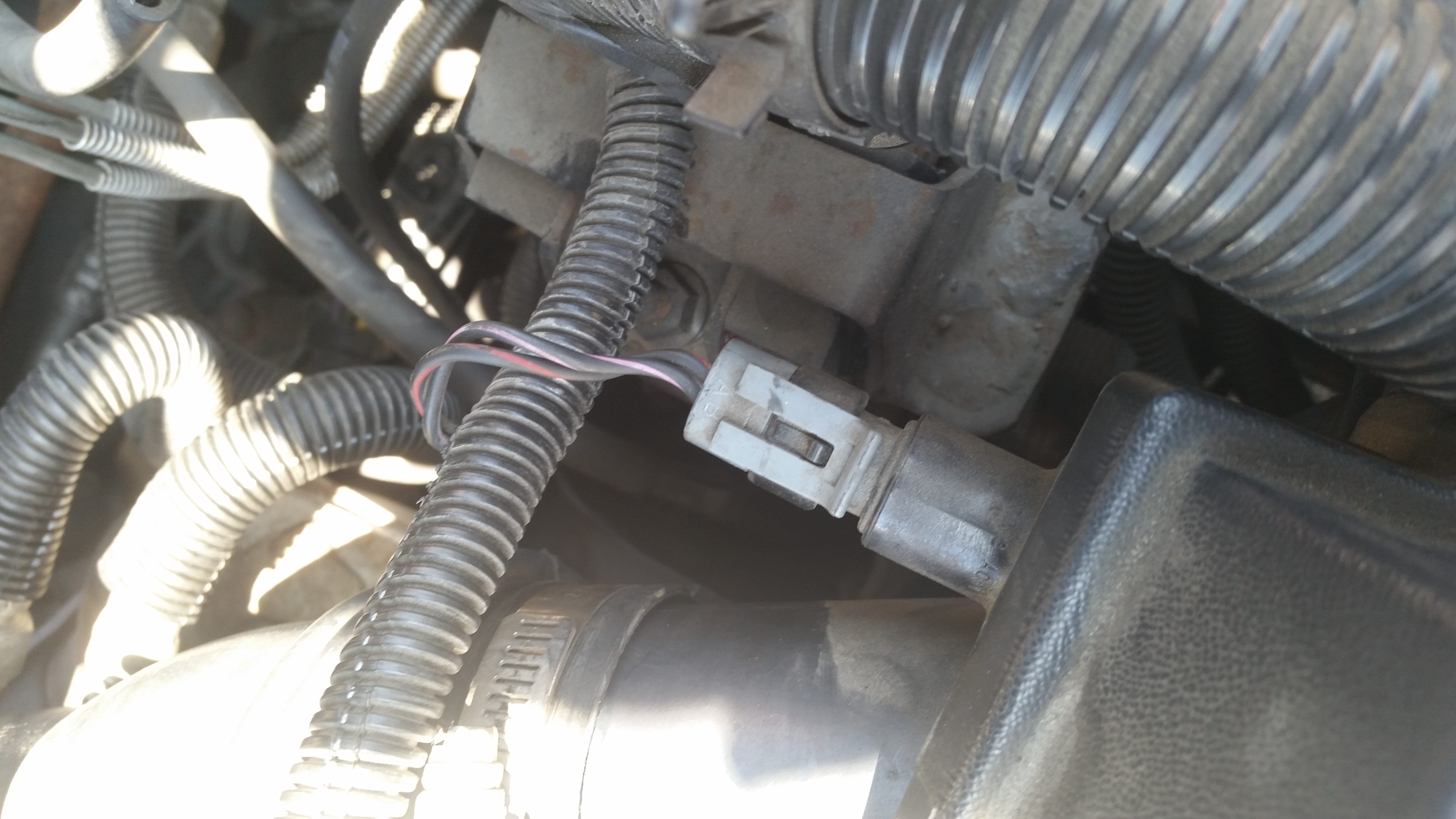

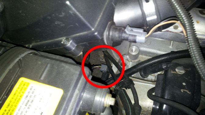

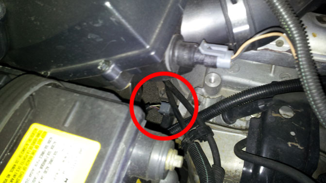

look, here is the plug
**edit**
just below the air filter box
it's maybe a PITA to unplug it, so it was in my case
**edit**
