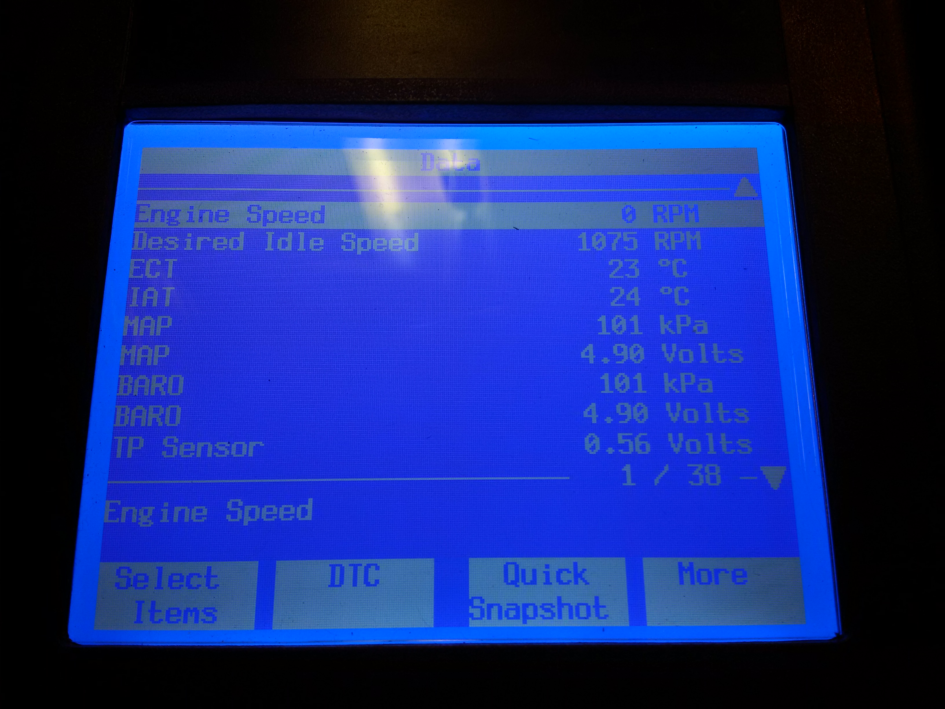

-The mechanic said that the Tech 2 showed no rpm when cranking, and that that was a problem. He's right, I can now see it on my Tech, see pictures in the following posts, when I run the starter and it doesn't fire at all, it shows RPM=0. The times when it fires it shows RPM, but since I can't get it to keep running it soon dies, the Tech 2 continues to show RPM going down. So in my logic it's not as if it dies because this RPM signal fails, the RPM signal records the slowing of the engine. On the other hand, as stated, it shows RPM=0 until it fires. ?????????????

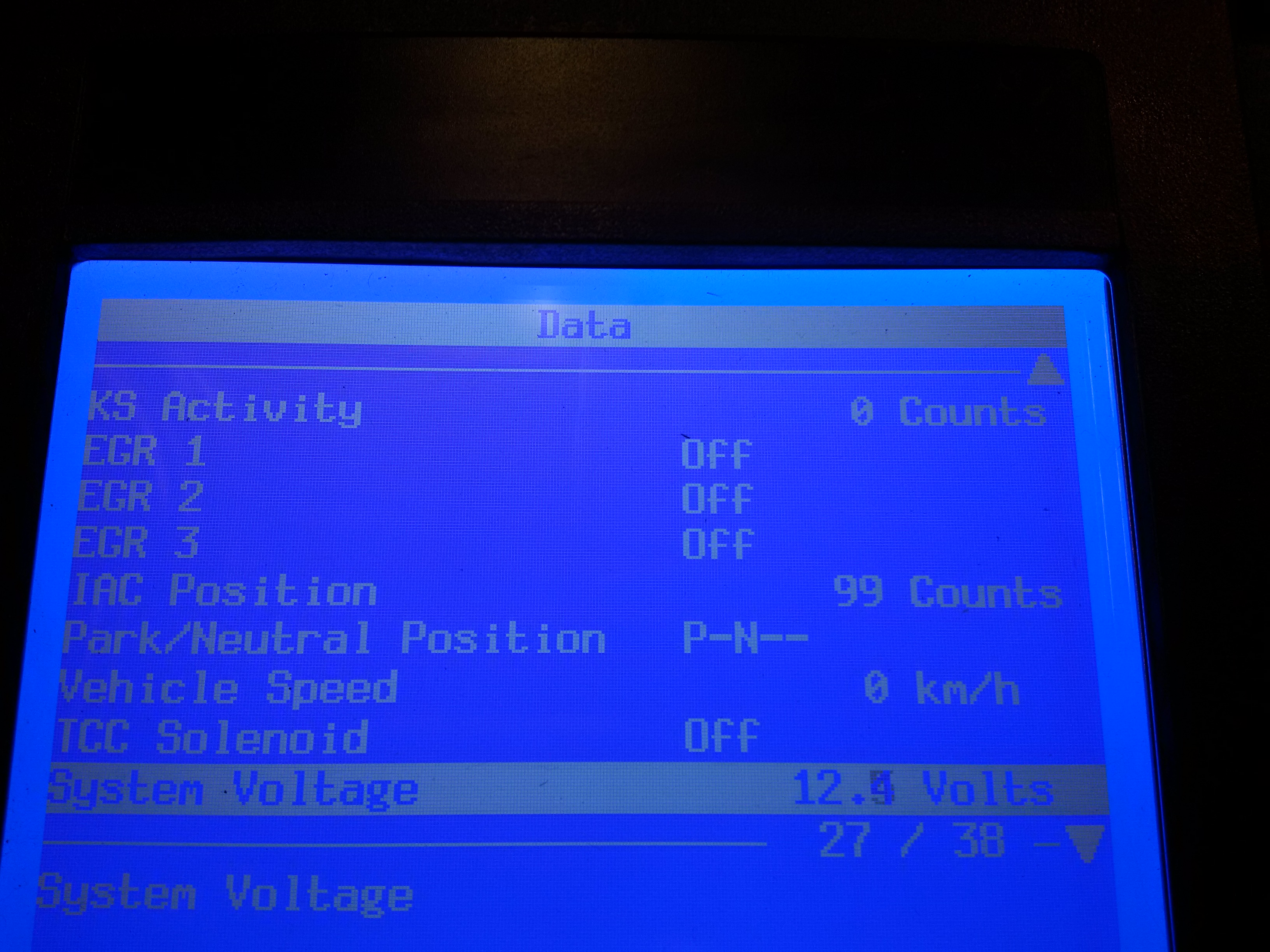

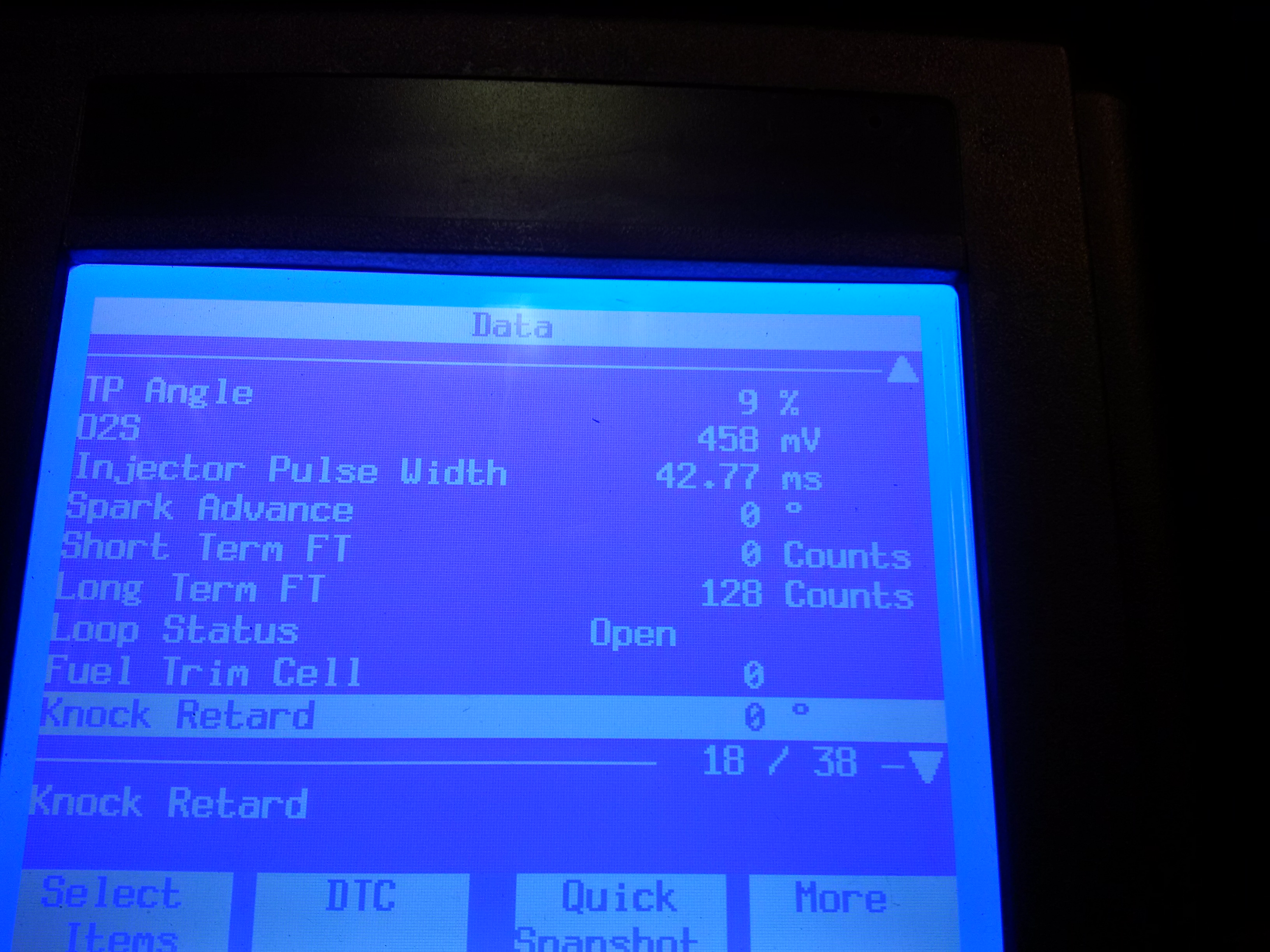

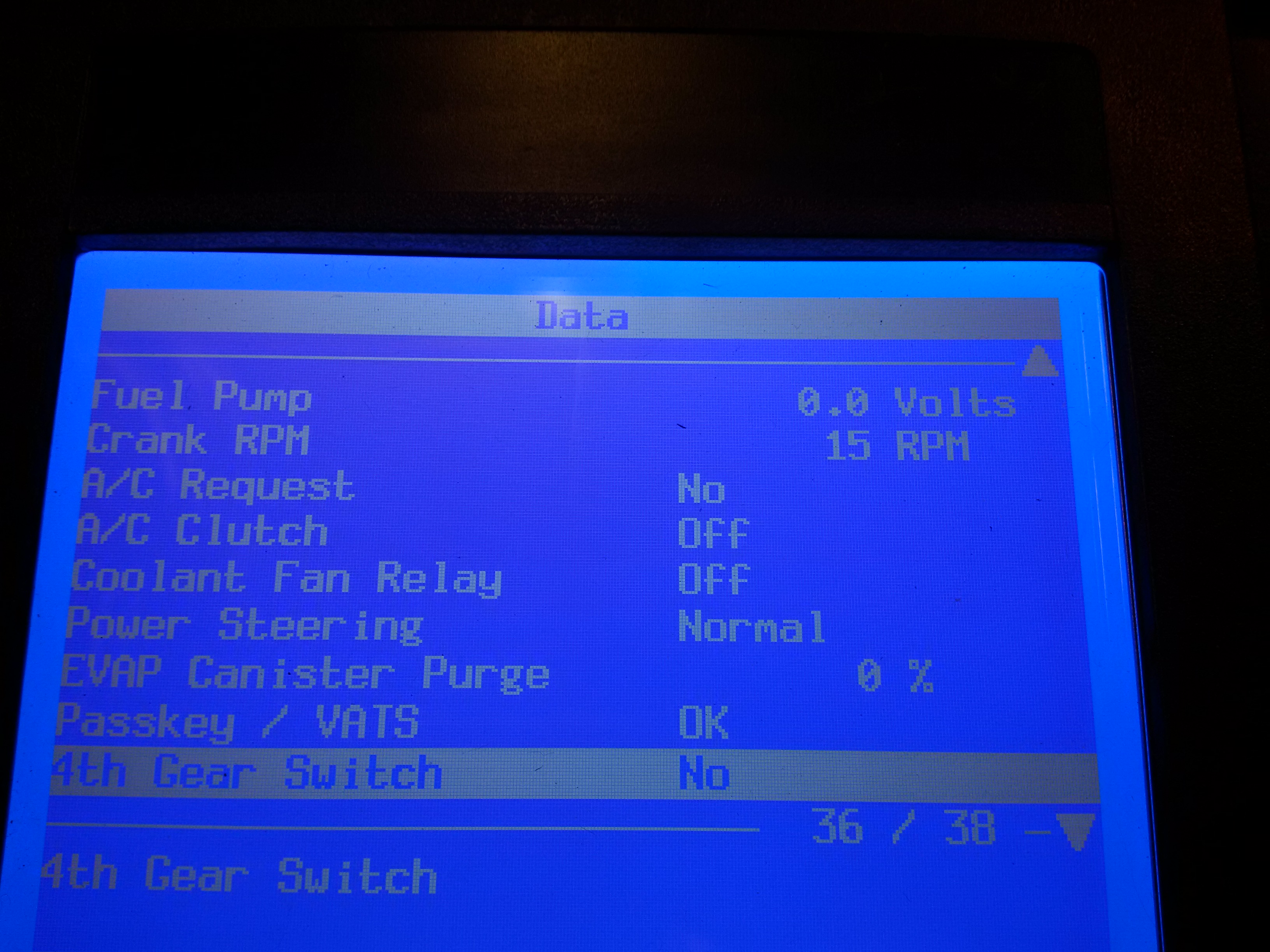

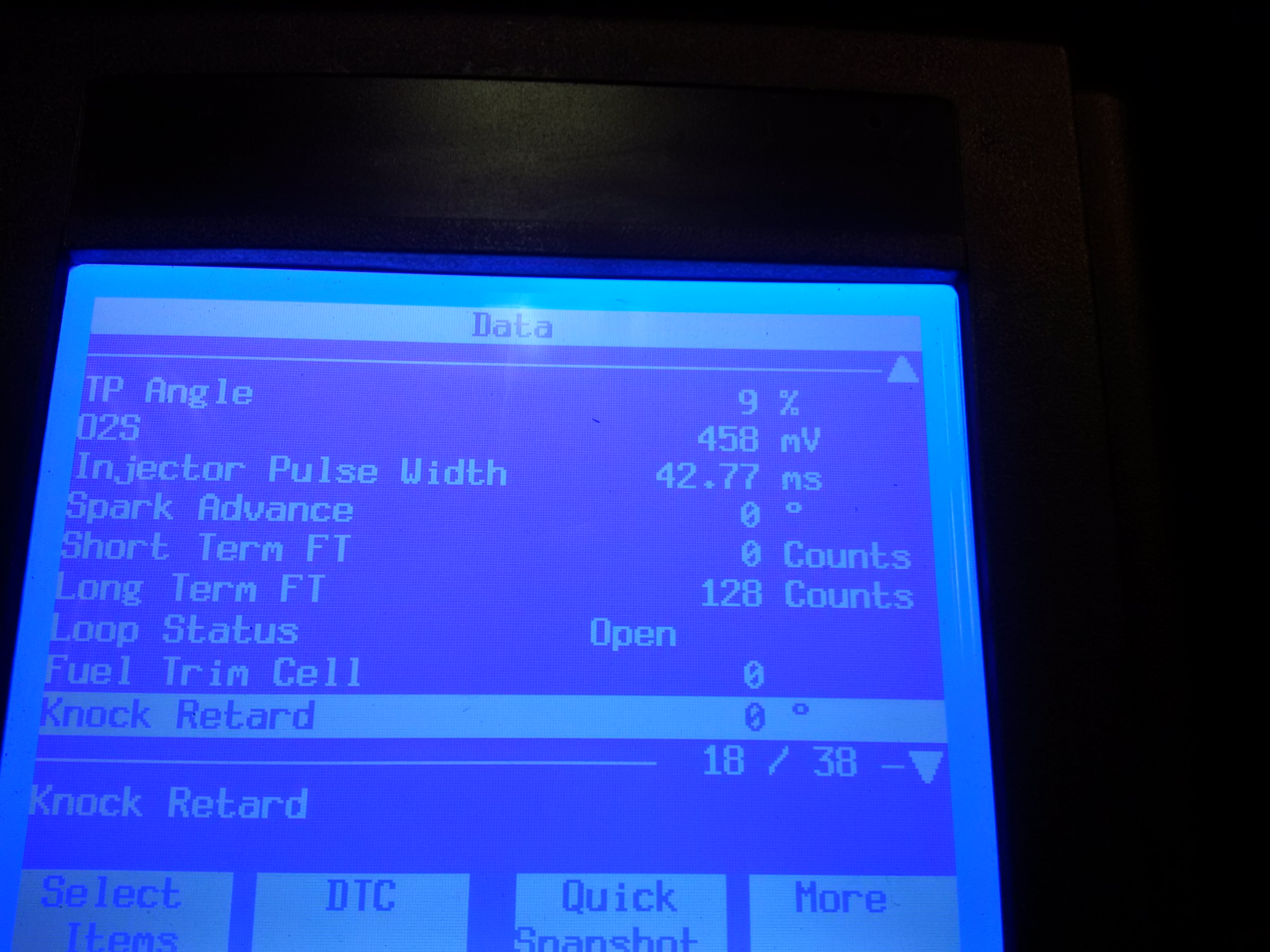

Here are 5 pictures of what the Tech 2 tells me, ignition on, engine off (since I can't get to run)
Do you see anything out of the ordinary?
Notice on top here the Engine speed that I talked about in previous post, and that the GM mechanic was an error

The other pictures

Picture 3 of 5

Picture 4 of 5
