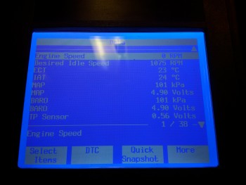

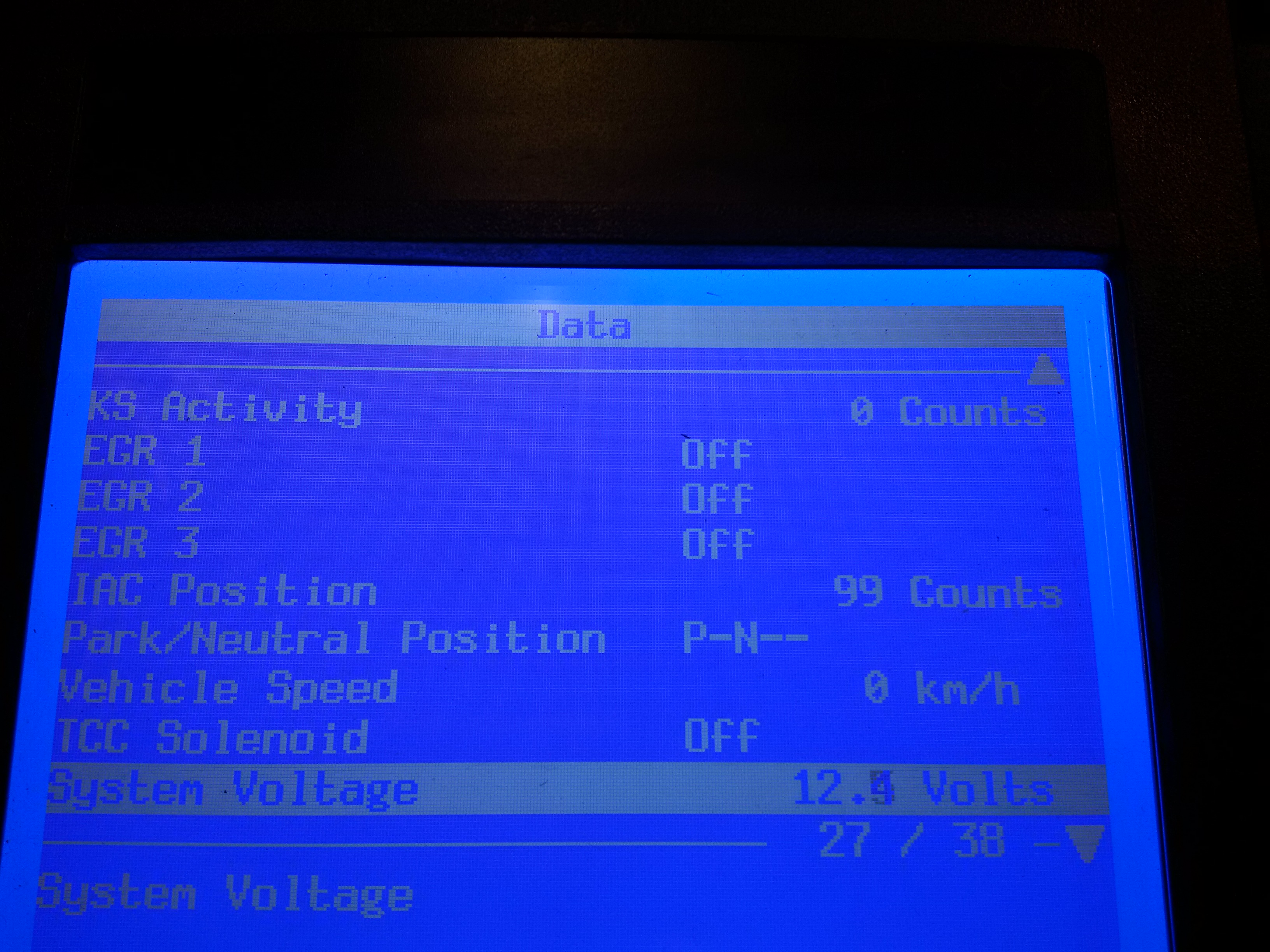

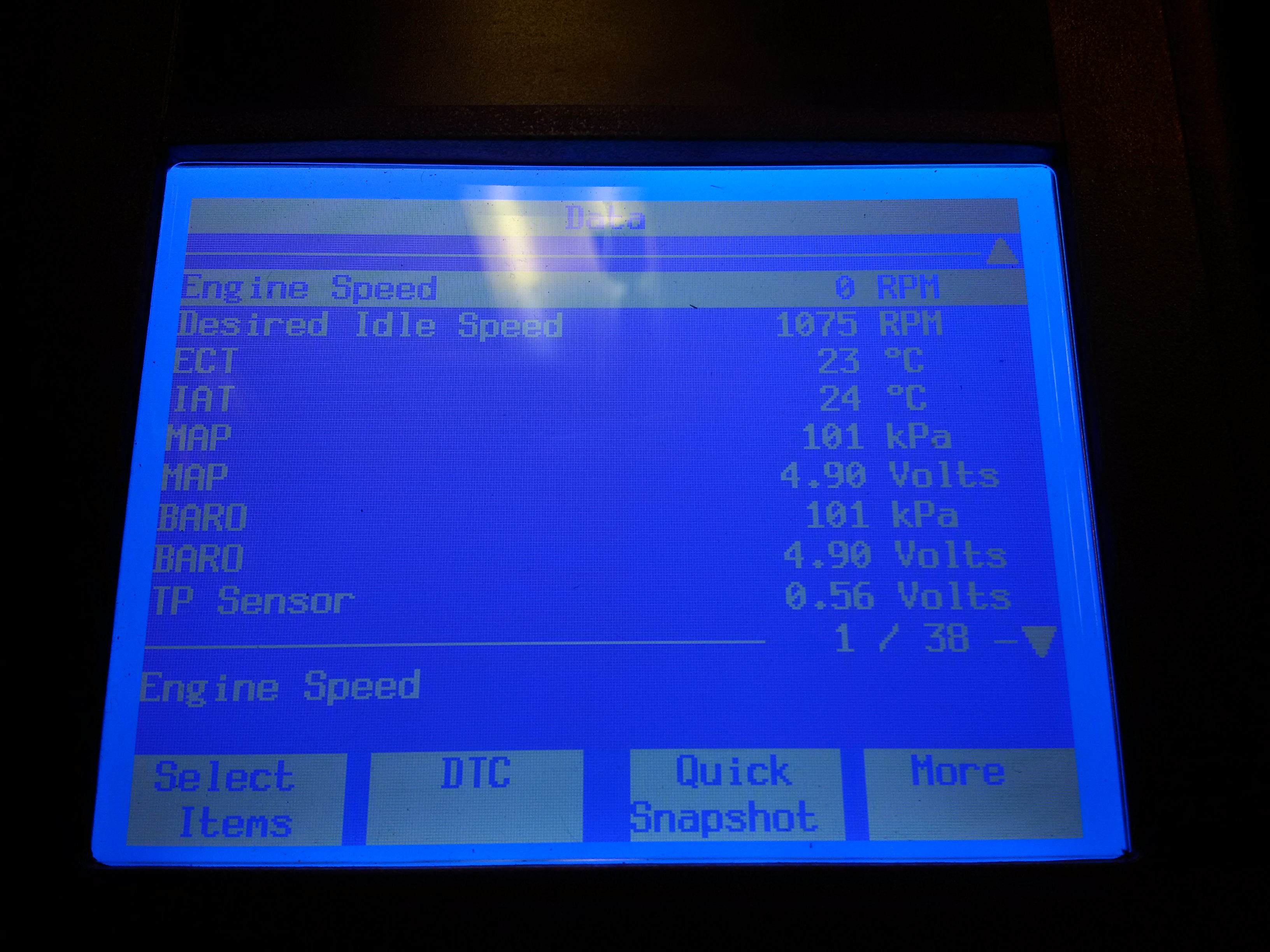

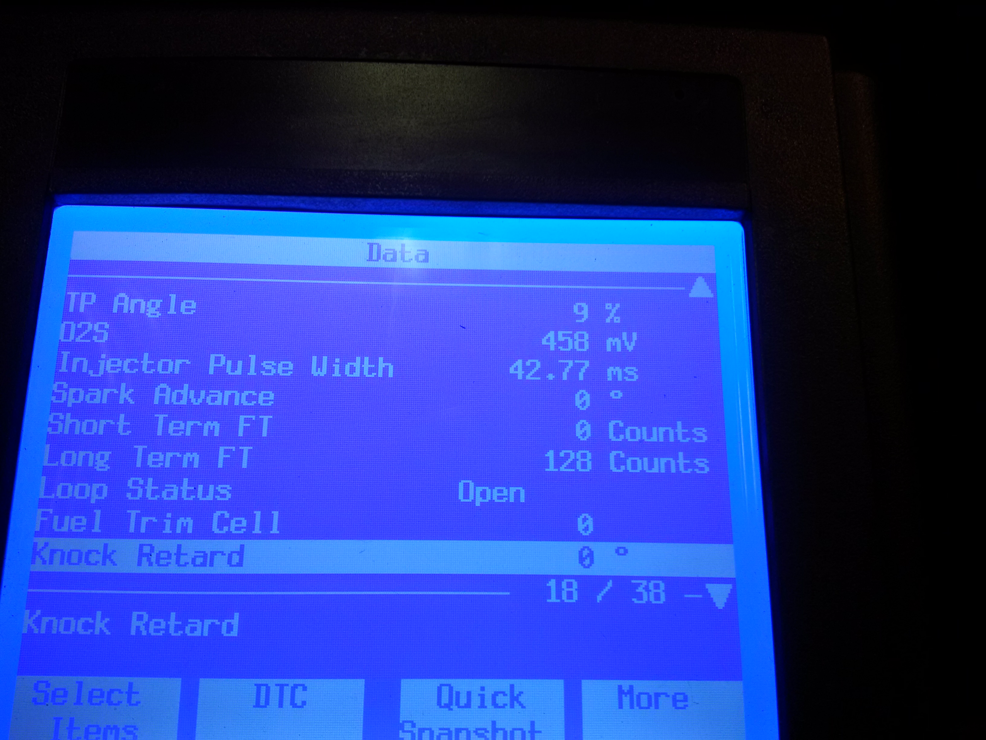

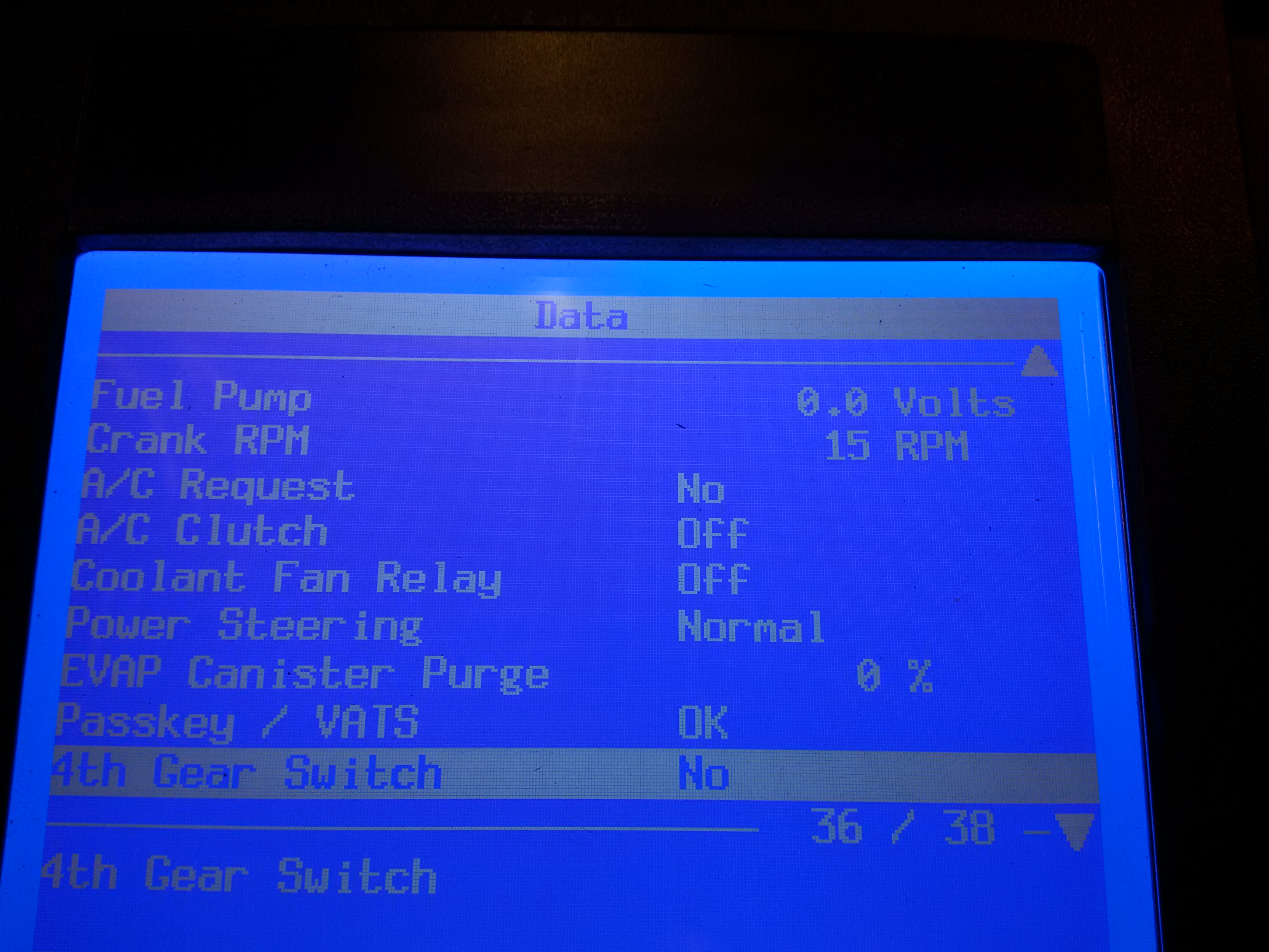

Here are 5 pictures of what the Tech 2 tells me, ignition on, engine off (since I can't get to run)
Do you see anything out of the ordinary?
Notice on top here the Engine speed that I talked about in previous post, and that the GM mechanic was an error

The other pictures

Picture 4 of 5
