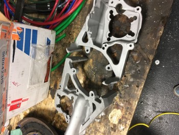

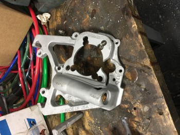

Looking for just the brackets and backing plates. Plan on doing all new brakes parts.

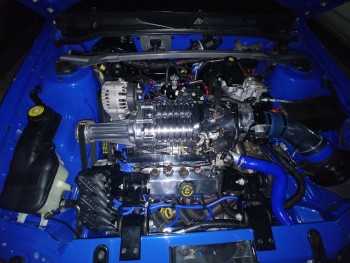

Welcome to the site, Justin! Nice to see another 3800 S/C Beretta. Yours looks like a Series 2 L67? I see you changed your S/C pulley, what PSI are your running? Very cleanly built car, nice job!
Re: New to the site.Looking for Dodge neon rear disc set up
Thanks, yeah running a L67 with a gen 5 charger.its also cammed,ported heads and lower intake.Running a 3.2 pulley for now.Still needs to be fine tuned.Around 10-12 pounds of boost.

Those holes were for an ABS sensor on the Neon...
Ok thanks. Then they are going to be filled3X00-Modified wrote:Those holes were for an ABS sensor on the Neon...

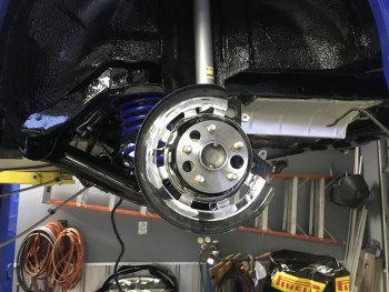

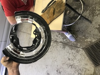

Found some brackets and backing plates.
Some info for everyone.found a lot of the Chryslers cars came with the same rear caliper brackets.Mine are off a 2002 300m.Still need to machine the brackets the same as a neon.I modified my backing plates so the rotor didnt have to be spaced out with washers.Cause my wheels are already in the
edge.
