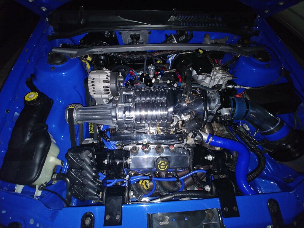

My name is Justin Coleman.New to the site.I have a 1994 beretta Z26 with a 3800 supercharged.Will try post some pics.Looking to attend the beretta fest this year.Will be my first.Hoping someone may be able to help me out.Looking for a rear disc set up off a neon,so i can finish my conversion.Having a hard time here in Michigan finding anything.Any help is much appreciated.
download/file.php?mode=view&id=7001
download/file.php?mode=view&id=7000
download/file.php?mode=view&id=6999
Engine bay
Engine bay

Welcome to the site, Justin! Nice to see another 3800 S/C Beretta. Yours looks like a Series 2 L67? I see you changed your S/C pulley, what PSI are your running? Very cleanly built car, nice job! :good:

Thanks, yeah running a L67 with a gen 5 charger.its also cammed,ported heads and lower intake.Running a 3.2 pulley for now.Still needs to be fine tuned.Around 10-12 pounds of boost.

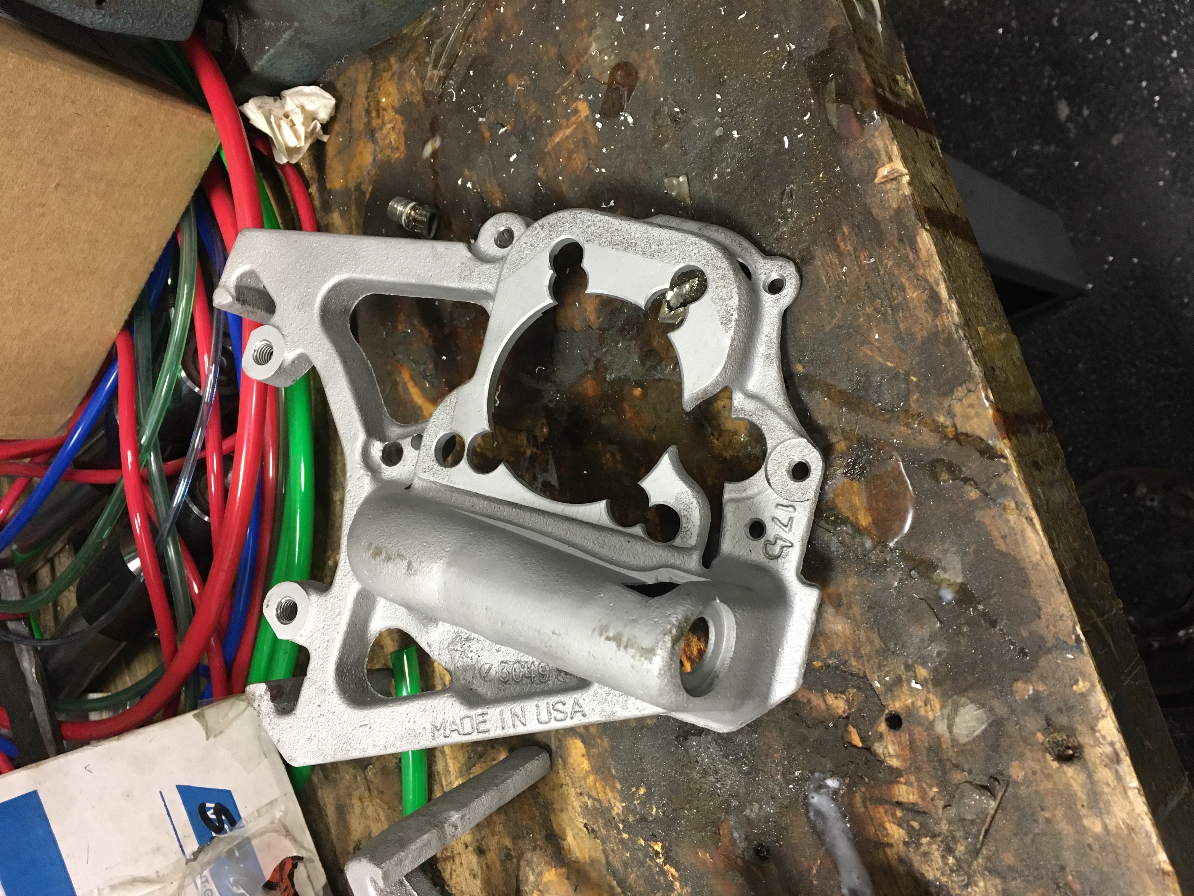

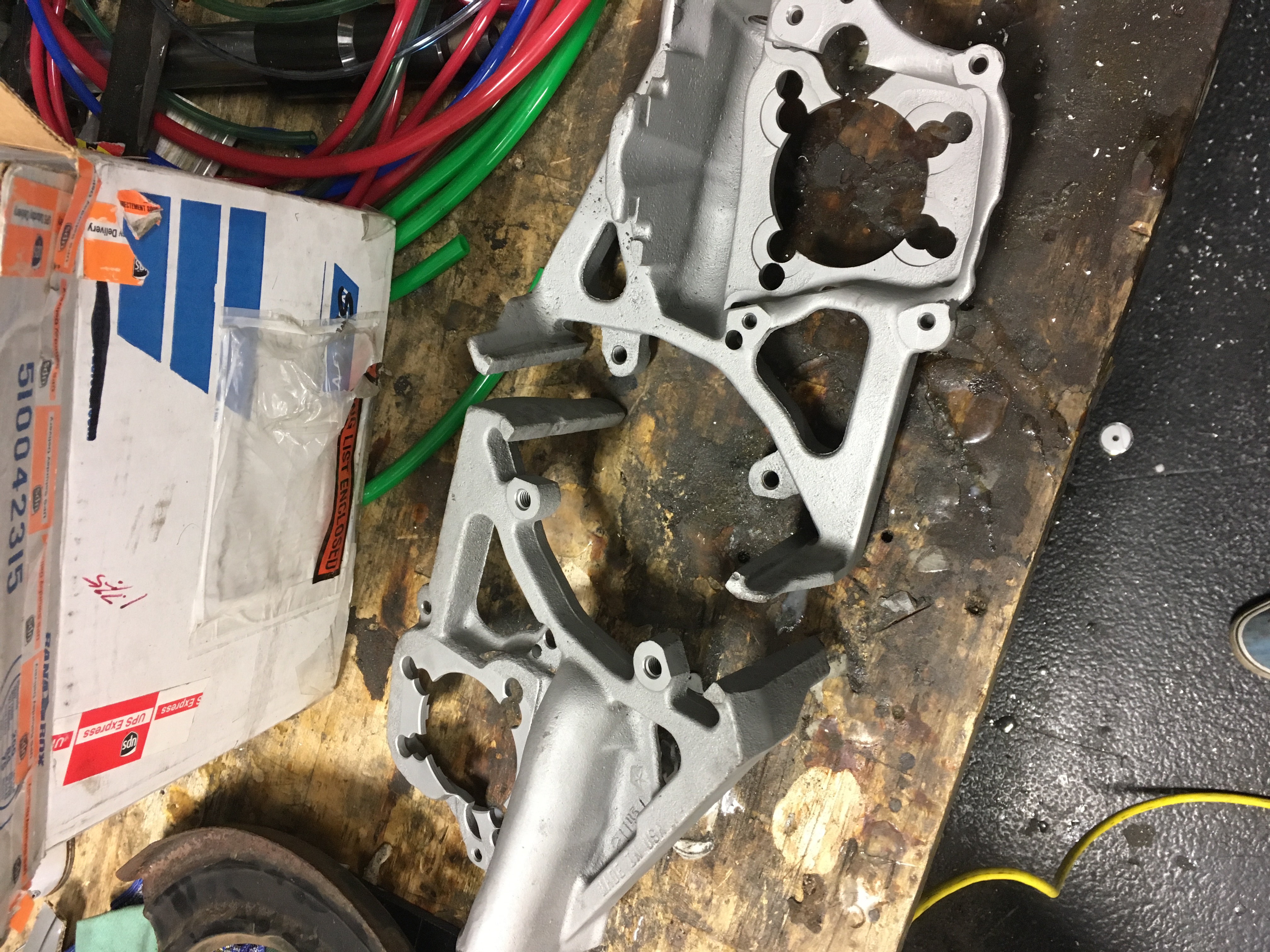

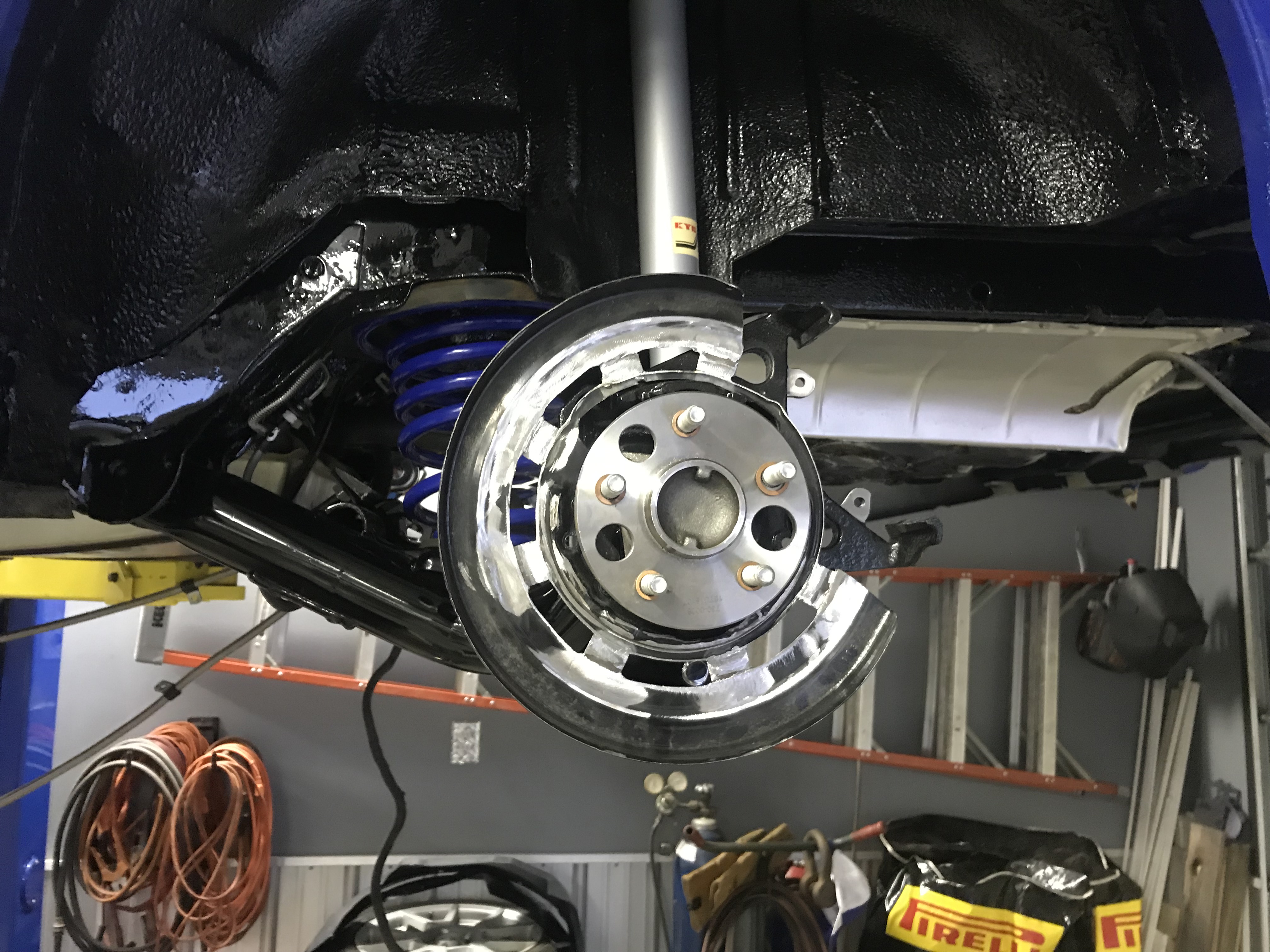

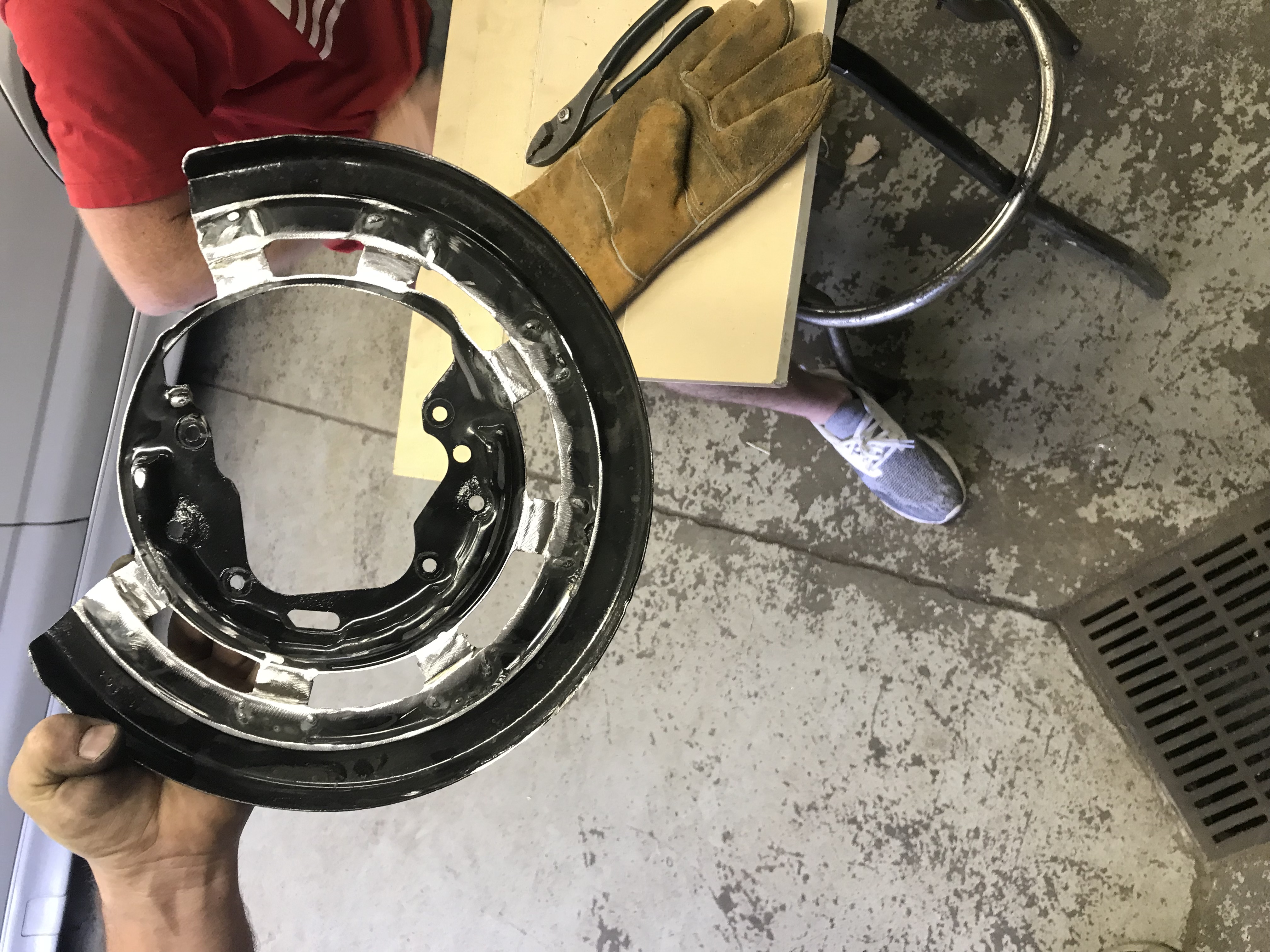

Found some brackets and backing plates.
Some info for everyone.found a lot of the Chryslers cars came with the same rear caliper brackets.Mine are off a 2002 300m.Still need to machine the brackets the same as a neon.I modified my backing plates so the rotor didnt have to be spaced out with washers.Cause my wheels are already in the
edge.
