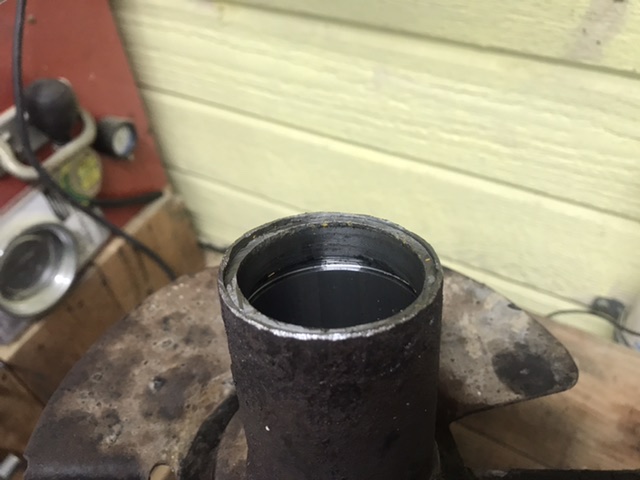

Alright I’m back. SHOCKS ARE DONE and here is how you do it everybody!
How to put koni wrx shocks in 1988 style Beretta
This includes Indy models so you guys get on this!
We don’t need any external/additional parts!
Here is how to put in a currently-produced WRX KONI into an old-style top strut steering bearing strut (‘87-‘94?). The Mitsubishi Eclipse Konis are gone. Ebay and 4 stores claiming stock had nothing. Tire rack wins (for Saab rears too) for price and I paid $211each. It’s easy and simple, so buy some for your car! I don’t have any new style bearing plates so someone will tell us the year upper limit I’m sure. Okay here goes.
If you have inserted original beretta (8641-1239sport) shocks into housings before, it goes pretty much like that, exactly like that if using a Gabriel shock housing. I did two here, one Gabriel and one ACDelco. The Delco requires a trick and both are similar where attaching to the top steering bearing. These pictures are an original AC Delco housing.
Prepare the beretta shock housing by cutting the top off to remove the innards. Now KONI wants you to cut a certain amount down the tube which exposes an inch or more of their shock... I did not go this low. I just made sure that the housing tube does not touch the KONI. If I cut too low on the Gabriel, I would need a bushing. By going down a half inch (2nd cut made after the innards removed) the “bushing” is already formed into the housing and I was able to use that (on the Gabriel).
To be cautious, because we don’t know for certain what’s inside the tube, cut near the top (as opposed to almost 2” below the top like koni instructs). Cutting too much toward the top and we can’t extract the guts, too low and we may have to cut the bushing separately in the vise (your choice really). We intend to use the inside as a clamp on the bushing should we need it. We don’t know if we need it yet and are preparing. Be aware that we may need a bushing here so the koni doesn’t flop around atop the tube after mounting. That’s why we are doing this.
Cut 1
Cut 1
3 piece
3 piece
You can see what I did here. The right ring/bushing is what I’m using cut from the left two pieces. Discard the left two. This right bushing exactly matches the koni and of course the tube that it just sat in. It will hold into place by setting into the tube and lightly hammering the top of the shock tube over the bearing enough to hold it in place.
Here it is done. Before bushing, going in, and then bushing installed.

Note: I did not use the supplied bushing because it didn’t fit as well as this does. If your shock tube varies more than mine here, you may work with it.
