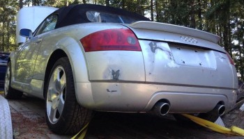

This is the worst angle for the car. The rest of the body and paint are much cleaner.

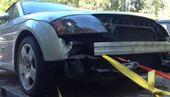

...Except for the front bumper-cover.  It was included, just not installed. A few cracks, but nothing beyond repair.

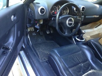

The interior is a little rough, but some replacement parts (like door-panels) were included. The P/O did INTEND to fix the car...

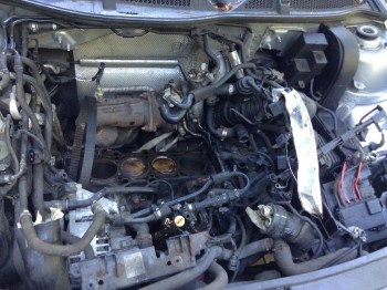

So, after a season's worth of months, I finally dragged the little car into the shop, and got to work.

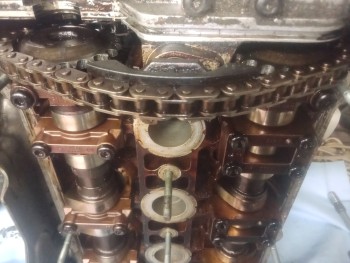

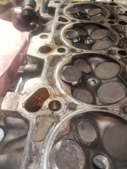

Dem be some bent valves... Stupid interference design...
Riddle me this, Batman... If VAG can utilize a CHAIN to drive the Intake Cam off of the Exhaust Cam, why the !@$#! don't they use a frigging CHAIN to drive the Exhaust Cam in the first place to avoid breakdowns and repairs like this?  GM did with the Quad-Four and 2.4L Twin Cam engines, just saying...>:(

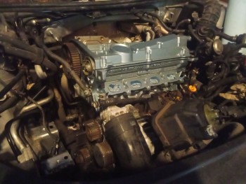

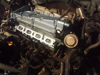

This is pretty much how it sits right now, except that I also installed a new Gates Belt, new tensioner, tensioner pulley, idler pulley, and water-pump. That was it PITA...
I felt terrible installing the freshly overhauled Cylinder Head, new valves, every inch cleaned, fresh paint, etc in that filthy bay, but since the car came to me with a loose head (it wasn't off, but was loose), I couldn't risk washing it and getting water in the block... but it WILL get cleaned! Fresh silicone hoses may be in order too, and upgraded aluminum coolant pipe fittings, to do away with the plastic trash.
