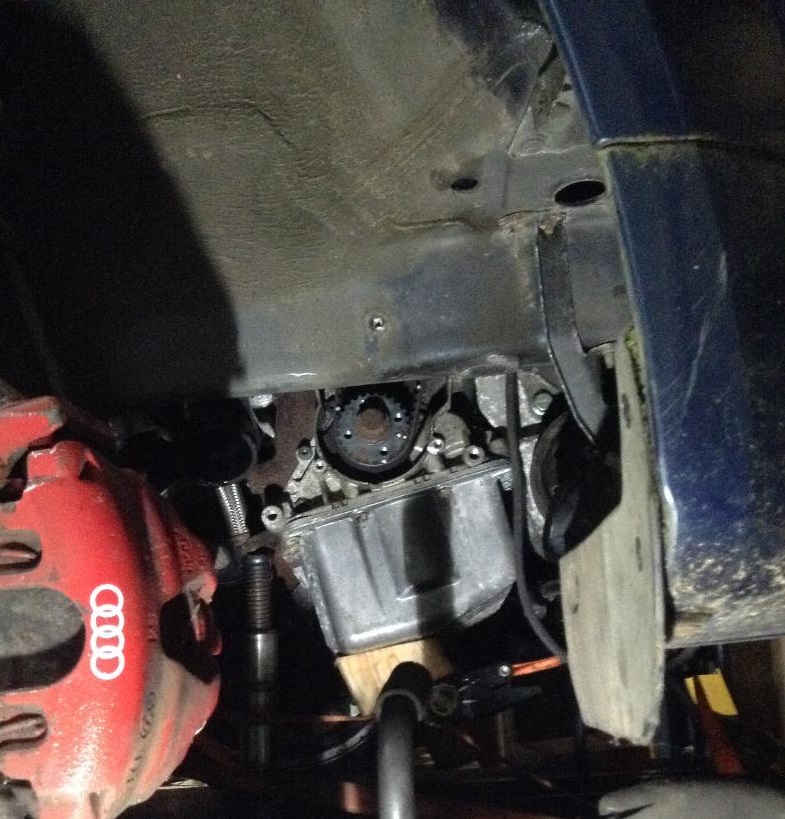

And one more reason to dislike most timing-belts: Take the wheel off and work on the entire face of the engine from top and bottom... Dumb.
I found the belt HAD been changed (Gates brand -what I usually choose too), but the water-pump was original Audi -possibly replaced with OEM, possibly NOT replaced... Either way, plastic junk impeller, had already cracked and was missing pieces. :Search: Nowhere in sight and crumbly as 'Blau" cheese... :D The belt had stretched enough that the hydraulic tensioner wasn't even keeping up anymore. So yeah, the belt and the pump needed to go.

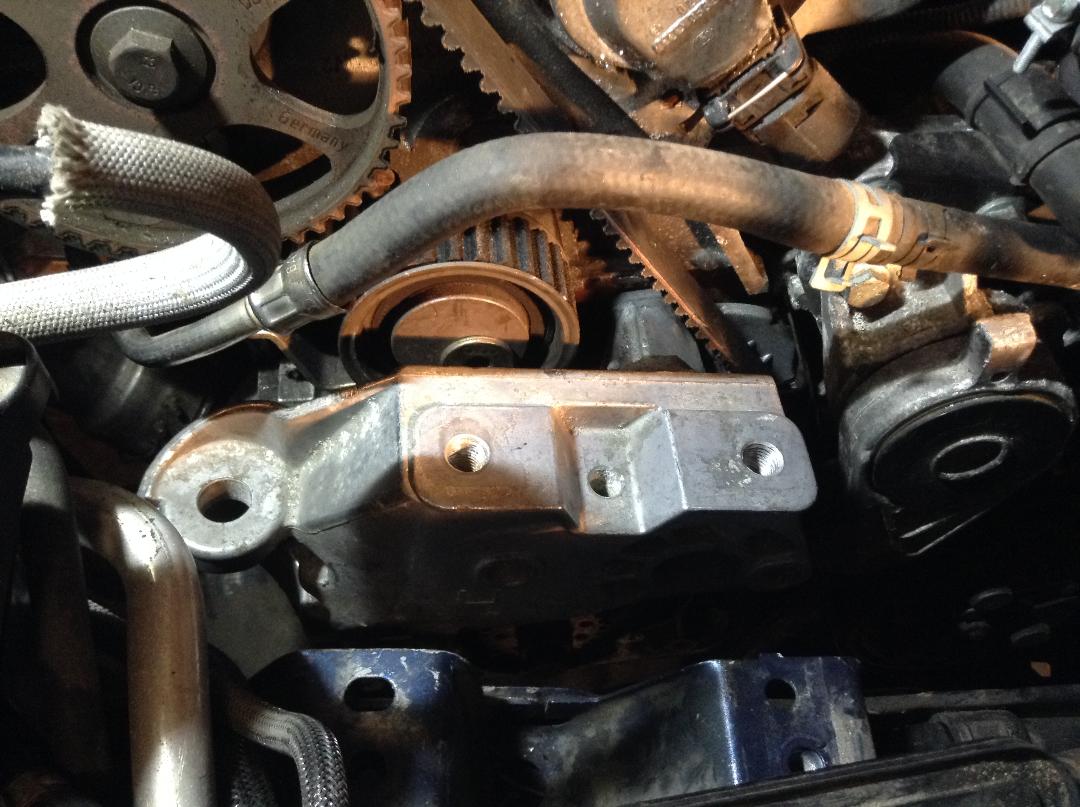

Rettax3 wrote:Removing all the little pieces and parts is expected on one of these, but the engine mount that cannot be removed despite it blocking the belt is another thing... I will TRY to remember to snap pics when I chop the stupid piece of "scheiße" into a functionally-removable component...
This is the mount that traps the belt to the engine and must be unbolted for the replacement

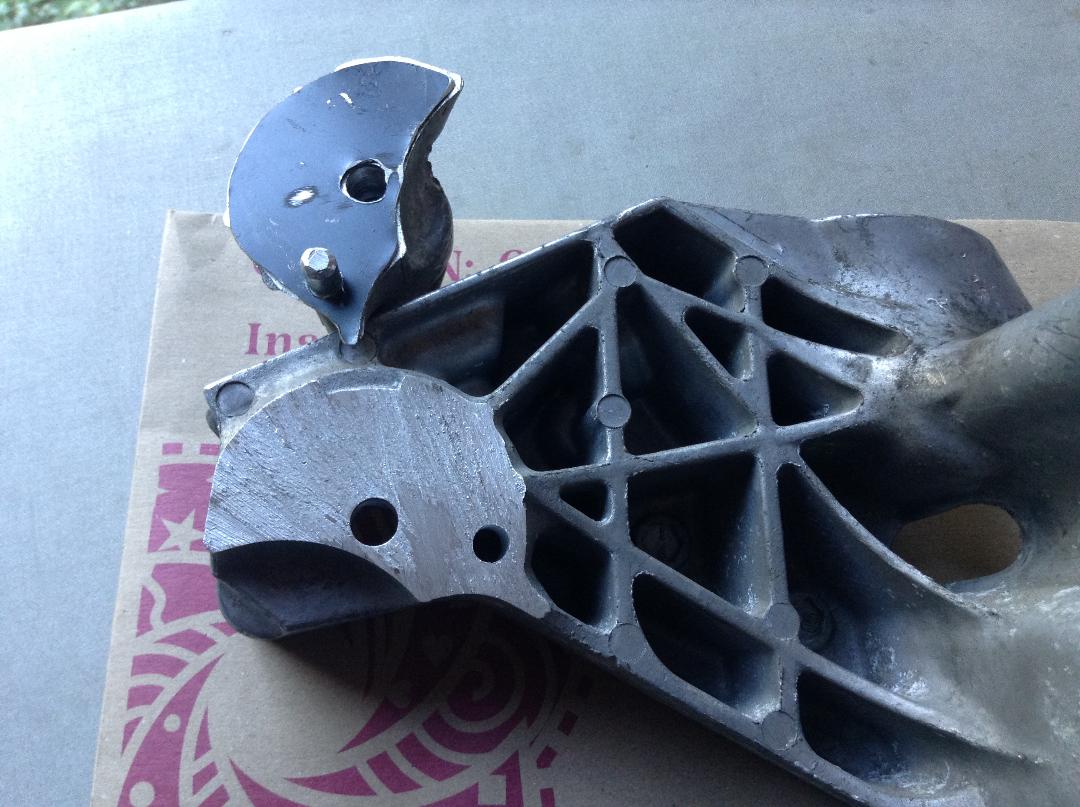

!@$#! Piece! >:(  Instructions say to 'shift' this mount around to get the belt out of the engine.  It is supposed to stay in the way.  Ahh, NO.
My Porta-Band saw-blade broke when I started cutting this, the only one I had was old and dull.  The cut looks nasty, but is straight.
The kerf, or cutting width of the bade, had to be made up for -so a small sheet-metal shim was made. Before cutting, I drilled a hole through the mount, and tapped a bolt in to make an alignment 'dowel pin' that will also help support the mounting bolt against shear forces.
And there it is.  In place, and now readily removeable for future belt service.

I hope you keep it long enough for that to be worth it! haha
Posts: 1855
Re: Am I blue? No, the new car is though...
woody90gtz wrote:I hope you keep it long enough for that to be worth it! haha
I weighed the options and considered whether or not the belt will get replaced again, but I wasn't going to work around that stupid block so it was out anyway, and it was such a PITA to remove that the satisfaction of chopping the damn thing in half AND fixing a pi$$-poor design made it worth it all on it's own. :D
As for replacing the belt itself, if I hadn't done that when I did, the engine would likely be ruined before much longer. So keeping it at ALL required the maintenance to be done. It does look like we are keeping it though. Of. Course. :o

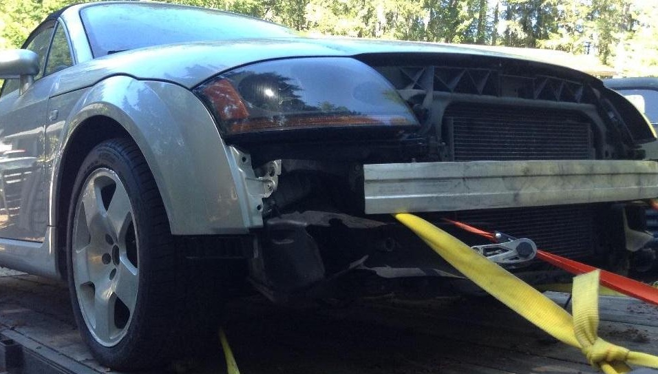

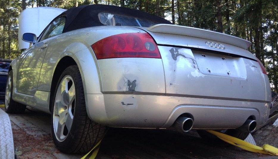

Because I found a Quattro parts-car with a six-speed manual for cheap, so of course, we now have TWO MK1 Audi TTs... Ugh. The parts-car, as mentioned, is a Quattro model, meaning both AWD and a more powerful version of the 1.8T, 45 more ponies to be exact. 225 isn't bad from such a small powerplant, and from what I can tell, they are perfectly reliable at that output (so long as the maintenance is kept up on them, and the plastic junk-parts are replaced occasionally, or upgraded...). This particular one looks just like the blue one, perhaps a little rougher, but is silver under black, instead of blue-on-blue. Stock rims (I like them better myself). Some rough spots in the paint. Oh, and a totally ruined cylinder-head from a snapped T-Belt... Duh.
This is the worst angle for the car. The rest of the body and paint are much cleaner.
...Except for the front bumper-cover.  It was included, just not installed. A few cracks, but nothing beyond repair.

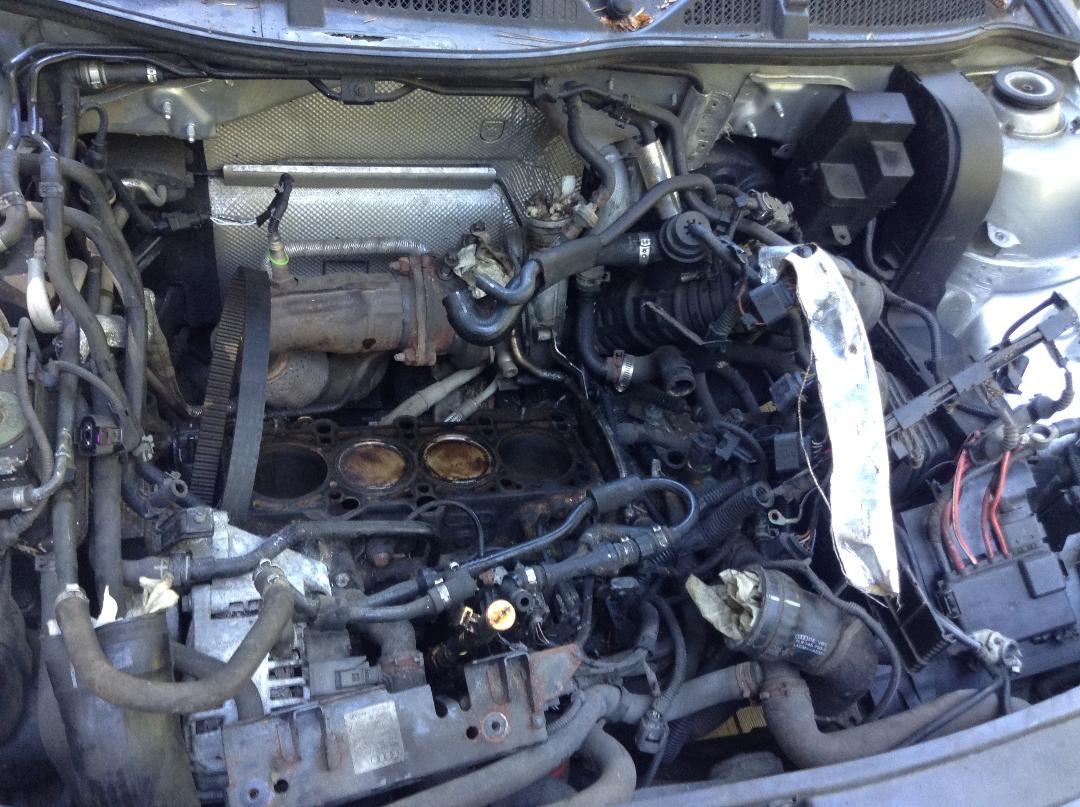

Until they got into the engine, I think. They say, Never take-on someone else's abandoned project... Do I ever listen? Nah.
So, after a season's worth of months, I finally dragged the little car into the shop, and got to work.

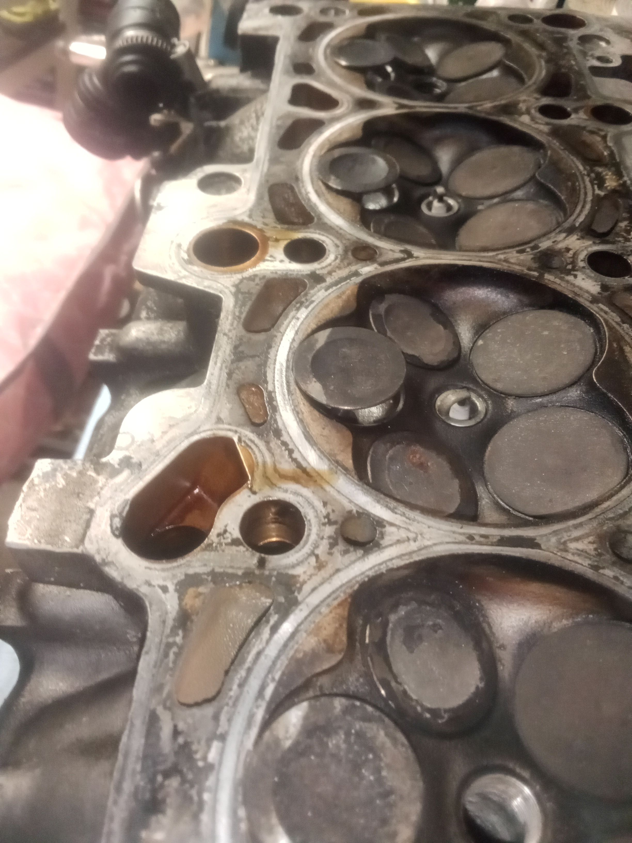

Dem be some bent valves... Stupid interference design...

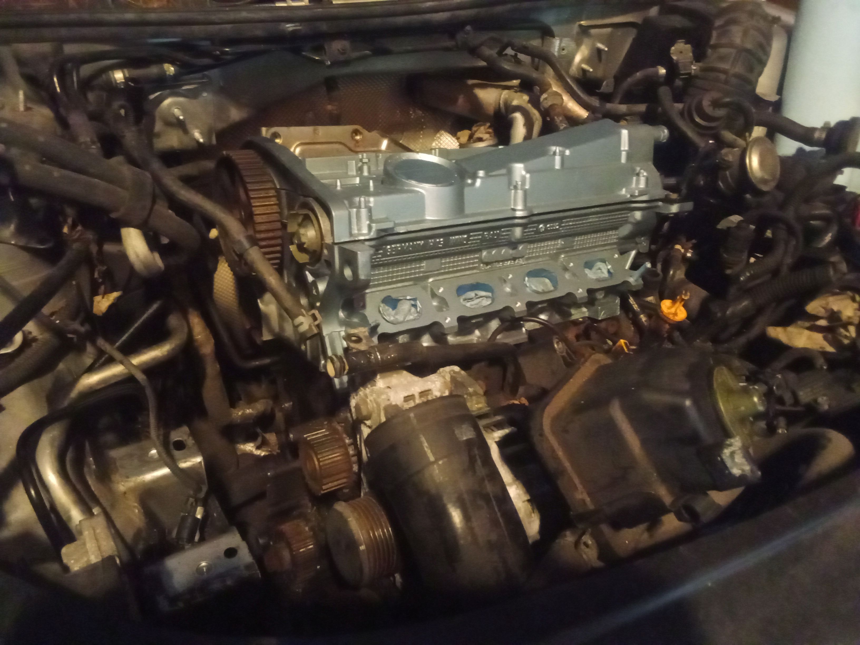

This is pretty much how it sits right now, except that I also installed a new Gates Belt, new tensioner, tensioner pulley, idler pulley, and water-pump. That was it PITA...
I felt terrible installing the freshly overhauled Cylinder Head, new valves, every inch cleaned, fresh paint, etc in that filthy bay, but since the car came to me with a loose head (it wasn't off, but was loose), I couldn't risk washing it and getting water in the block... but it WILL get cleaned! Fresh silicone hoses may be in order too, and upgraded aluminum coolant pipe fittings, to do away with the plastic trash.

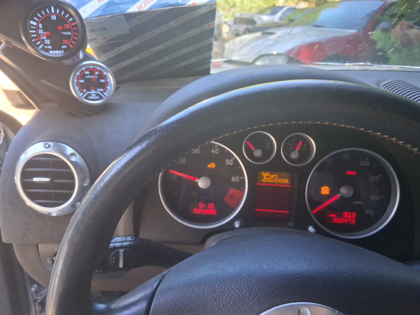

..After which I got another intermittent oil-pressure warning indicator, but this time with an accompanying 'circuit fault' indication, so now I am waiting for a replacement switch (something like $5 for a decent brand -most parts are dirt cheap for these cars)... And I should be fabricating a Tee fitting to run the 10mm threaded oil pressure switch and a standard 1/8" NPT tapered-thread fitting for an add-on gauge once the fresh brass extrusions I ordered arrive...
..And this week I should have that gauge, AND a boost-gauge (since Audi did not include one in the car's cluster for some unknown reason), that roughly matches the style of the car's gauges, AND an A-Pillar mount dual-gauge pod for them. THEN the car should be good-to-go, and can be driven around regularly, mmm, I think. :oops:

The latest round of Zelda issues reads something like this:
-Fabricated the Oil Pressure Sender TEE out of some fresh one-inch brass -cost maybe 1/2 of simply buying the adapter online, but this way I know the machining is to my standards with no porosity in the brass, the main plus of course is that I enjoyed making my own part. Built, Not Bought for the win!
-I also made an extension tube to make the new gauge sender easy to access, instead of the Audi way of 'cram it in tighter!'
-The dual-gauge setup on the pillar works great. El-cheapo gauges setup with an independent dimmer mounted right on the pillar, and aside from needing some textured vinyl and a stiff backing panel to finish-off the pillar (I am unwilling to cut up the original pillar-cover as they are getting pricey and harder to find in good shape), I am very pleased with it. Running the signal wire and vacuum-tubing was pretty easy, but took a little longer than needing because of how I chose to do it, keeping modification to a minimum and as discrete as possible. This is how it came, of course, nothing to see here, tra-la-la... :oops:
Dimmer-knob is unobtrusive and works perfectly.  I already had the varistor, so it was a cheap upgrade to the function.  Had I paid better attention, perhaps I could have gotten a silver-bezelled boost gauge to match the oil-pressure gauge and the main cluster gauges better, but ehh.
But then...
--The new sensor is in, but the instruments still show a pressure-sensor circuit-fault. Time to trace wiring, I guess... %)
--The oil pressure is fine at start-up, but slowly fades off at idle as the engine warms, and pulls up fine if revved a little. Mmm, [i[could be[/i] a worn-out oil-pump, but this to me is definitive worn main bearings. Chime in for me if you have other insights please!
---I sourced a new set of main bearings, and paid a smidge more for tri-metal, so at least I get to upgrade from the inferior OEM aluminum everyone is using now. But it means I get to drain the oil and drop the pan AGAIN. Yay. :o
