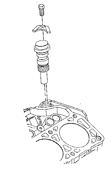

There's no clip on it, or prying. There's just a bolt with a hold-down on it. Just like a distributor would be.

I'll start with just the TB off & see how it goes. I'd rather not screw around with the t-stat housing & have to deal with draining & refilling coolant. The shaft has to come out because the o-ring (while located near the top) slides on/off from the bottom.
Thanks Cliff. Guess I'll have to get a better look at things because I didn't notice any bolt there, just looked like a sunken in cap with a lip around it.

Looked back through my pics & found the bolt. It's all just covered in so much crap that I couldn't even tell there was a hold down with it. And when does anything ever actually want to come out easy

Just a note on the oil pump drive, you can not remove it unless you remove the bracket hold down for the fuel lines and move them around, the front hard line goes directly over where you need to pull up.
Way easy to get out if you dont mind pulling the upper off.
