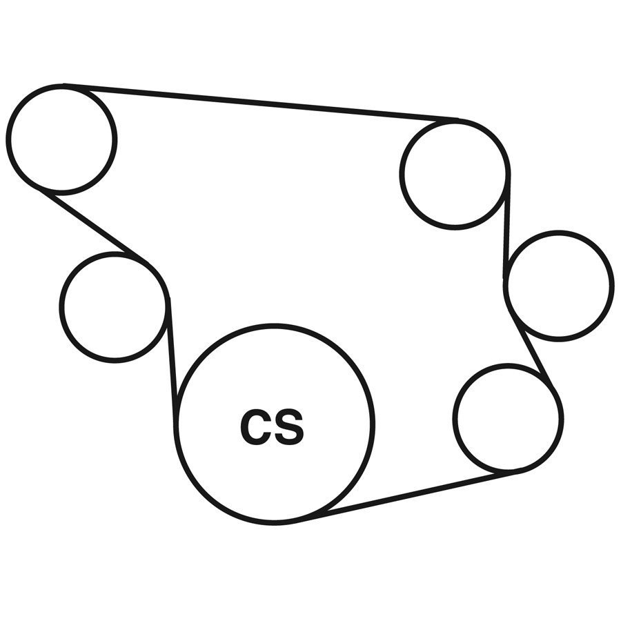

You'd have to test fit...
I'm installing a AC bypass pulley on the motor I'm building for Robert and I don't know yet if the belt has to be any shorter. I'm not sure what they did from the factory to not include AC, if they used the same bypass setups and still needed a shorter belt or if it was something else they did.
The difference listed online is 9 inches, and I can't see that working with the setup I just put on... The pulley I added pretty much simulates the AC being there.
This is a 3100 belt routing diagram, 94+ all came with AC standard...
93 and older still had an option, you'd have to find one in a yard without AC to check if pulleys are different sizes, I cant find older diagrams that look right, they should be the same as the 3100 for the most part since the PS and WP didn't change position but I'm not sure what they did where the AC was to keep enough contact on the WP pulley... they would have had to add some sort of idler just below the WP.
