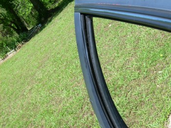

#1 stunna
Posts: 180
Location: Newnan,GA
Re: roll-up windows
Post by #1 stunna »
Pic of the window guide

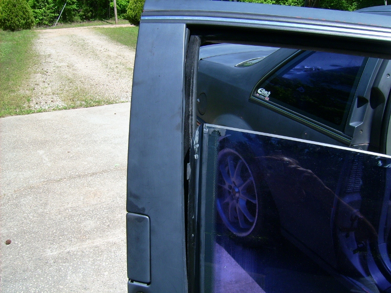

#1 stunna
Posts: 180
Location: Newnan,GA
Re: roll-up windows
Post by #1 stunna »
This is what it does when i roll up the window

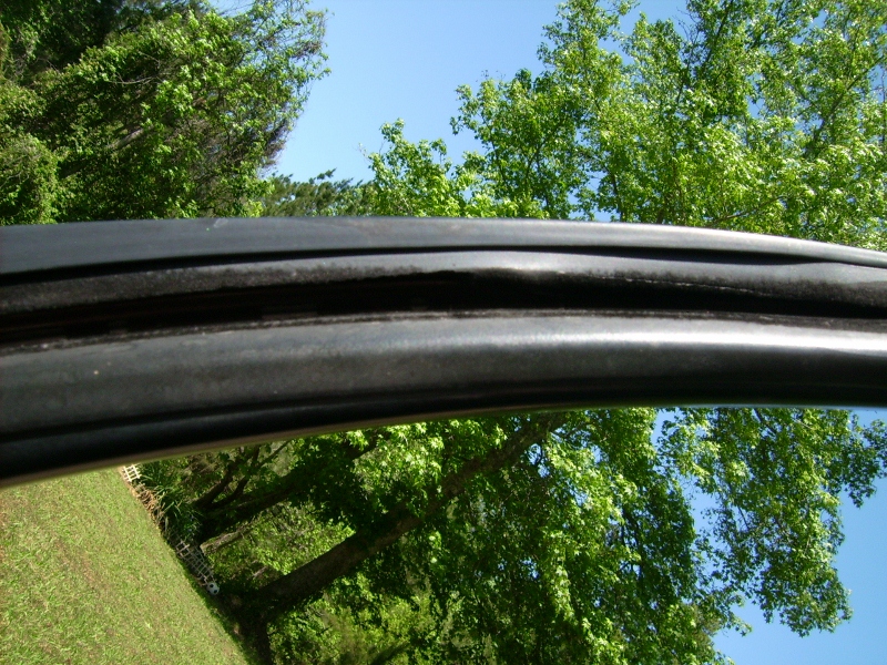

#1 stunna
Posts: 180
Location: Newnan,GA
Re: roll-up windows
Post by #1 stunna »
It looks as if the rubber guide piece can just pull out ... kinda hard to see in the pics

SuzukiGhostRider
Posts: 2464
Location: Milan NM
Re: roll-up windows
Post by SuzukiGhostRider »
Like I said..... Did you adjust the channel guides in the door?? It affects how and at what angle the window rolls up and down.

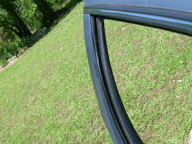

Posts: 10919
Re: roll-up windows
Dont know if this helps or not but here's an exploded view of the door hardware
#1 stunna
Posts: 180
Location: Newnan,GA
Re: roll-up windows
Post by #1 stunna »
Thanks yall ... I found out today the guide does just pull out ,( pc #5 in diagram) .... but its a pain and hard as hell to get out without tearing up the rubber pcs that are rivieted to the metal guide , I tore up two of em at the j/y :Yahoo!: lol.
Anyone who ever has this problem it May be a good idea just to change the whole door out . It COULD be replaced with alot of time and patience tho.
