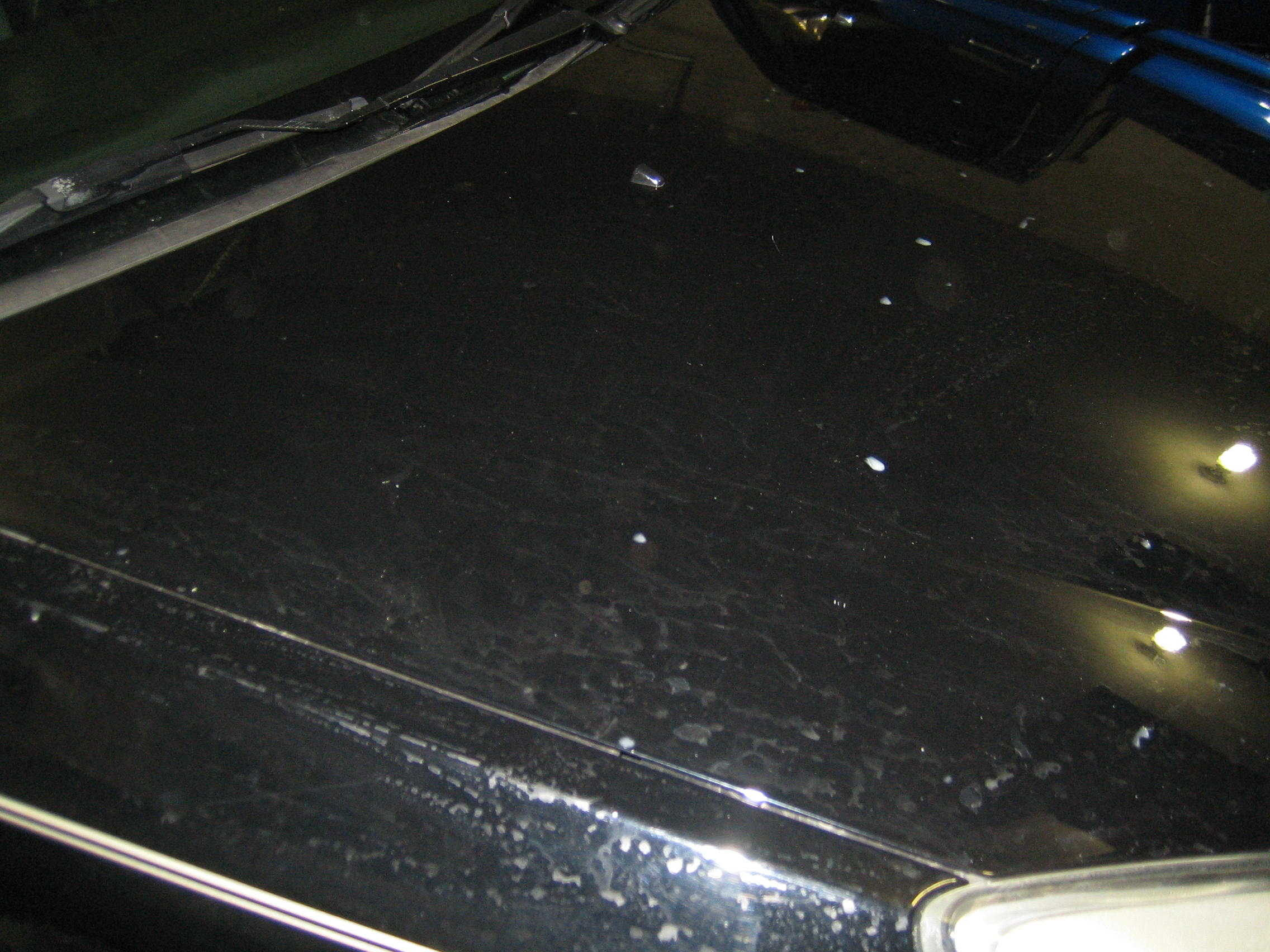

Long weekend, arms were tired.
Bought the car during the winter and have been improving on it since. The detail shop did a horrible job of buffing the car leaving scratches, rotary buffing marks, no wax, and a previous dealer tag.
The paint was pretty bad, water spots and all.

What method did you use for buffing out the scratches and such? My Legacy needs this done again

Re: Detailed the Aura
Step 1.
Wash
Step 2.
Clay Bar
Step 3.
rotary buff with wool pad and fine cut cleaner done to get out the deep stuff
Step 4.
yellow pad on a DA and fine cut cleaner
Step 5.
White Pad on DA with show car glaze
Step 6.
yellow wax on black pad on DA
Wash
Step 2.
Clay Bar
Step 3.
Step 4.
Step 5.
Step 6.
