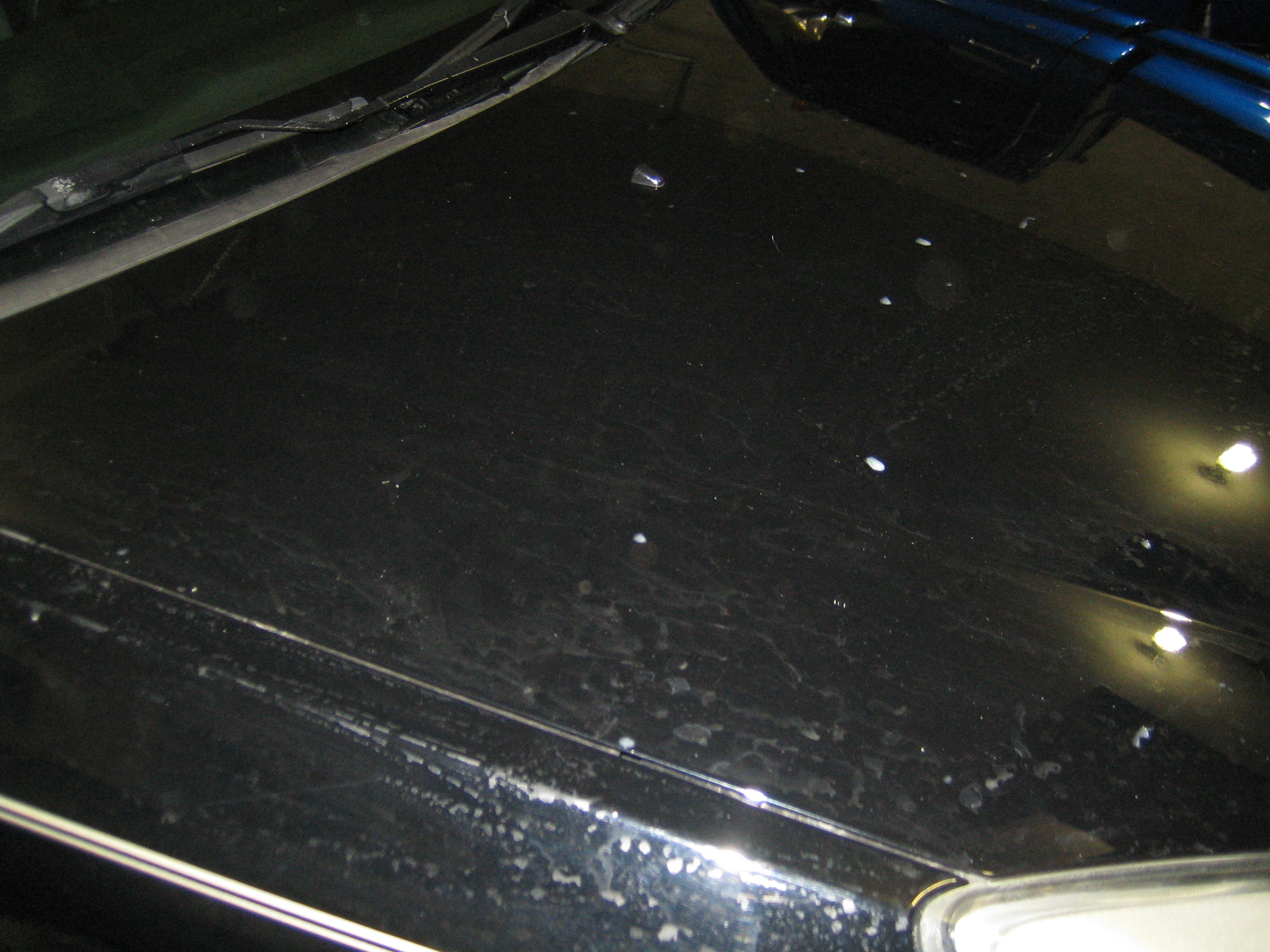

Bought the car during the winter and have been improving on it since. The detail shop did a horrible job of buffing the car leaving scratches, rotary buffing marks, no wax, and a previous dealer tag.
The paint was pretty bad, water spots and all.

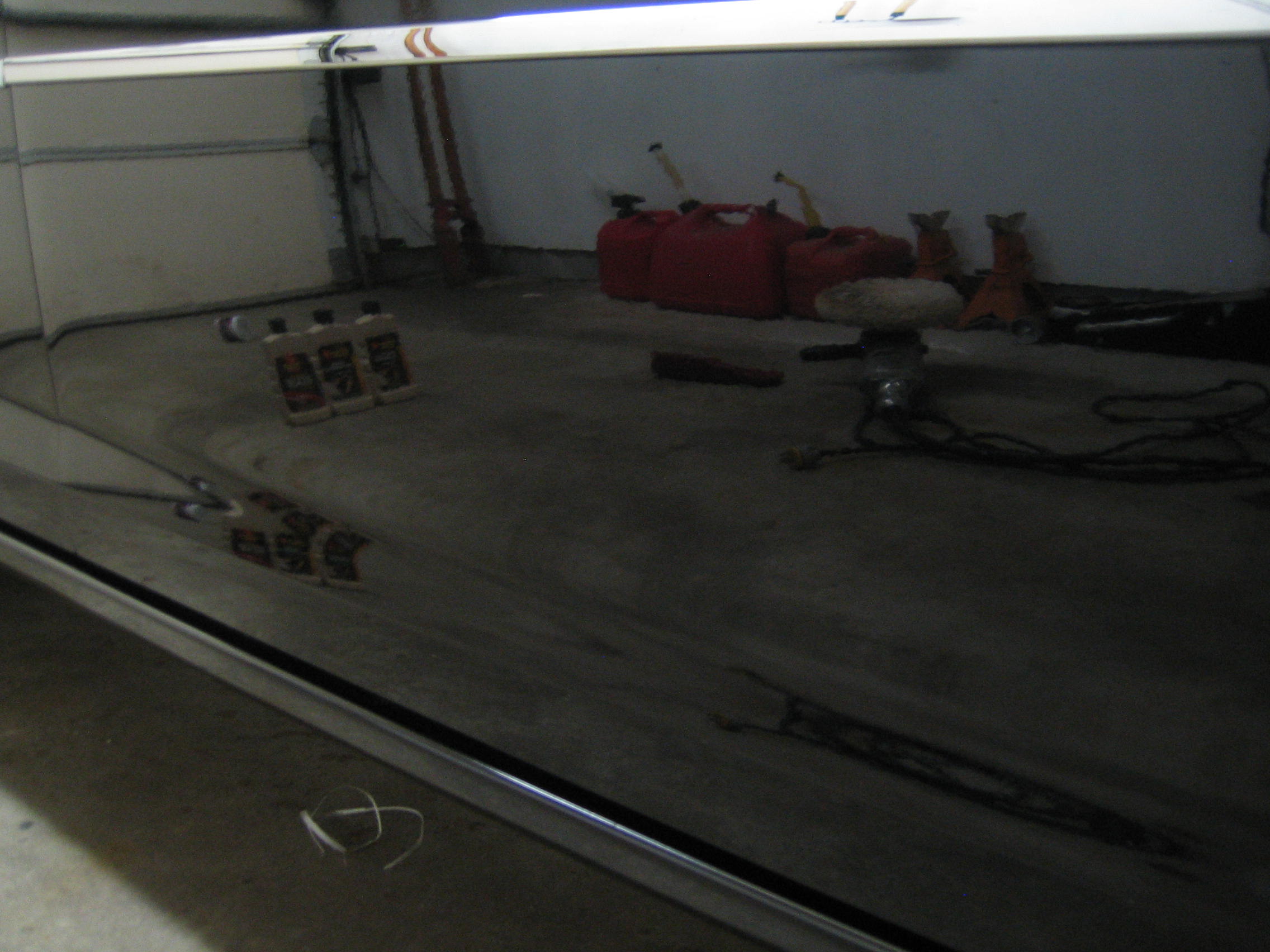

rotary buff with wool pad and fine cut cleaner done to get out the deep stuff then yellow pad on a DA and fine cut cleaner.

how it started
how it started

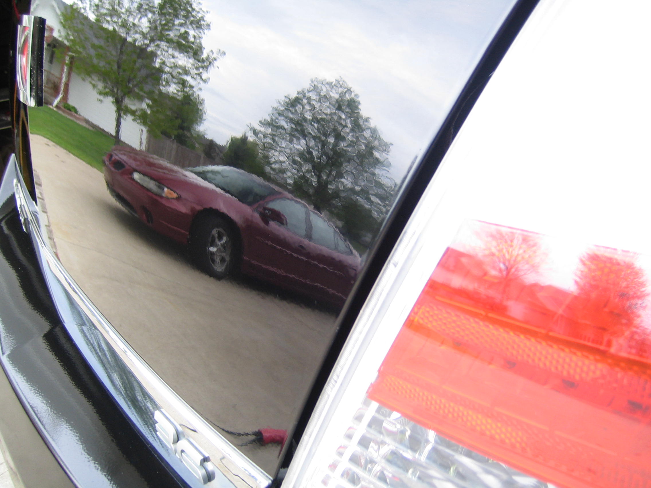

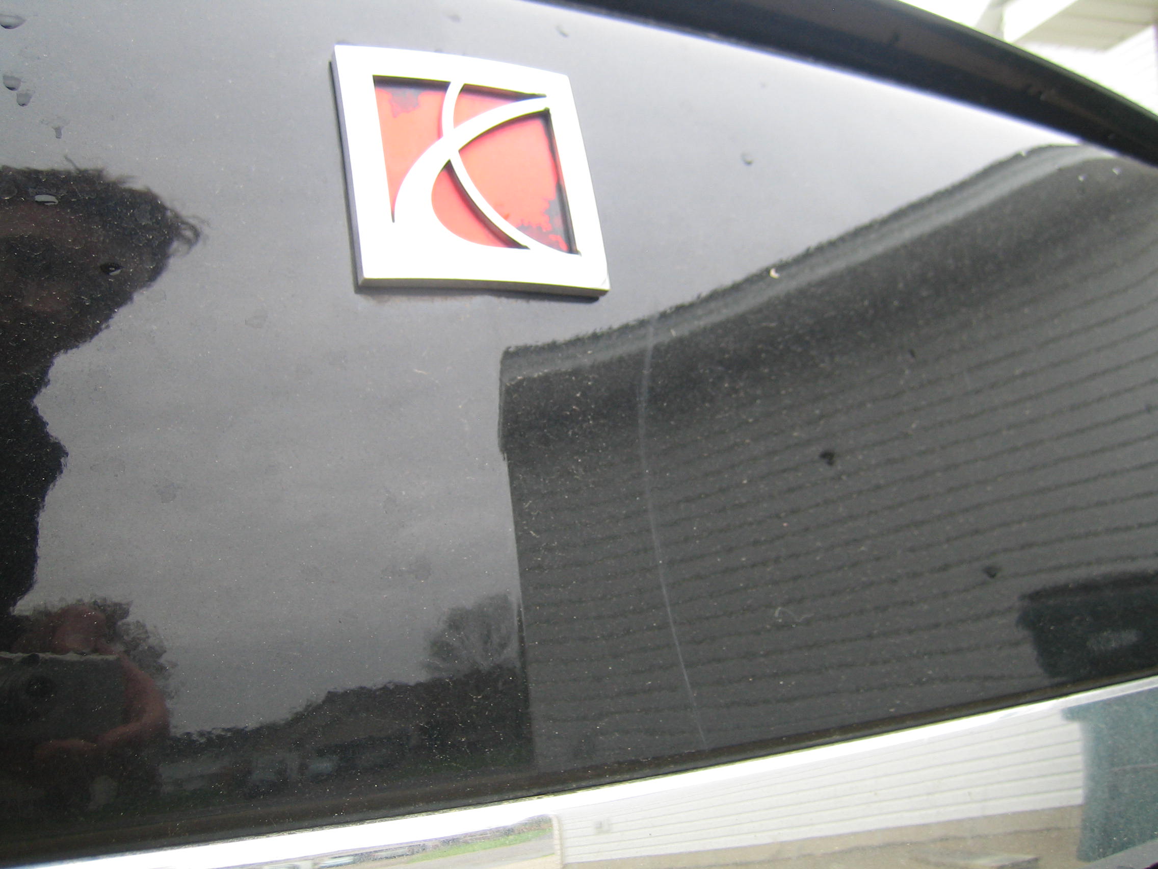

more pics.
another done.
another done.
another done, showing the products.
Done with yellow wax on black pad on DA

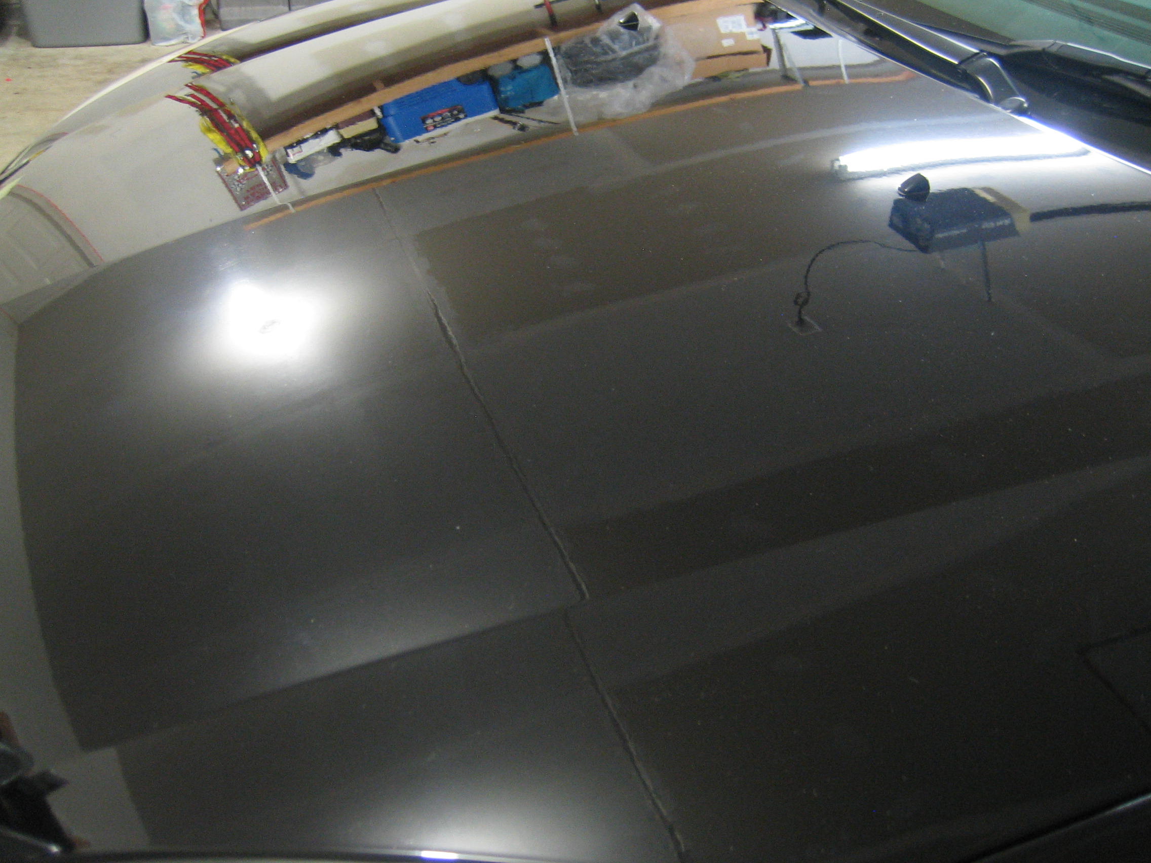

White Pad on DA with show car glaze on top half, same as pic 4 on bottom half.
