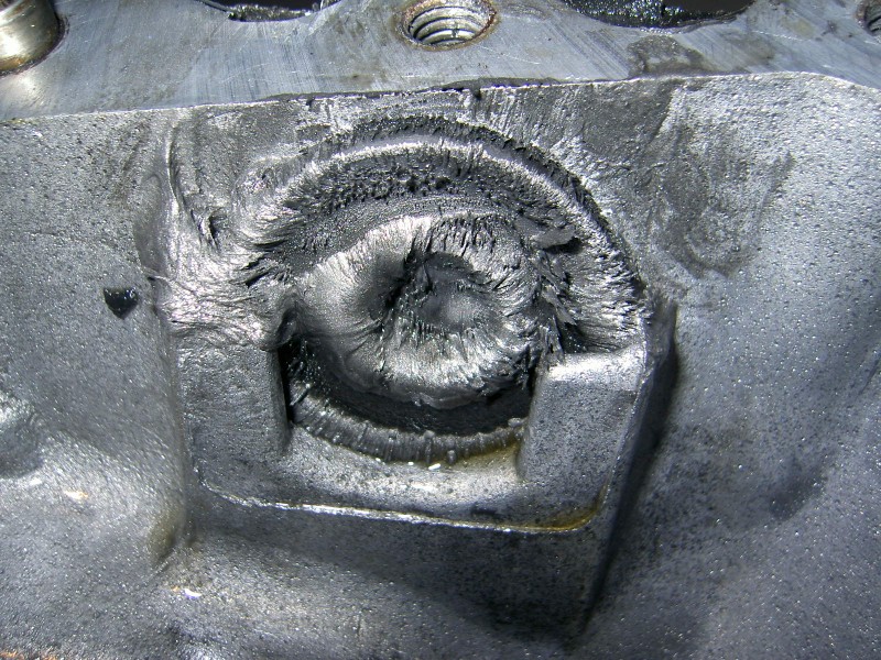

Along with replacing your diff... There are no clutches between the spider gears and the diff carrier they are using only the STEEL plate shims that are there stock and putting force against them... you will destroy the entire unit when it begins to wear those areas.
I disagree with the statement of there are not a lot of differences. Because yes they are all of the same "theory" but they are all designed differently and will wear parts differently. I JUST replaced my spider gears last year for the first time since I've owned the unit and it probably had 40k on it of daily driving. All of the differential carriers I used though are still 100% intact and re-usable. when a PG or TG unit wears out the shims your carrier will be toast.
Here are pictures of what happens to a PG... Others have posted carrier damage photos as well.

Do you have photo's of a worn EP'ed LSD in a manual transmission?
I know the Team Green has puts a huge load on the spider gears and when it does eventually slip it will do this.
I question which actually has a greater limited slip. Does the clutch material actually hold better or provide less friction and less wear.
I went with the Team Green on my W41 trans because the parts were available and i didn't have to ship the differential and wait for Jeff to install.
You replaced the LSD @40k miles. How many miles did it last before you noticed an increase of slippage?
