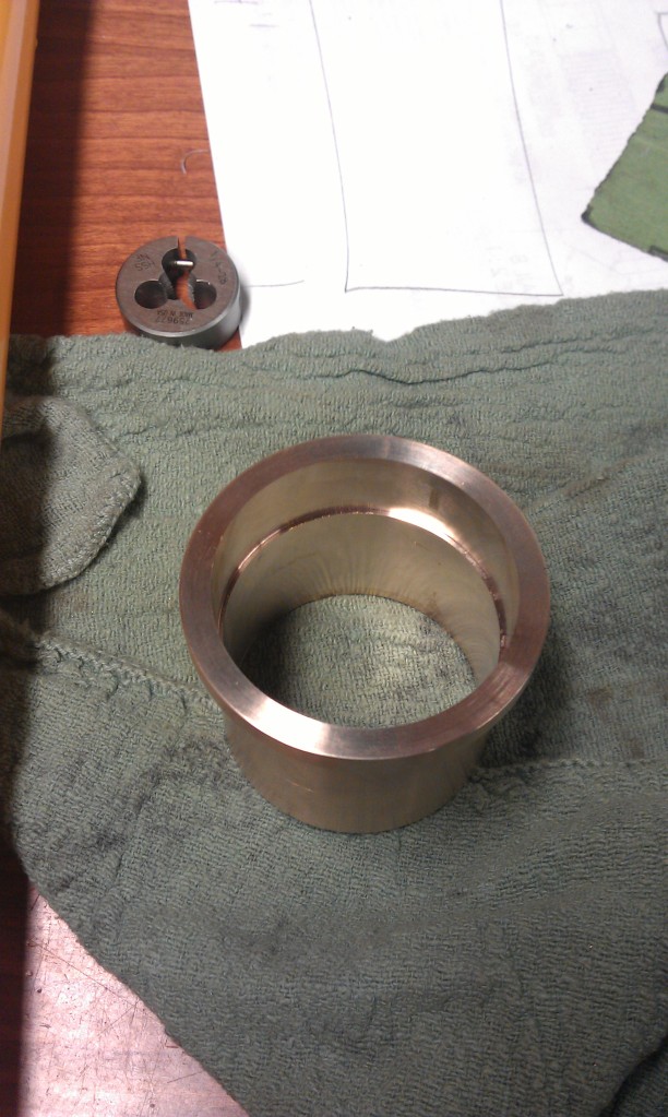

Bushings I'm having made to take up the extra space since these are meant for the smaller J-body strut... Much better than using exhaust tubing as some have.
For those who don't know, there are three points on the tube of the strut at the top that are used to center it (I'll get pics of it)... that's why there is a large gap between the tube and the bushing in that last photo.

I'm not the first to do this, Steph and Cack documented it done on their gtz but I don't know where those parts/car ended up. I'm just the first to have these bushings machined like this.
