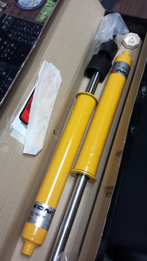

Found a new shock for the rear for 95+ cars... Verifying some info on the bottom eyelet but the only change between the saab and the new one is the bottom mount is a 14mm collar. You can either bush it to match the 10mm that comes with some Monroe brackets, or drill out the lower brackets to be 14mm and get a bolt.
The Gabriel shocks I bought to get the brackets from ended up having a 12.5mm bolt instead of the typical 10mm, so I have to braze a washer on it for the meantime if I wish to use the saab shocks this weekend. I will probably order these to replace what I have. 19.2" uncompressed and 11.85" compressed they go shorter than a stock Beretta shock so that's really good!
*Update
Lower bushing is 41mm wide vs 36mm so you will have to customize the bracket width to fit
This is the bracket I got with some $9 Gabriel shocks. Needs to be widened to fit the Koni... I will verify this is even possible tonight.
*Update

I know this wont help... But the ride actually isn't that bad... especially since they are adjustable rebound, not compression.
But Just remember this... You can go KYB and be done, OR you can go this setup and open up the world to a perfect suspension setup... The awesome thing about Koni shocks is you can take them and send them to a shop with all of your spring specs, your sprung weight and everything you want to do with your vehicle as well as the rest of your mods and they will re-valve these things to better suite your application. The possibilities are endless when you have people willing to custom tweak them.
And to update this thread if anyone cares.... Since the Bilstein shocks I bought a while back just haven't moved yet I'm at a standstill regarding buying ANOTHER set of rear shocks for the 96... So that will have to wait a while till I recover.

I could do that sure, and as far as donors go, I wouldn't get cheap stuff with what was posted on here about the strut housing breaking off the knuckle mount on a set... I used old KYB's that I had lying around from my old car. Really just anything you trust.
I can have the bushings made up out of steel rather than bronze and then I will tig them into the tube so they stay in place. I really don't think it was necessary to use bronze on my setup. The guy who did them I believe thought there would be more movement than there is with this setup and that's why he recommended a material that is self lubricating and what not.
