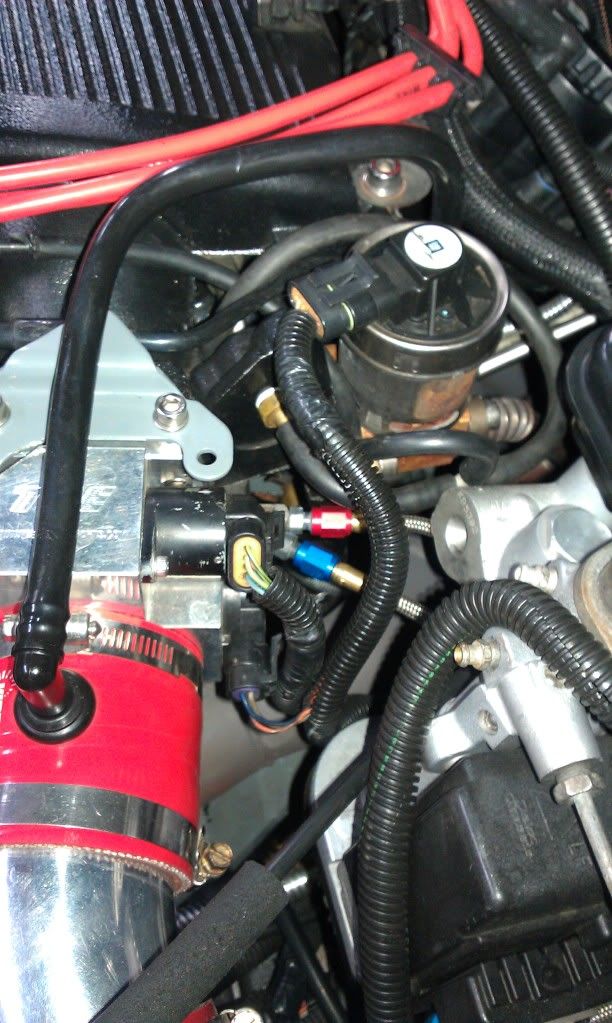

That's the same linkage as mine.
The wire you have routed wrong... It would not reach the stock TB with the way you have it routed because the sensor is in the same spot as the TCE... Location of that plug does not change.

It was going around the brake lines, but I tried another way to get it closer. It was way too tight and still is. Next weekend I'll sodder the extra pig tail that I have on.

My iac tps and egr wire come in on the same Loom if my stock tps was anywhere near where your wire is it wouldn't even fit my stock harness. Unfortunately I don't have the 95 as OBDI.5 anymore so I can't compare that to yours to see where it came in.
Just go look at a stock TB and tell me that your wire would even reach.

It did fit the stock TB and the 3400. Nothing changed, but it's too short. My harness was routed around the brake lines with the IAC,TPS and the EGR.

LOL the 5v wire snapped off. There has to be a spice, I already crimped(also sodered) the wire back on and it will pull out the connecter if I plug it in. I didn't cut more than 1/8 of an inch off the wire. Just enough to get rid of the fray. It was very bad so with the old crimp, the fray(with broken strands) and the 1/8 inch I'd say it was a loss of one inch.
I tried the stock route first and then went with the one you saw as more of a direct route. That added pig tail makes things look worse than it really is.
A splice is the only way I can do it.

No its not. The harness is not in the right location. It needs to be fixed. It had to work sometime before you started working on it since you even said that wire; where it is now wouldn't have reached a stock TB. You moved something sometime and i don't know what you've done to this car yourself so i can't pinpoint when it happened.

The linkage looks right to me. That is weird the wiring wouldn't reach though. Even with the 3x00 in my mpfi car the wiring harness was fine.

Can you remove that CAI tube and then retake those pictures for us? That might help us out more with your situation.

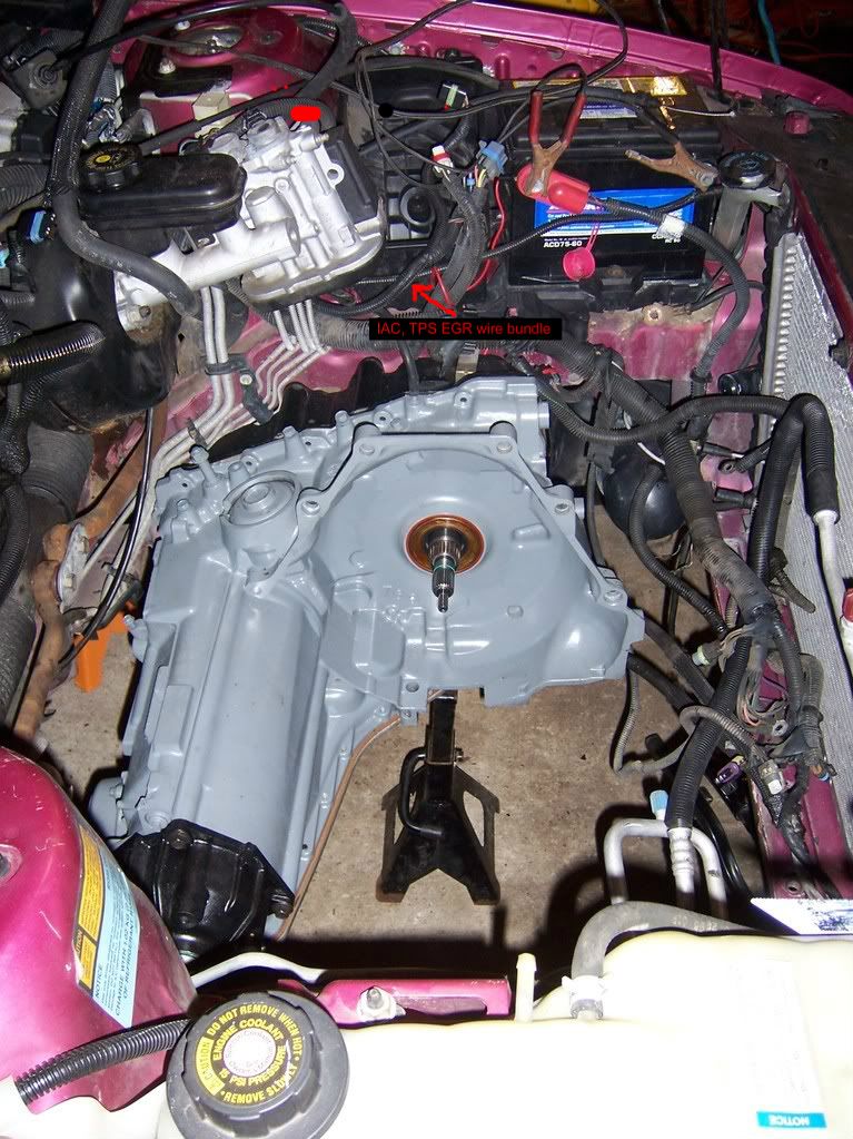

What?Money pit Beretta wrote:I have only one idea, the upper mount. The bolt in the back near the coolant tank is all the way at the back(as far way from the front end of the car as possible). This may have added length. My guess is that the bolt needs to be in the center.
Your motor position has NOTHING to do with this... I will say it one last time. Your wiring harness is not routed correctly.
Correct upper mount position if your wondering.
Location of the wire bundle that should be going to your TB.
