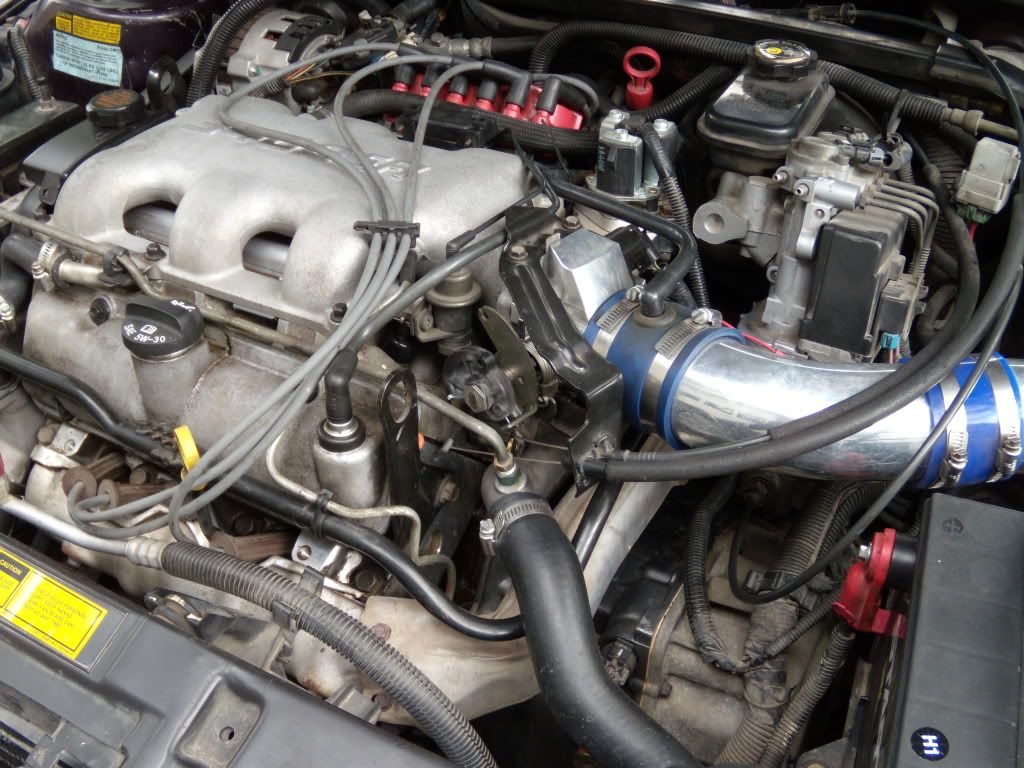

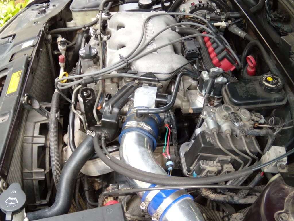

It seems that the TPS harness is too short. Had to grind the throttle bracket on the lower stud. The cruise control cable is too short. Not sure, but I think the throttle bracket needs to move over more. The cable is touching the side at first part of the "lobe".

You need to post a picture of how you have this installed... When done properly it fits without a problem, but if its a 3x00 top end or engine swap setup in an old 3.1L car then yes there may be some other cable/wiring issues you need to resolve since your now expecting the 3.1 stuff to reach where the 3x00 TB is.
Re: Strange TCE TB woes
Yes it's a top end swap. The stock 3400 TB had no trouble. Really I'm not bitching, just think that there should have been a heads up. I guess lucky for me the 5v wire for the TPS was in bad shape anyway and let loose. I do have a back up harness that I need to put on. That will give me extra length.

There doesn't need to be a "heads up" mine fits with no issues... Once again you should post a pic to see what you have going on. And I meant a top end swap on a 3.1L not 3100... since the 3.1 the wires and cables are different than the 3100.

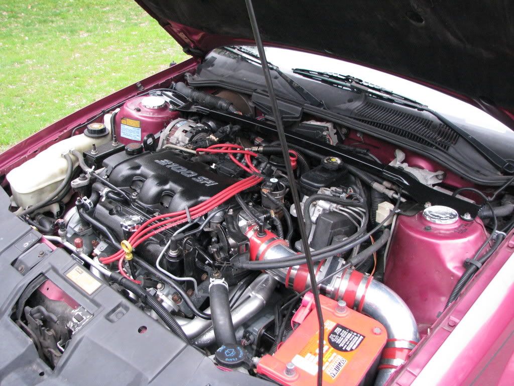

Yeah a pic would help the most.
You can see here that with the 3100 upper my cables were fine with my TCE.
Even with the 3500 upper it all fits fine.
You can see my rigged TPS wiring that got me to work and back. Didn't have time to clean the valve covers.

That is not a tce issue the damn wire wouldn't even reach a stock TB... You have something routed way wrong. Also the length of the cruise cable can be adjusted at the cruise box. That is if the cable is too short which once again tce changes nothing in that area.
Ok, but the it did reach the stock and the 3400 TB. It was rerouted to try and get it closer.
Thanks for the tip on the cable, I'll try to adjust it.

I'm wondering if the linkage is your problem... it looks different than Jon's (and mine for that matter).
I put my 3100 linkage in the TCE.
