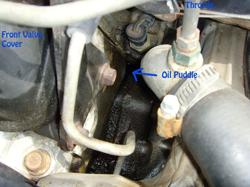

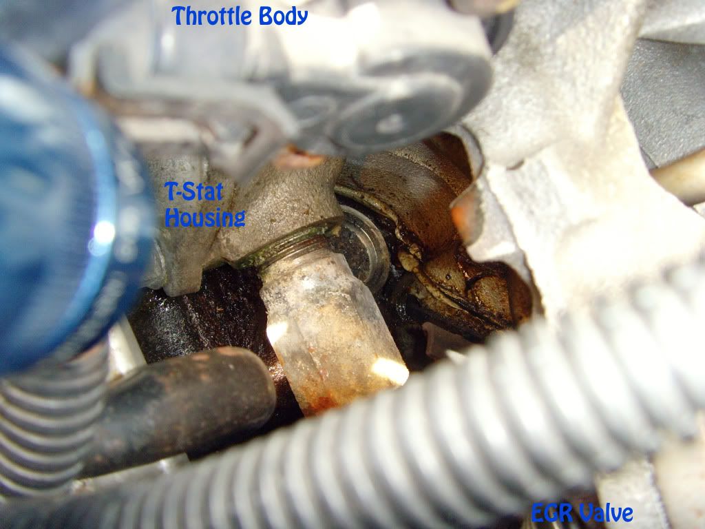

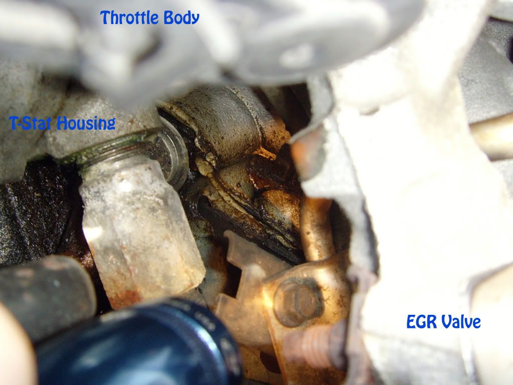

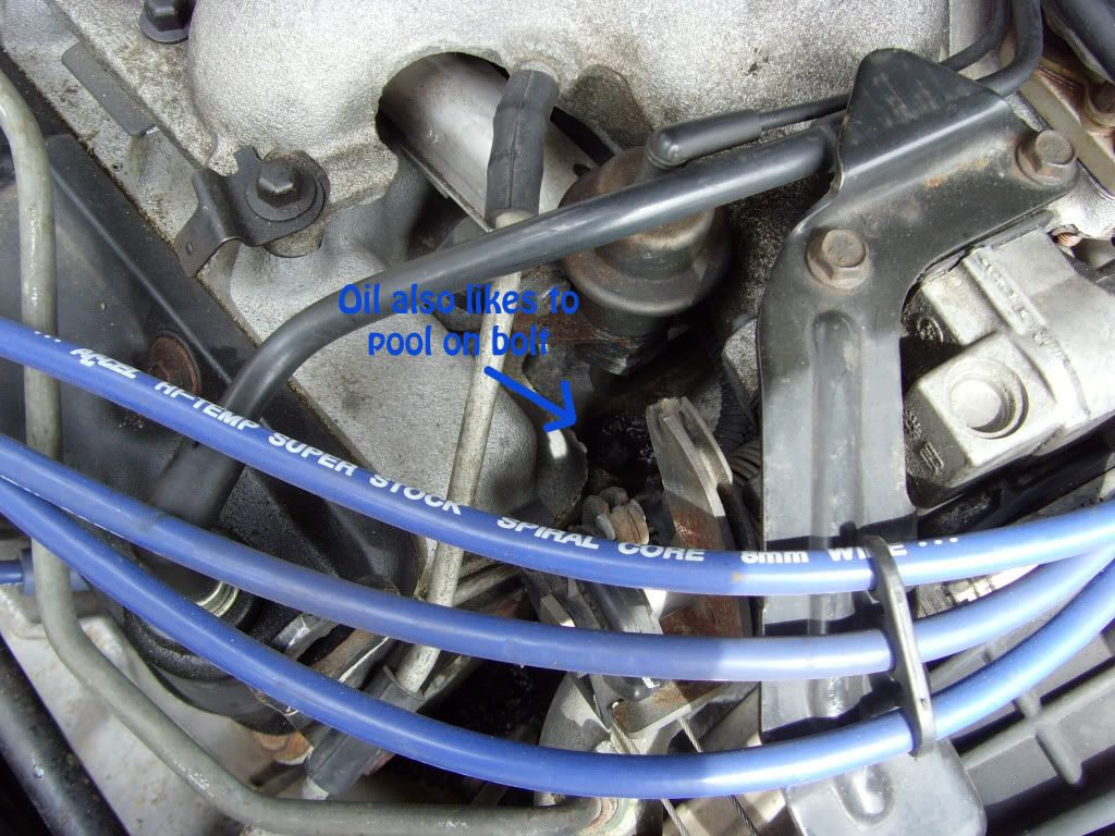

So after somewhere close to 150mi driven yesterday, I was down roughly 1/2qt. before we left I filled it to the top of the hatchmarks, and when I just went out to check before going anywhere today, I'm about halfway down the hatchmarks.
Pics are below. I labeled them so you could get an idea of where you're looking. The first two pics are right about where the LIMG's meet (driver side of course).

definately the oil drive o-ring... that silver cap is just gushing oil out.
There is a oil galley that flows right around that part and if the o-ring is not in good condition which 99% of all factory ones are defintely shot by now... they will just leak up and go everywhere looking like a bad LIMG but its just that part.
Pop it out and put a new brown colored one in if you can find that type... GM ones that were better are brown... the Felpro cheap ones are black.
The little seepage on the bolt for the LIM well that could be coolant... I would double check by cleaning that all off and then seeing what comes back after the o-ring is replaced.
