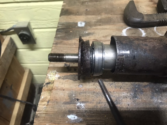

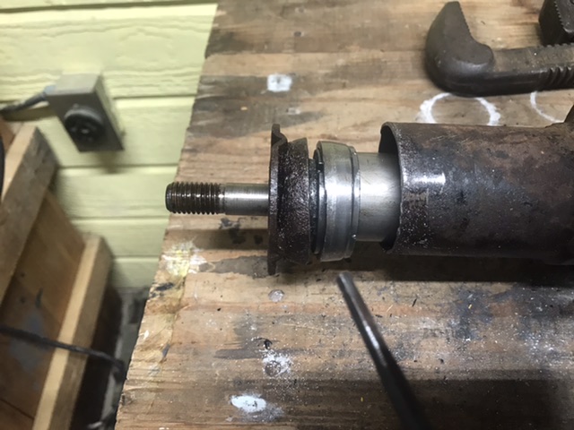

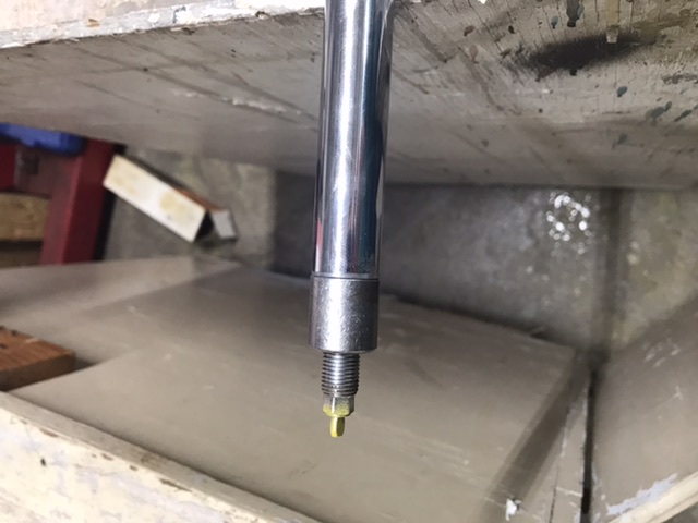

Alright I’m back. SHOCKS ARE DONE and here is how you do it everybody!
How to put koni wrx shocks in 1988 style Beretta
This includes Indy models so you guys get on this!
We don’t need any external/additional parts!
Here is how to put in a currently-produced WRX KONI into an old-style top strut steering bearing strut (‘87-‘94?). The Mitsubishi Eclipse Konis are gone. Ebay and 4 stores claiming stock had nothing. Tire rack wins (for Saab rears too) for price and I paid $211each. It’s easy and simple, so buy some for your car! I don’t have any new style bearing plates so someone will tell us the year upper limit I’m sure. Okay here goes.
If you have inserted original beretta (8641-1239sport) shocks into housings before, it goes pretty much like that, exactly like that if using a Gabriel shock housing. I did two here, one Gabriel and one ACDelco. The Delco requires a trick and both are similar where attaching to the top steering bearing. These pictures are an original AC Delco housing.

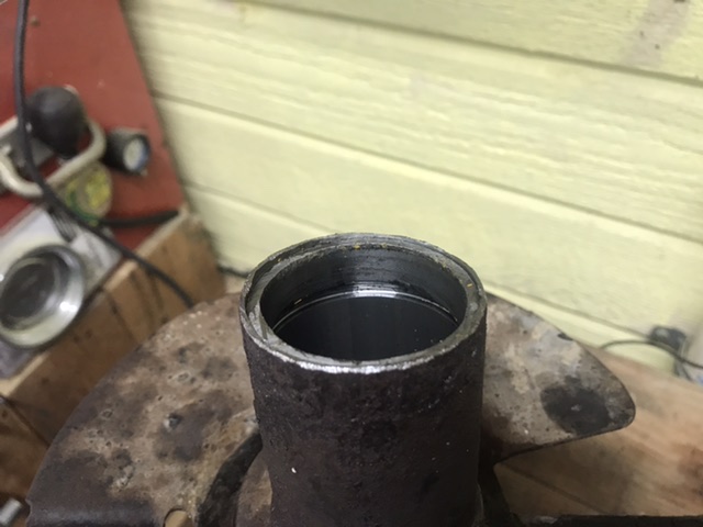

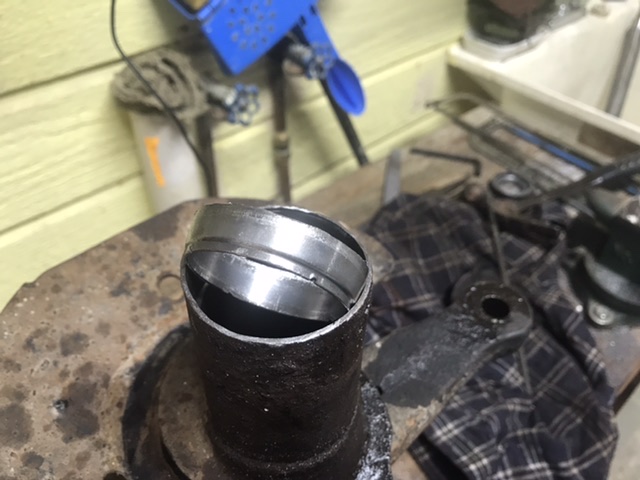

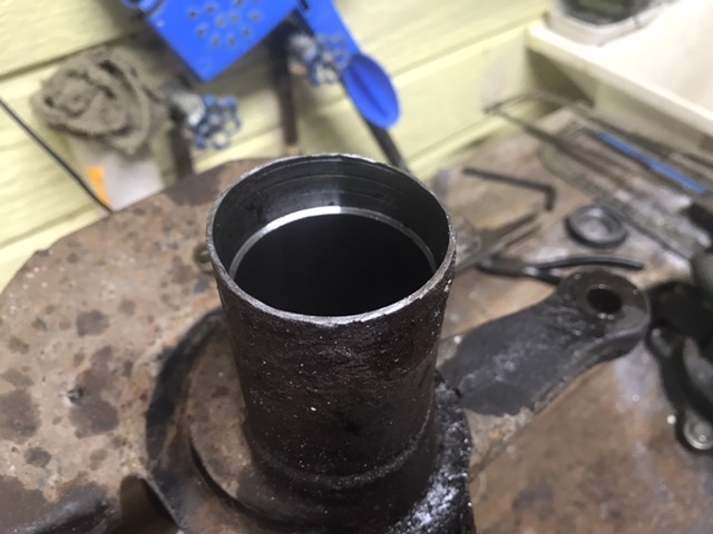

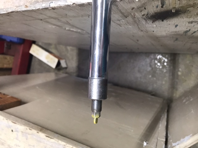

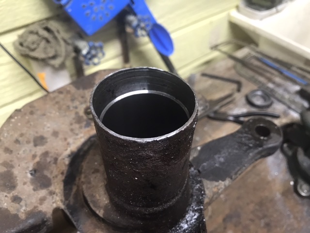

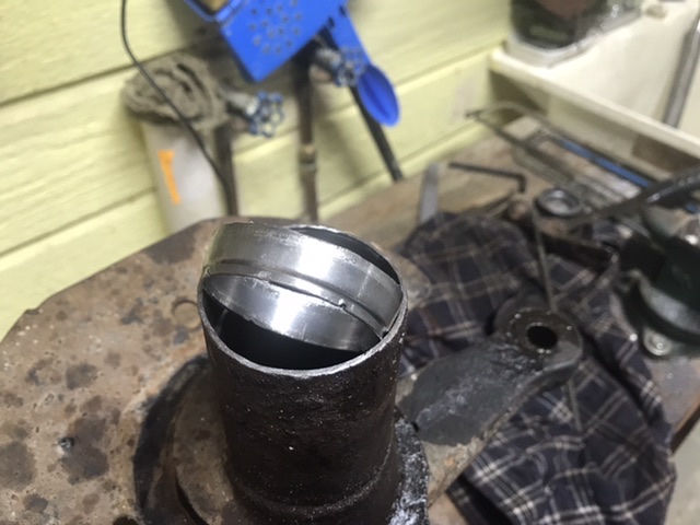

Prepare the beretta shock housing by cutting the top off to remove the innards. Now KONI wants you to cut a certain amount down the tube which exposes an inch or more of their shock... I did not go this low. I just made sure that the housing tube does not touch the KONI. If I cut too low on the Gabriel, I would need a bushing. By going down a half inch (2nd cut made after the innards removed) the “bushing” is already formed into the housing and I was able to use that (on the Gabriel).
To be cautious, because we don’t know for certain what’s inside the tube, cut near the top (as opposed to almost 2” below the top like koni instructs). Cutting too much toward the top and we can’t extract the guts, too low and we may have to cut the bushing separately in the vise (your choice really). We intend to use the inside as a clamp on the bushing should we need it. We don’t know if we need it yet and are preparing. Be aware that we may need a bushing here so the koni doesn’t flop around atop the tube after mounting. That’s why we are doing this.
You can see what I did here. The right ring/bushing is what I’m using cut from the left two pieces. Discard the left two. This right bushing exactly matches the koni and of course the tube that it just sat in. It will hold into place by setting into the tube and lightly hammering the top of the shock tube over the bearing enough to hold it in place.
Here it is done. Before bushing, going in, and then bushing installed.
Note: I did not use the supplied bushing because it didn’t fit as well as this does. If your shock tube varies more than mine here, you may work with it.

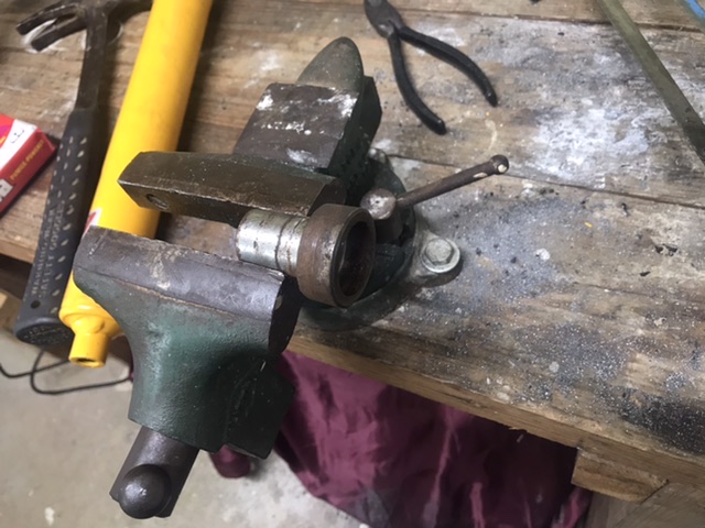

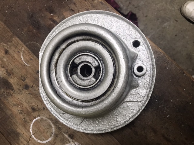

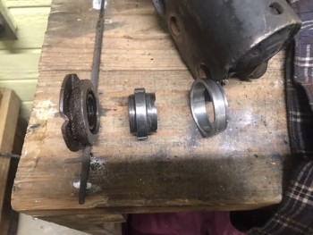

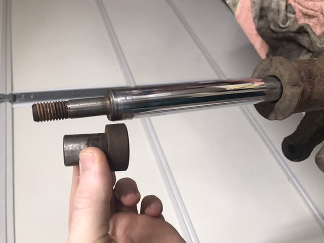

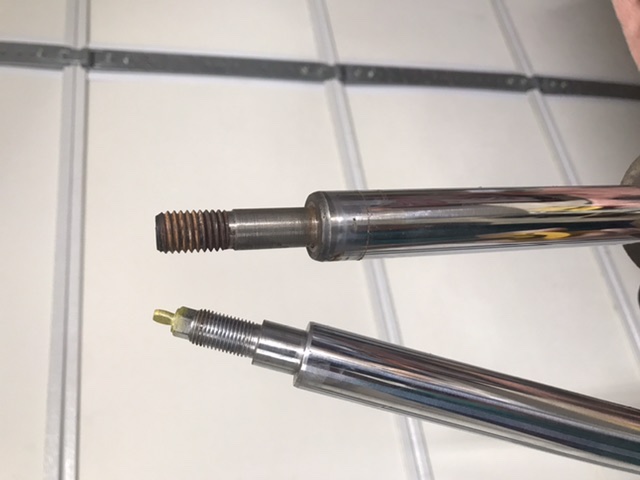

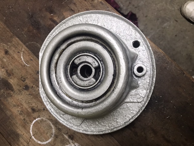

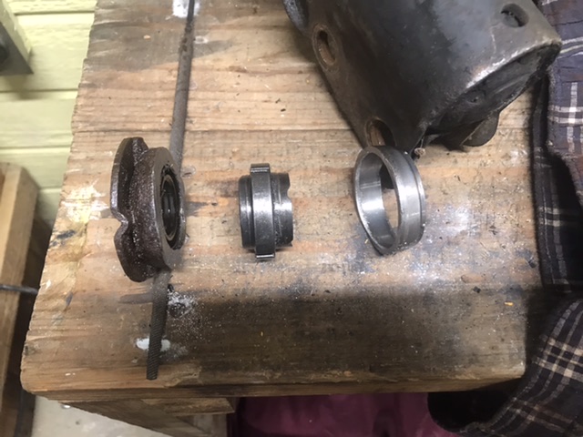

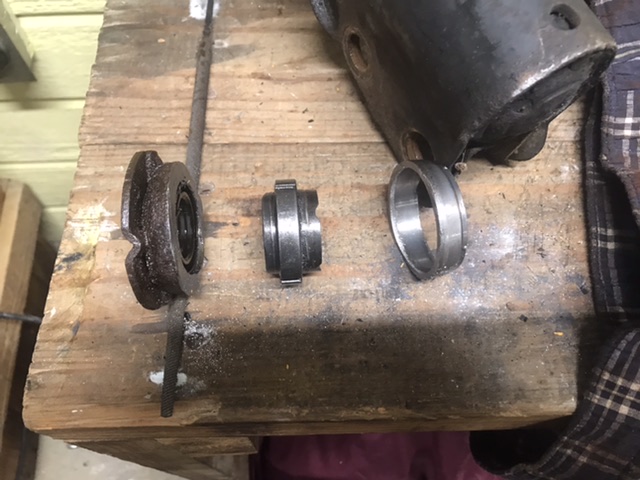

Now for the eureka moment on making these fit to the old style top strut steering bearings!
Pull the skirted bushing from the bearing plate. Channel locks work well.

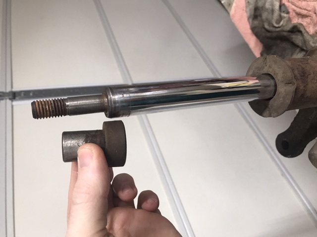

Since the koni’s shoulder is in the way no matter how we look at it, it’s easier to use the old bushing except we need to make it fit better. To get proper height (defined as 3 threads past a tightened nut) take the old bushing out of the steering bearing unit and cut the skirt off. Mine measures 0.64” and covers threads by some so the bushings seats against the bearing plate.
Next, the koni shoulder is 0.584”
The busing is almost there at (forgot)... 0.560”?
I didn’t have a bit on hand so I just hand filed it to wider.
Now it fits on the koni!
Now rather than leave it on the shock, remove it and push it as far up to seat (below picture it’s not pushed in all the way) in the top bearing unit where it was so we don’t use the nut to draw it snug (difficult and so we don’t have to grip the shock piston risking damaging it when torquing the top nut).
I did not drill out the bearing plate. Let the koni shoulder hit the mount as it should, or if your spacer is tall, it may not touch.

The part number 8641 1239sport we are looking at here was only produced from 1992-2002. During the decade of its production, only 3 of those years did KONI North America sell more than 50 car sets. For the last 7 years of production sales averaged just under 20 car sets a year.
As you can see, these wrx Konis fit my car like the original. I only used a hacksaw and hammer (to hold a top bushing in strut tube, used to fold housing metal over as a retainer) beyond what’s normally needed. Not having a beretta p/n is a non issue. Now go get em!
Andy

There is metal not too far behind that rubber though. I was hoping I could just use a woodworking forstener bit to cut it down to an acceptable level but of course when I started digging at it with a chisel there was metal about a quarter inch down. That's why I had to go at it with a die grinder. If I only had a cross section of the mount to see how necessary it was to have that hat skirt on the bottom side of it I might have just done what you did. I was just afraid that the metal at the top didn't go under the main section, but it probably does. I can't wait until summer to tackle this and finally use the Eibachs I've been sitting on for so long.
As of now, the 92 and later struts I'm using aren't letting the knuckle adjust back far enough to get some negative camber- I've got them maxed (or minned?) out as negative as they'll go and it still looks positive to me. Plus the wheel weights from the SCX wheels were hitting the strut housing so I had to bring out the angle grinder. Doesn't make any sense, I compared it to what came off of it and it looked identical as far as the part that mounts to the knuckle. It's looking like I'm gonna have to elongate the holes a little more before taking it to get an alignment. I'd hate to take it somewhere only to be told that they can't make it any more negative and it's like 1 degree positive.
Edit: went back today and loosened the strut to knuckle bolts more to see if they were maxed out on the slots, they weren't. I just thought I had em maxed out to negative and didn't. Now I have no reservations using these as suitable housings for these inserts once I get through the winter.
