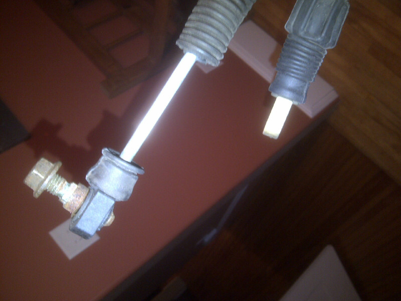

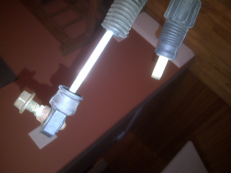

those cables pictured look a lot like the isuzu cables from a 2.2 beretta
Re: Repair kit for GM Getrag FWD shifter cables
Here was an old picture I took of mine, the bolt that connects this to the tranny of the isuzu i think is what this kit is replacing

themixer wrote:those cables pictured look a lot like the isuzu cables from a 2.2 beretta
92-94 Getrags have this style end on the cables too... ;) This kit replaces the bolt and the bushing for the getrags, not sure if the same bolt would work on the Isuzu ones or not.
